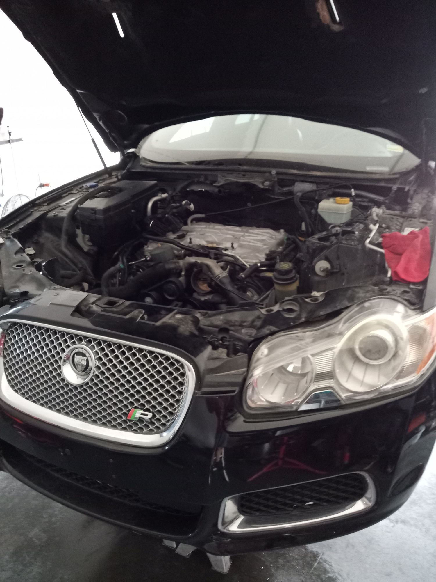

2014 XFR here, I have a 60k miles car, doing plugs and waterworks while I have the SC off for snout renewal. I've moved the coolant tank and have adequate access on the driver's side, no concerns there.
But the passenger side looks...Well, there's *far* less room in this engine bay than in a C4 Corvette, and that's saying something. Of course that silly musical instrument [symposer] took up half a cubic foot by itself...
Of course I've removed the stubborn rubber cover.
Q: Is it necessary (or recommended) to remove the shield around the fuse box to get the coils off and plugs exchanged?
When I bought the car there were 4 new plugs, new-in-box, in the glovebox. Now I think I know why. I figure the prior owner started this job, got the driver's side done, and said, "FTS, I'm selling it." LOL

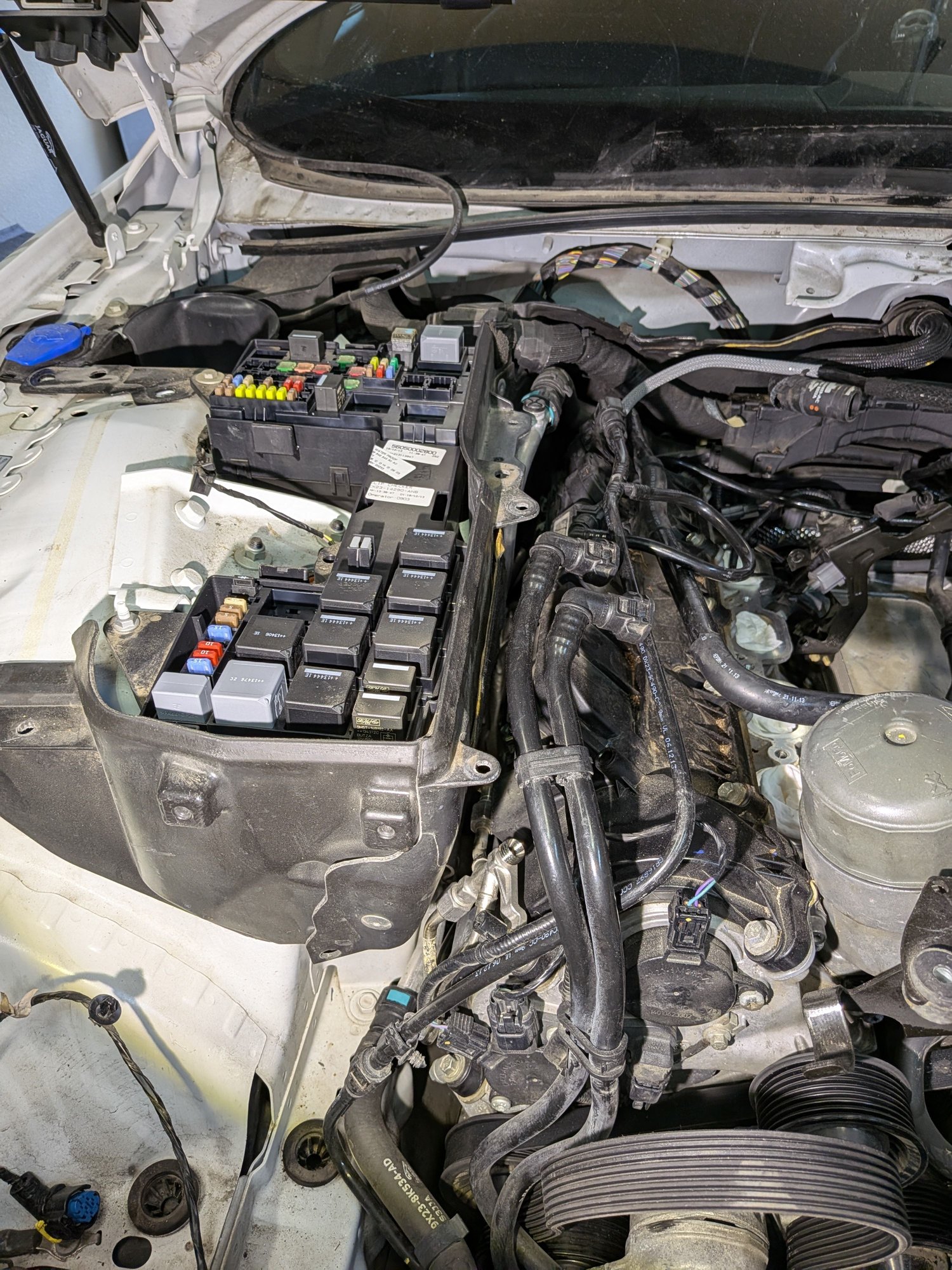

Anyway, for the UK drivers side plugs I am fairly sure you will need to remove the plastic fuse box guard (which is a PITA), you can then unbolt the fuse box and rotate it out the way, Access is tight but not completely horrible... saying that you can do your plugs with the blower on and I believe they are 100k service items so I'm not sure (given the cost for the correct ones) I would bother.

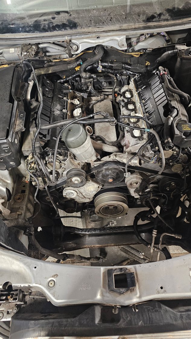

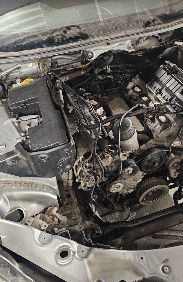

Thank you for the note and pictures! I'm already down to this [below], and I have the plugs, so I think I'm going to just complete it. That cover may be a PITA but it can't be worse than the two Impossible Screws (T30's against the firewall) involved in removing the heater crossover at the back of the motor--just finally got those out tonight, replacing them with hex heads so at least one might get a wrench on them!

Removing the plastic shield was ok for me, replacing it was quite annoying as it has to go round several pipes and magically clip into some other bit of annoying plastic! The fuse box has just enough wiring loom length that you can lift it up and spin it by 90degs.
