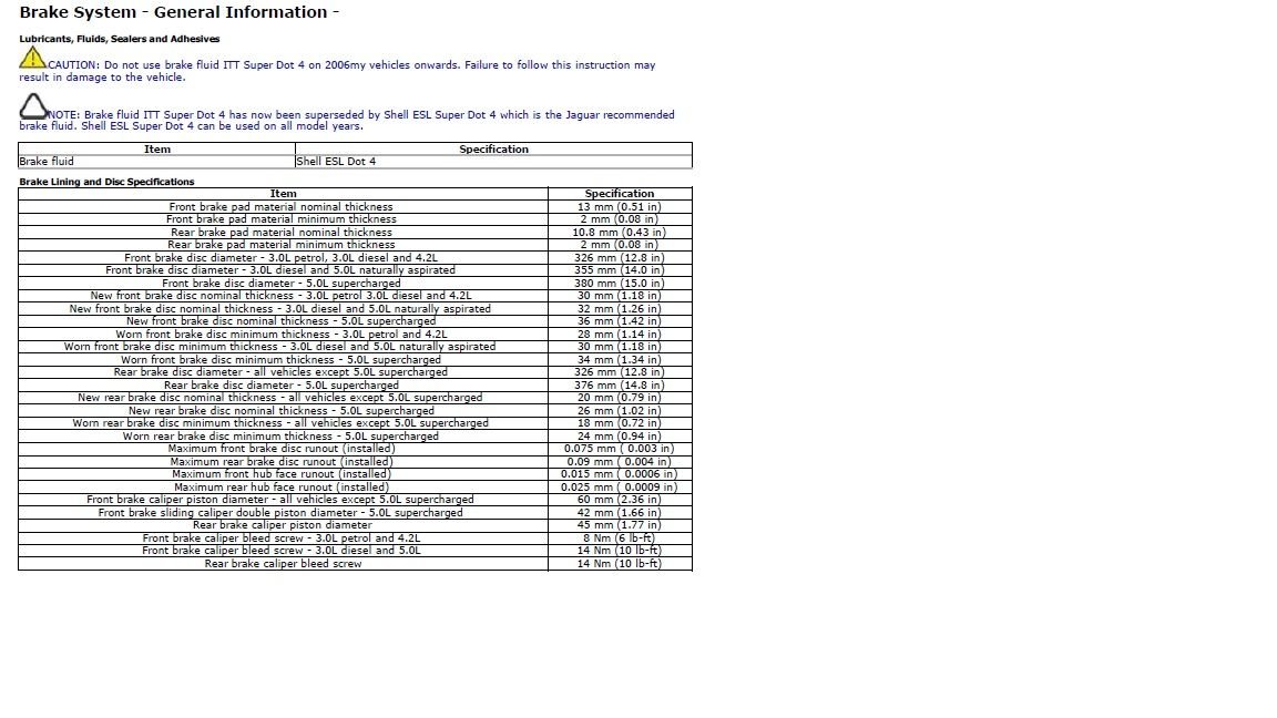

On a 5.0 NA you should have the 355 mm front and 326 mm rear brake rotors.
New and minimum thicknesses per the attached jpg, ie where it says 3.0 diesel and 5.0 NA.
However your front measurements seem very high, way more than even new thickness, I would double check those measurements.
In any event the brake size is shown on the edge of the caliper bracket.
Yes 2 mm wear is the specified maximum but that is ridiculously conservative and pending a measurement check you should be able to get them skimmed no worries.

Seeing as your front rotors are odds on to be the 355 mm ones with a new thickness of 32 mm, yours at 31.7 mm are barely worn at all and definitely do not need to be replaced. You could possibly get away with not skimming them at all but it is a good idea to skim them anyway to have a fresh surface for the new pads to bed to.
