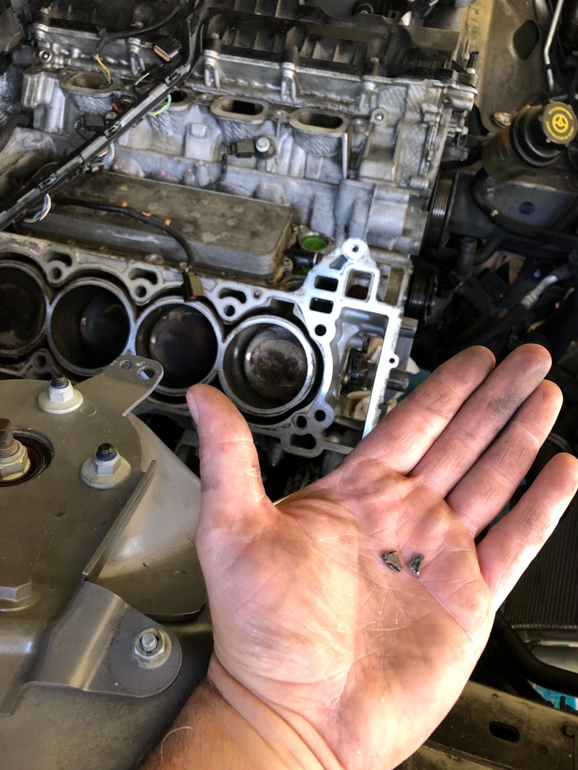

Well I have found the reason for the bent valve. Too crunched up to determine what it was but its not magnetic,, Probably a small washer,,, Much too my dismay all this work is being performed by yours truly in a carport no less as i recently purchased a home and haven't built a proper garage yet. On a good note the head is back and ready for installation,,, Now the part where i ask for advice,, Rewinding the clock, Purchased car used from second hand dealer in late Jan. 2019 ,, in to local jag dealer for oil change just before a 1400 mile drive to orlando disney for vacation,,, arrival in orlando day 1 A/C quits, no big deal head straight to nearest dealer, Jag aston martin in orlando, get loaner and fast foward last day of vaca car is finished new compressor installed,, drive home next morning,, arrive home 3 days later this whole mess ensues,, Next course of action?

This is all very confusing for me. Where did you find that debris? In the catalytic converter?
if you don’t know where it came from, how do you know there isn’t more debris in the other side of the engine? I would want to positively identify the source before calling this job done.
Most metal washers are magnetic, so that doesn’t make sense that it’s a washer.
Are you suggesting the people that fixed the AC are to blame for the debris? They most likely had to take off the air boxes to do that work.

Those 2 pieces of metal came out of the converter. Retracing the facts leads me back to the dealer who repaired the A/C. Now im considering the likelihood of those responsible righting the wrong.
