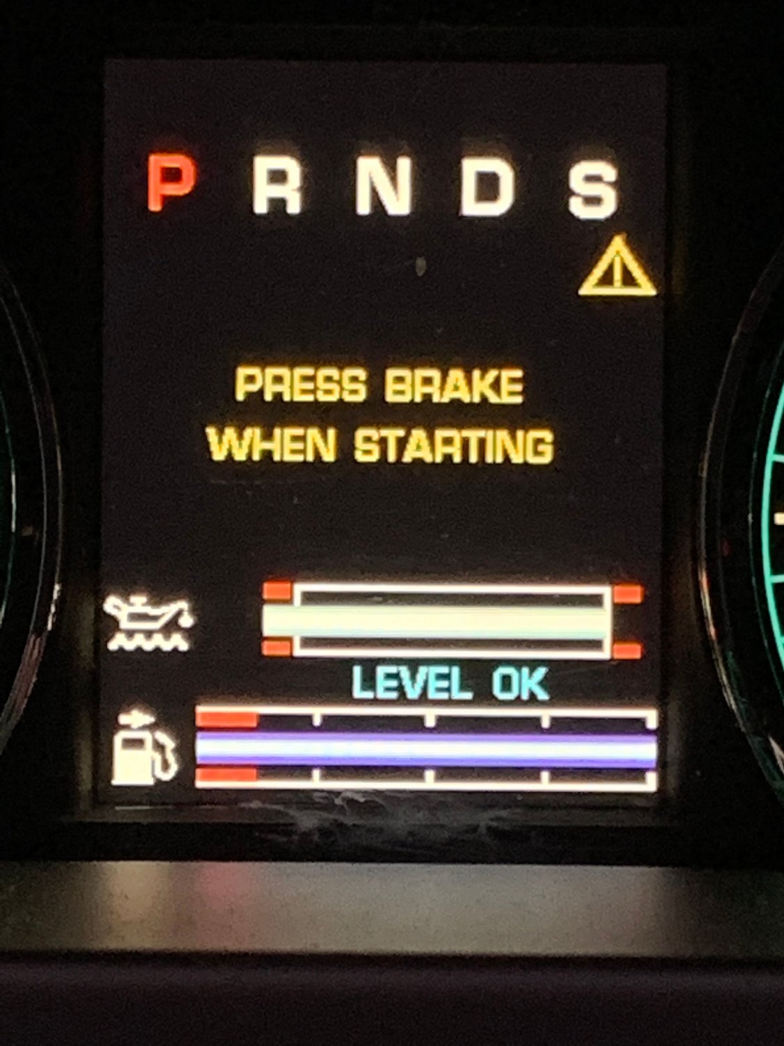

This thread isn’t about oil pressure but thanks for the comments. Somone just asked about why I had my engine replaced. To dig further into oil pressure issues please raise another thread.
Finally I managed to sit in my car for 10 min (I set a timer) and then accessories mode and cycled through the screen to get the oil levels. Was happy to see it show up.
Oil “Level OK” indication with full reading. Or should it be to the red bars on the right?
Any suggestions on what I should do next? I feel like I smell burning oil when I walk around the car immediately after start up. I don’t manage to catch any blue smoke when I walk to the back, I see nothing and then a few seconds later I see the exhaust white smoke come out. I’m looking into getting a used 335i GT M sport package but I don’t know I really love this car especially the v8 which is getting extinct in sedans.

Is the burning smell caused by a leak from one of the cam cover gaskets allowing oil onto the exhaust manifold? Or is the smell from the exhaust itself at the back of the vehicle?
It is possible that the piston rings are clogged with carbon buildup and may be causing poor oil control in some cylinders, thus the oil consumption. What was the condition of the oil removed from the engine during the last oil change? Was there any fuel present in the oil?

Do you check the oil level? Why did the mechanic find this and how low was it? Actual numbers?
Hopefully no engine damage and yes do stay on top of it. These engines are not known oil burners but any engine can consume oil too.
