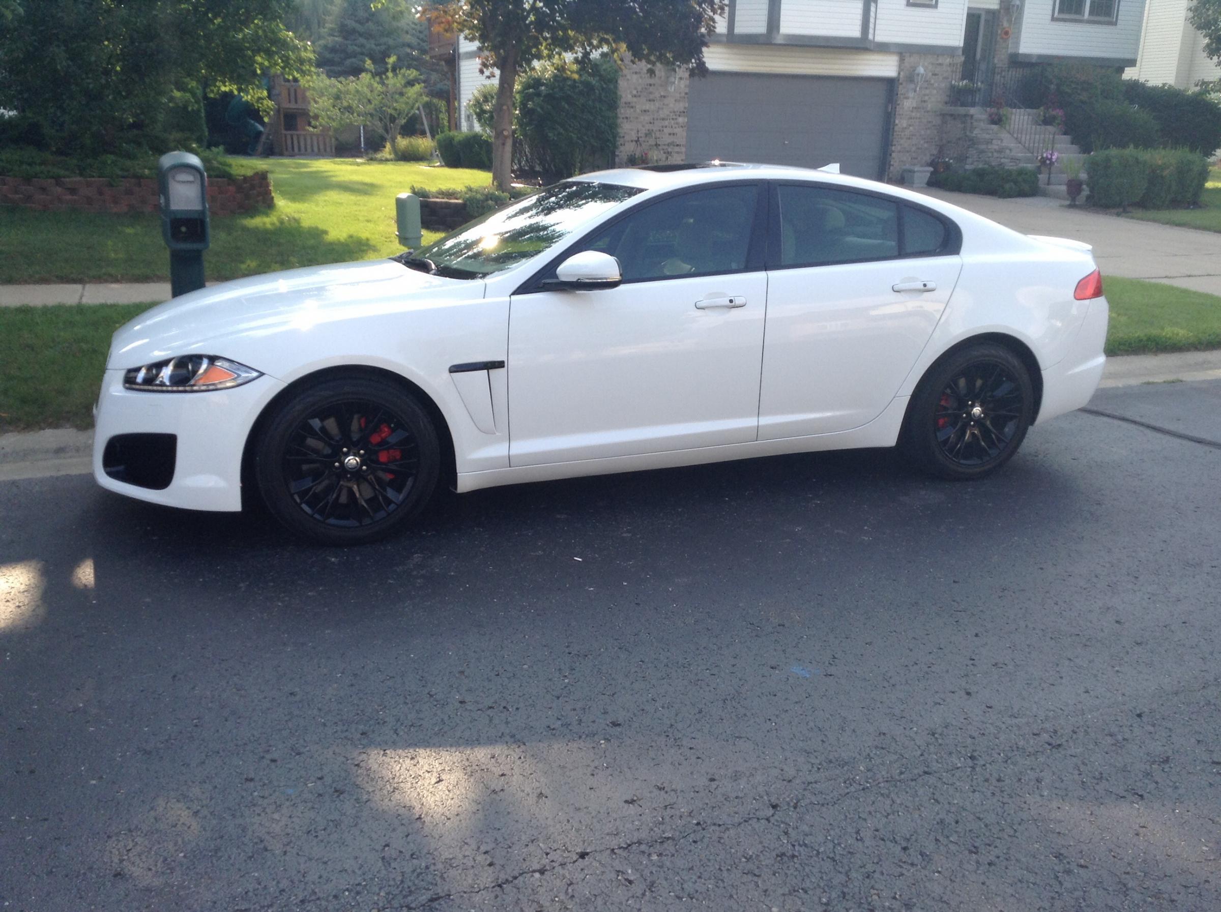

I've also added a pic of the car...love it! Hoping to get this issue resolved ASAP.
