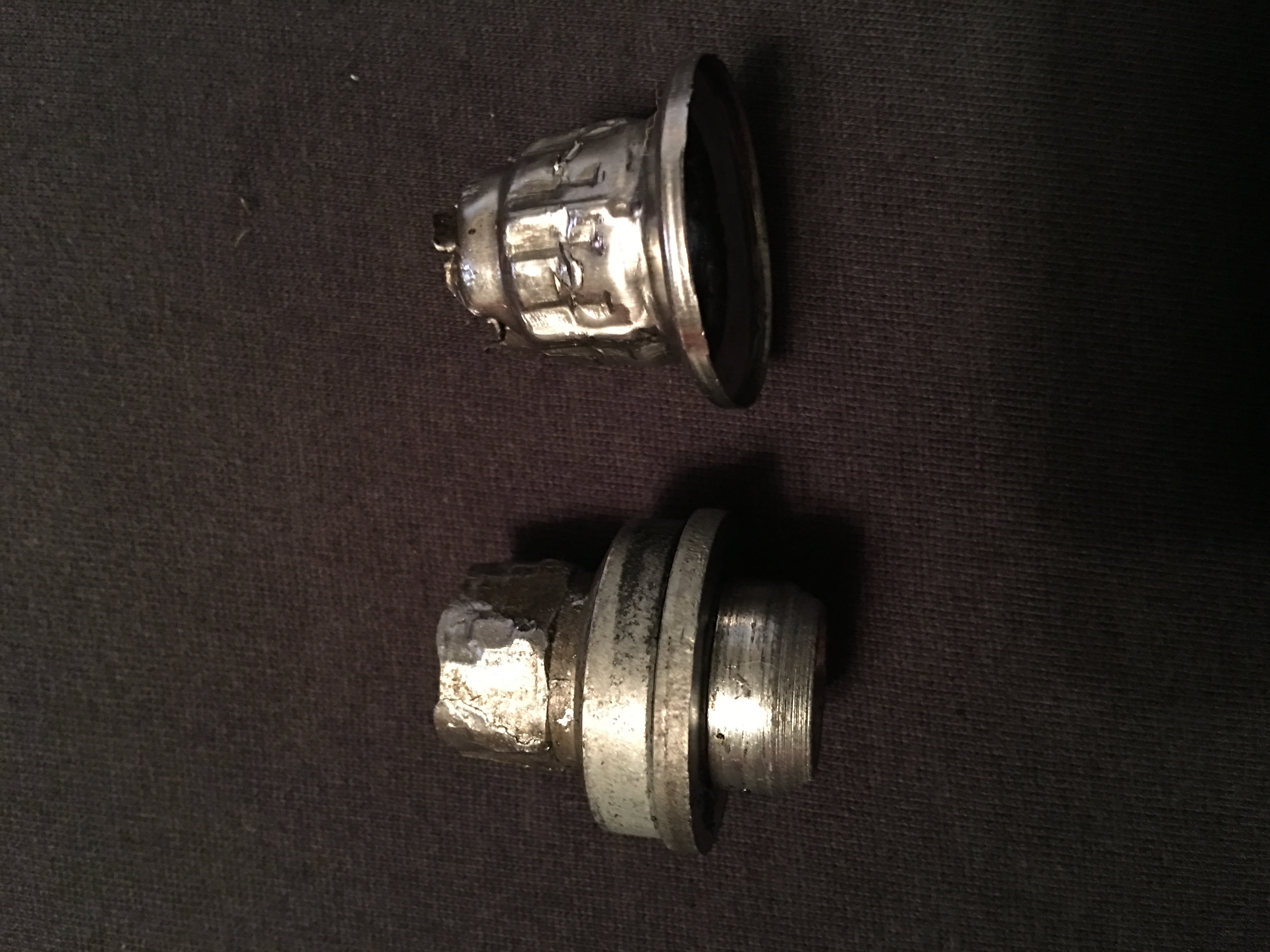

I replaced the brakes on my 2013 XFR today, using Ed's excellent guide. The only issue I ran into was when loosening the lugs. The lug nuts on my car have a cosmetic cover over the actual nut which is very thin metal. Because my lug were previously over-tightened by somebody else, I had to use some serious force to get the lugs off. In doing so I effectively rounded one of the cosmetic caps. I ended up having to drill through it, rip it off with some needle nose, and then smack an 18mm socket on the actual nut, which is a 19mm nut. Needless to say, it was completely ruined. Fortunately I had four extra lug nuts because of the locking set that is on the car, so I used one of those to replace it.
I was wondering if anybody else has had this problem? Also, I would like to replace all of the lug nuts with some better ones, and was wondering if anybody has any suggestions. I wouldn't mind doing black lug nuts to match the black wheels and trim, but then the locking nut would still be chrome, so I may just do chrome. What I really want is a lug nut that doesn't have the stupid cosmetic cap, but is just a good nut.
Any help is greatly appreciated!

I have the same problem as well, the oem lugs are terrible I’m trying to find good durable replacements

No way you should be using the OEM lug wrench, it's weak, difficult to use in an emergency situation, and prone to scratch your lugs nuts or wheels or both!
I recommend you get a 1/2" breaker bar (plenty on Fleabay) and a 19 mm plastic sleeved socket, see here for example: Powerbuilt® 1/2" Drive 19mm Lug Nut Socket With Sleeve - 941040 | eBay
I use this combo and undoing and torquing up the lug nuts is a cinch, with no scratching the nuts or the wheels.

This same issue affects just about all modern Jags. Went through the same crap 10 years ago on my S-type. Toss the OEM lug wrench as far away as you can.

...and ditch those ****ing awful lug nuts while you're at it. They only round off, and there's no advantage to Jaguar's terrible design. Why wouldn't you just have the lug wrench contact the actual metal of the nut rather than some stupid cosmetic cover? It's just asinine.
You can buy 20 lug nuts off eBay/Amazon etc for not very much cash - Toyota ones work well.
