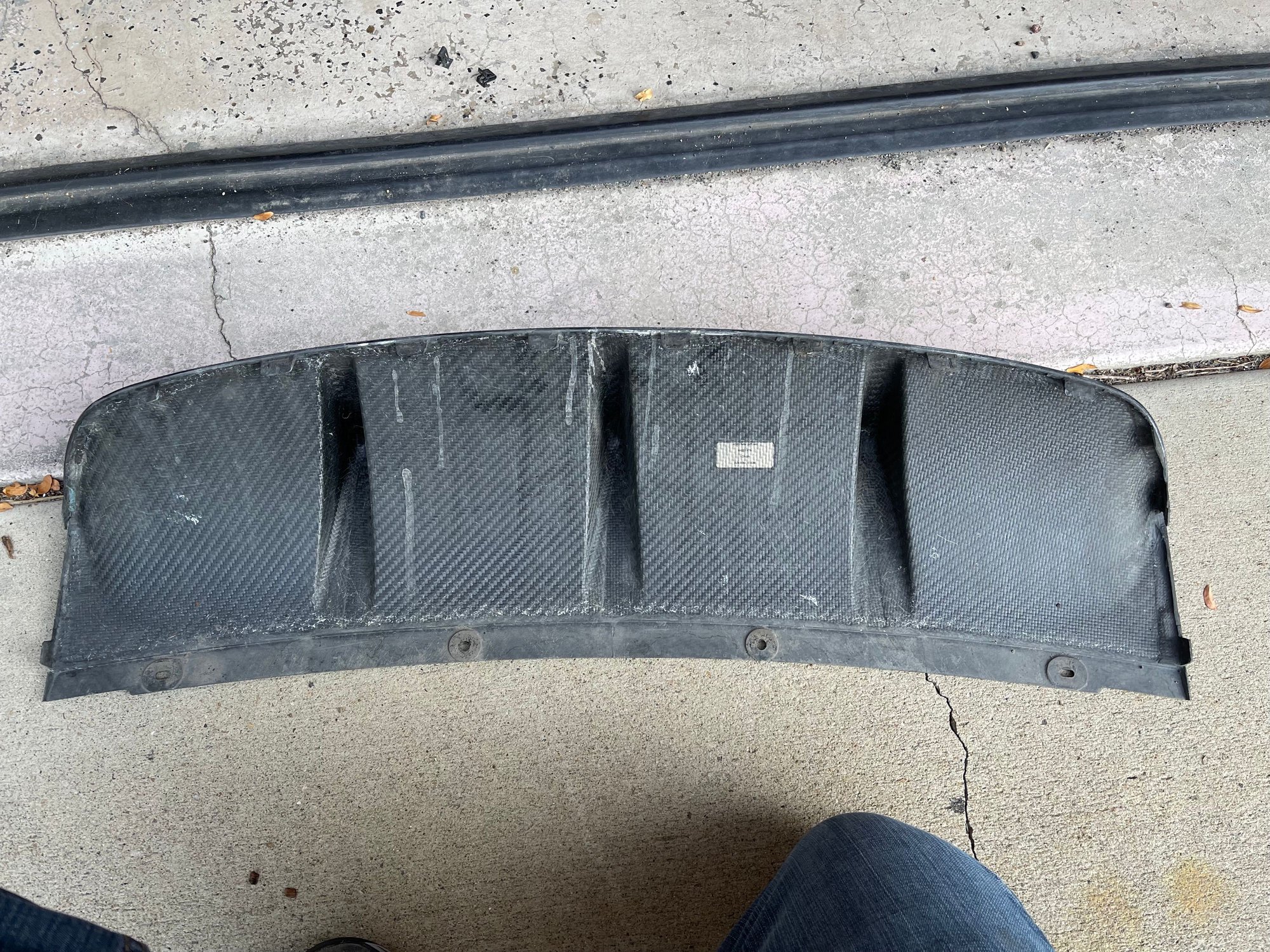

So, I already got rear ended the other day, and when the body shop gave me the estimate, I looked up the parts they are ordering.
C2Z16212 shows as a valance panel, lower w/ribbed diffuser, but from what I can see, it comes in "gloss black"
My question...were the stock diffusers on the 2015 XFR-S made from carbon fiber? I ask because this is what I have on my car.

Yes, front lower grill surround and rear bumper diffusors are CF on the R-S.
Thanks! This is what I thought. Now to find the correct part number for the rear carbon diffuser so the body shop doesn't install a gloss black plastic one instead.

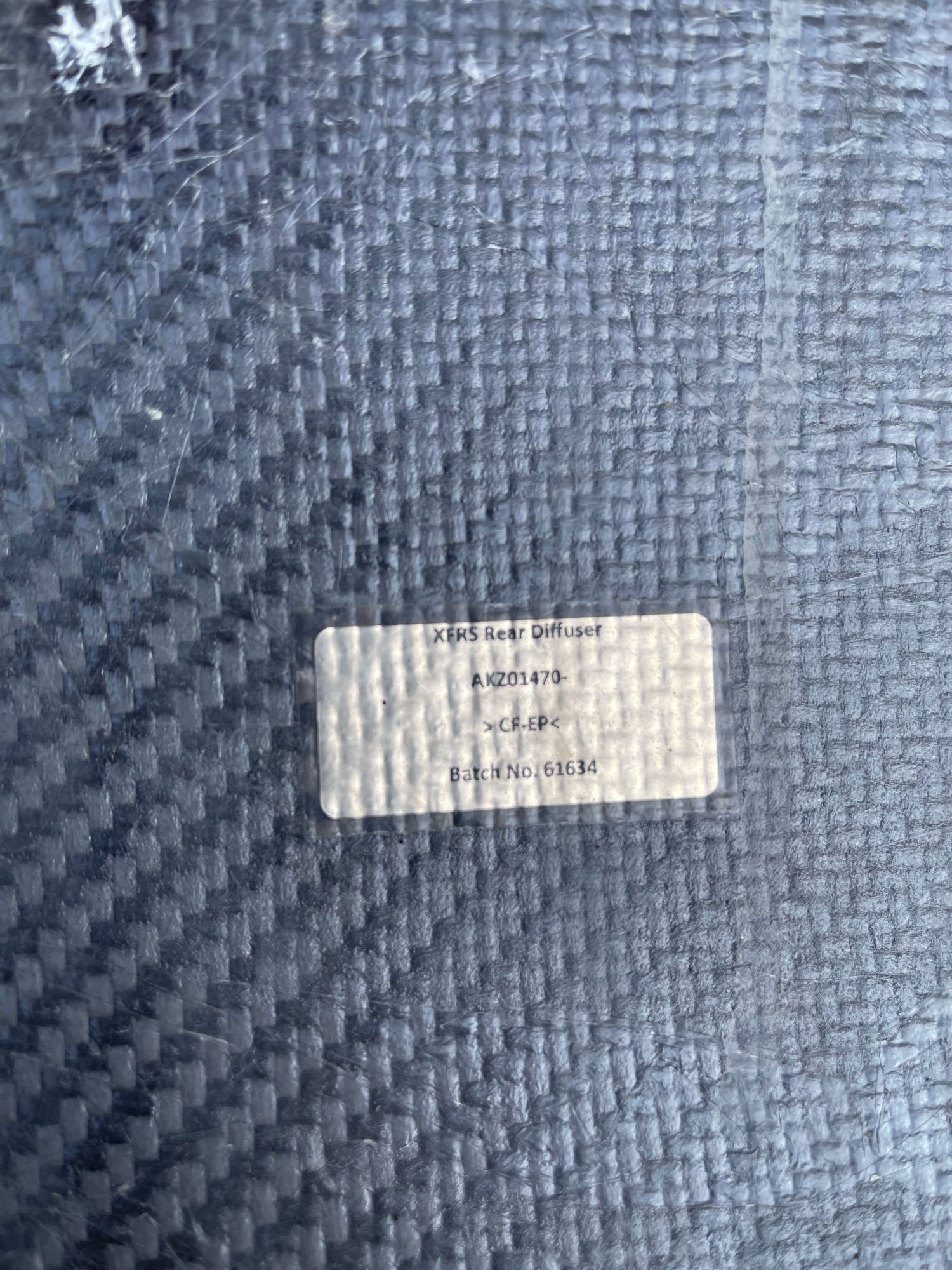

Well, I thought it would be a good idea to pull the diffuser and get the part number directly from the part. Too bad AKZ01470 doesn't show up in the Jag parts catalog...

lol go figure. I am about to do this for the front one on mine, i bet I get a similar non-cross ref part #. They dont make this easy!

Give these guys a call... Shop Original Jaguar and Land Rover Parts | OEM Discount Car Parts
They are a Jag dealer out of South Carolina, but the parts dept is very helpful. They were able to verify that the p/n for the carbon rear diffuser was correct and also let me know that the part was in the US warehouse somewhere.
