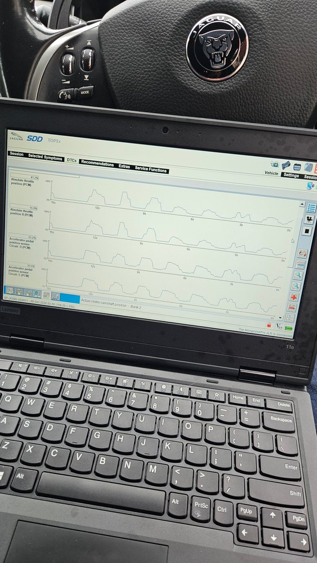

Alright, so I spent the whole day with the car, doing some diagnostics, also took out the plugs for the accelerator pedal, gave them a good clean and reseated. The sensor data all looks okay. Also did the MAF plugs, because they're easy.
