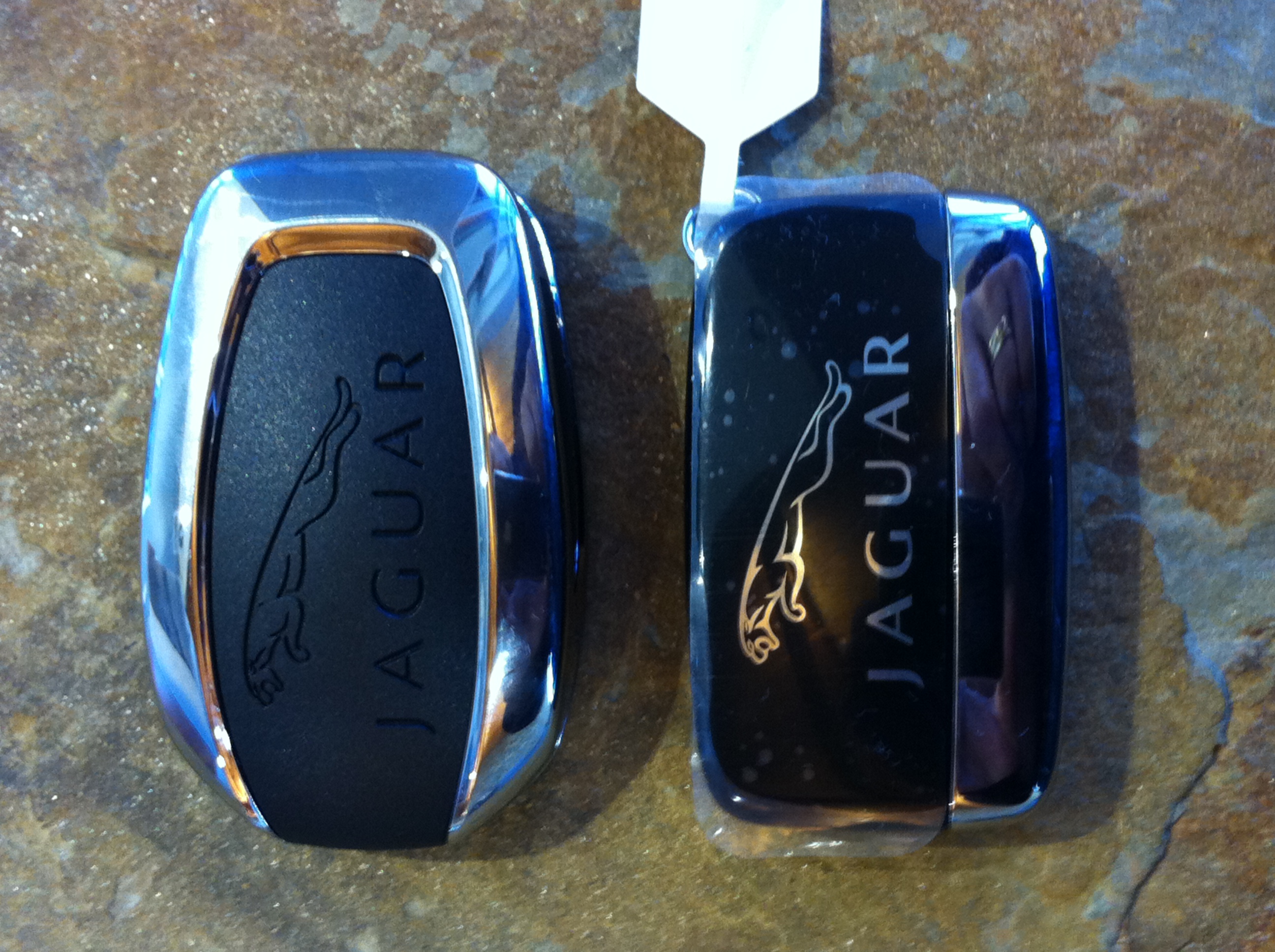

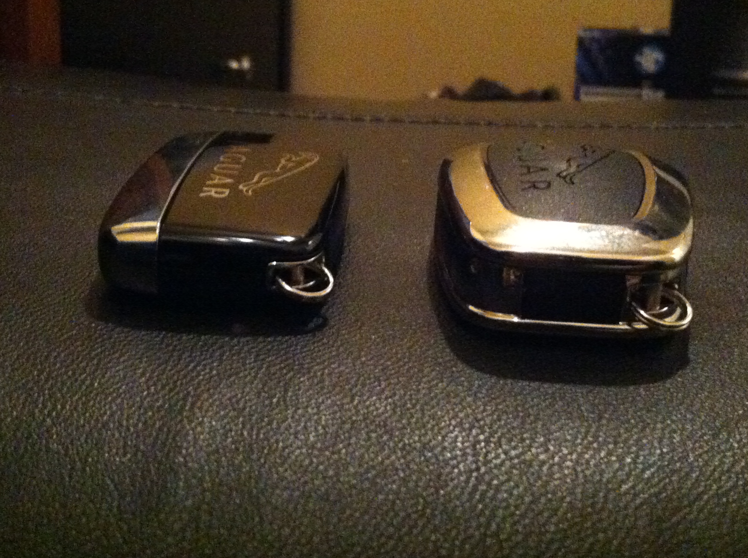

So there are 2 types of fobs and both will work. In the OP you say "remote start" and that is confusing as that feature is only available from 2016 on, if I am correct. the question is will the car start when you are in it? If not then Stuart's answer is correct.
Attached Thumbnails 11 Xj supercharged help with fob!-img_0605.jpg   11 Xj supercharged help with fob!-img_0603.jpg
