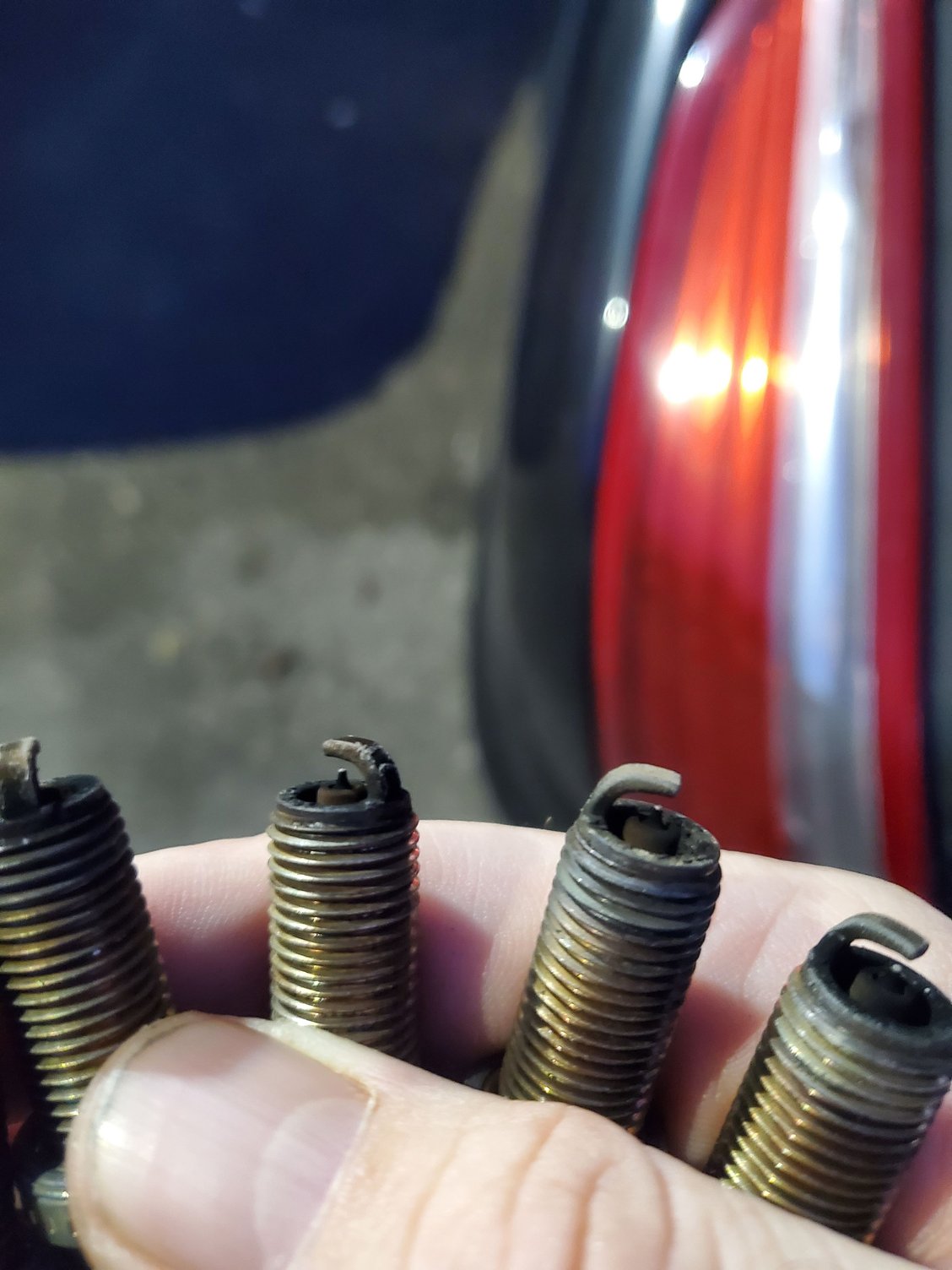

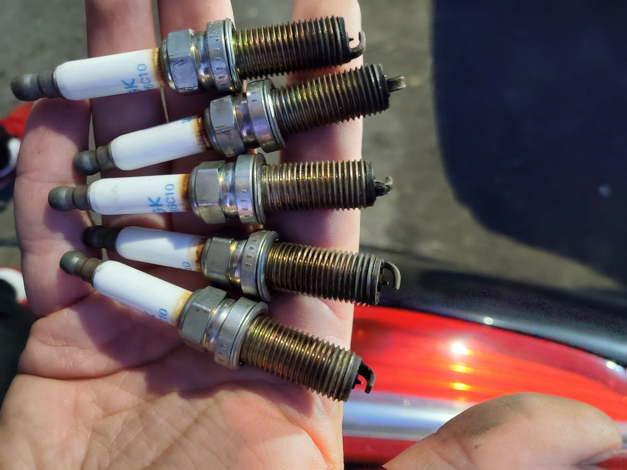

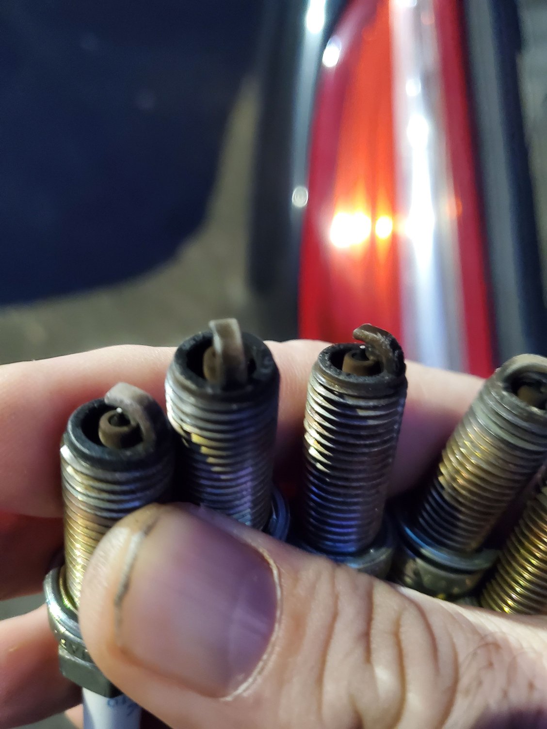

If there was water in the oil, but no other symptoms, I'd think oil cooler failure - but you have rough running.
Shame you didn't inspect the plugs as you took them out, the ones in the affected cylinders often look different - suspiciously clean, or even with coolant on them.

Any chance you can post pictures of the plugs?
Might help?

Here are the plugs from the car
