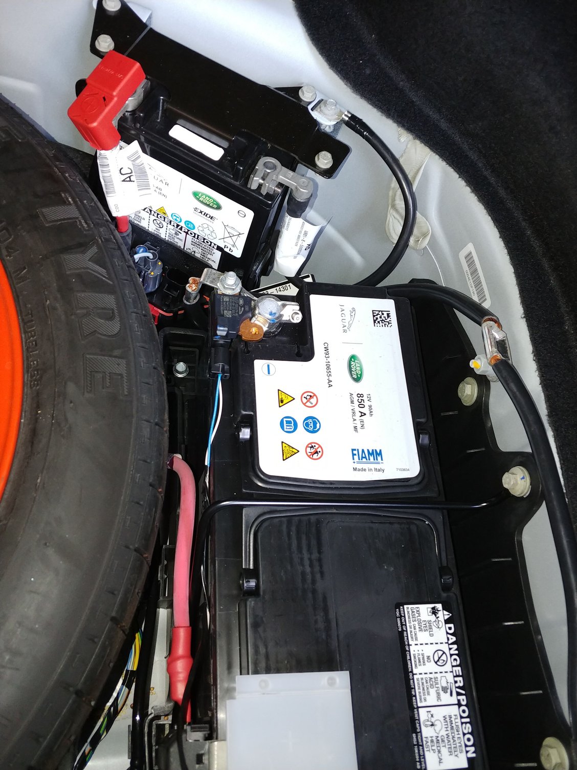

So I actually bought this today - appreciate the guidance. Unfortunately, after buying it and having it installed at a mechanic - I had the Advanced Auto guy "test" the old Jaguar battery and he said the readout stated it was a good battery but since I had already installed the newer one, I was not able to return / refund the new one (unless there is a defect, then the warranty kicks in). Alas, I will wait until if and when this problem arises again - either way it's never a bad idea to get a fresh battery when buying a car that isn't new.
I've attached some pictures of my old battery and trunk area - the old battery did not have a date stamp on it and said "Made in Italy" <------------- ??? Are you guys able to tell the age from the pictures / codes somehow?

I've got a bad eco start battery. It doesn't matter. It just disables the stop/start feature.
