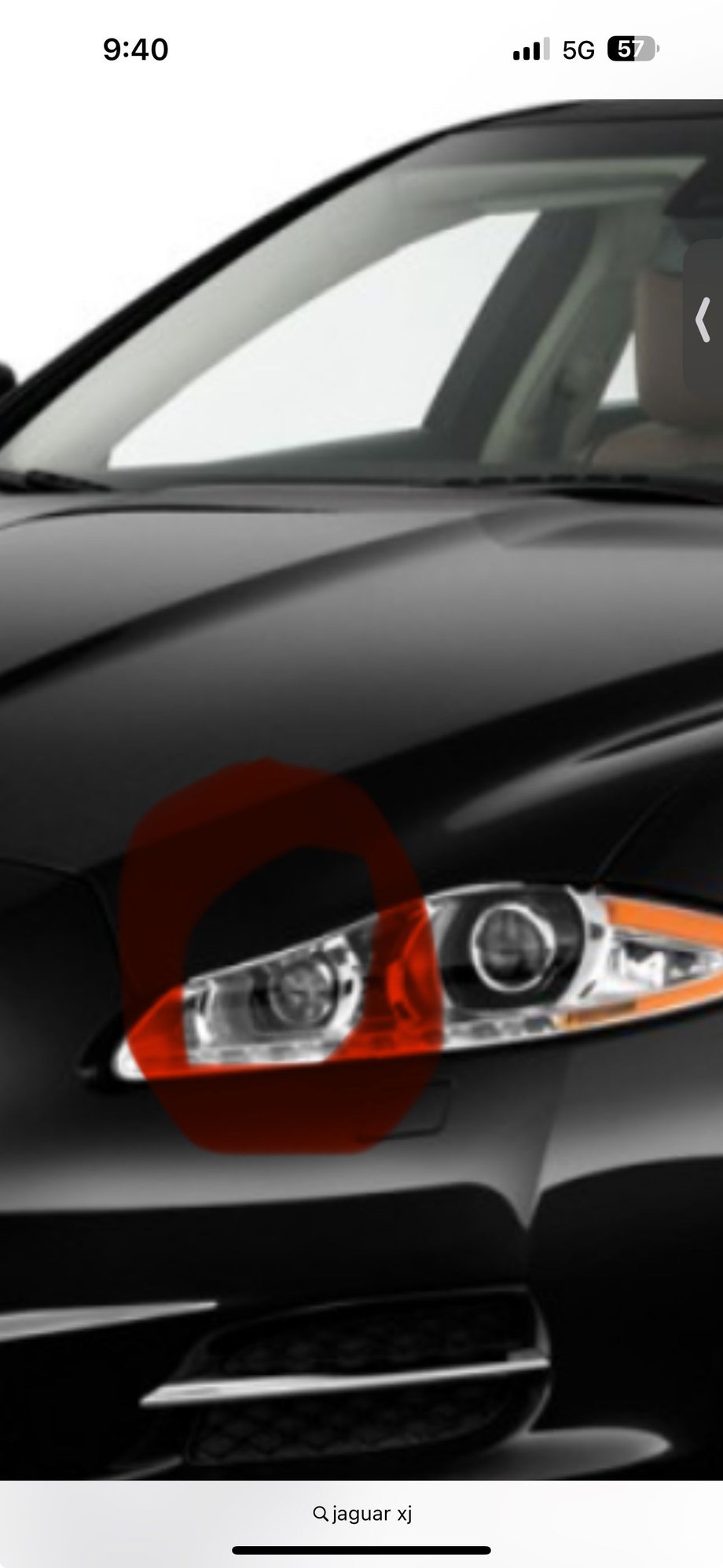

I recently lost my passenger side bulb. I’m a little confused as to what should be doing what. I have no high beam on the functional driver side bulb and when I press the fog light button on next to the trunk release nothing happens. The DRLs on both sides are functioning properly
before I purchase bulbs I’m hoping someone can help me understand what I’m dealing with as the bulb replacement looks like a minor PITA
what is the purpose of the light within the red circle? As stated neither side illuminates regardless of low, high or fog
also what is the best option for whatever bulb/s I need
If it matters it’s a 2014 R
Thanks

OH THREE Z, the light inside the red circle is for your turn signal. As for you fog light, the XJ never had front fog lights. The only fog lights you will find are in the rear tail lights.
As for your high beam bulb, that is a combined bulb with your low beams. So, you will need to look for a D3S bulb. This will be a 35W HID bulb that has 2 HID bulbs inside of a common housing (low beam/high beam). If you find them in a different wattage, DO NOT!!!! buy them. Your ballast is built around having a 35W bulb. Now, you will have a few choices in the bulb department as you will be able to select the color of the bulb. the factory bulb is 5000K as I recall. If you are after a slightly more white light, you can step up to 6000K. The next step up will be 8000K which will be blueish in color and tends to get you grief with the cops. If you are after a little bit more light, then you can step down to 4300K, but this is going to be a bit of a yellowish light like what a halogen light outputs from a conventional headlight.
If you have more questions, let me know.

I feel like an idiot concerning the turn signal.
This button threw me off. I don’t have my manual available so I have no idea what it is… I just assumed it was for additional lighting
is there a go to brand concerning replacement bulbs
thanks for the info
