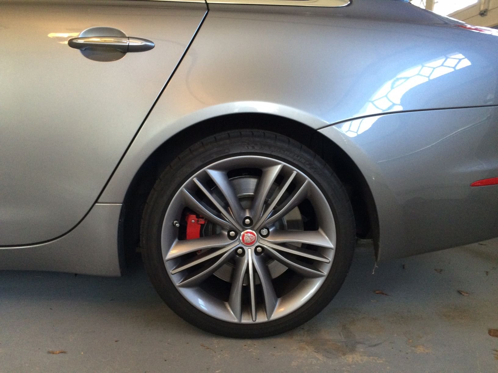

Painted back in March of 2017 and still look new. I had to do a little touch-up after changing pads:

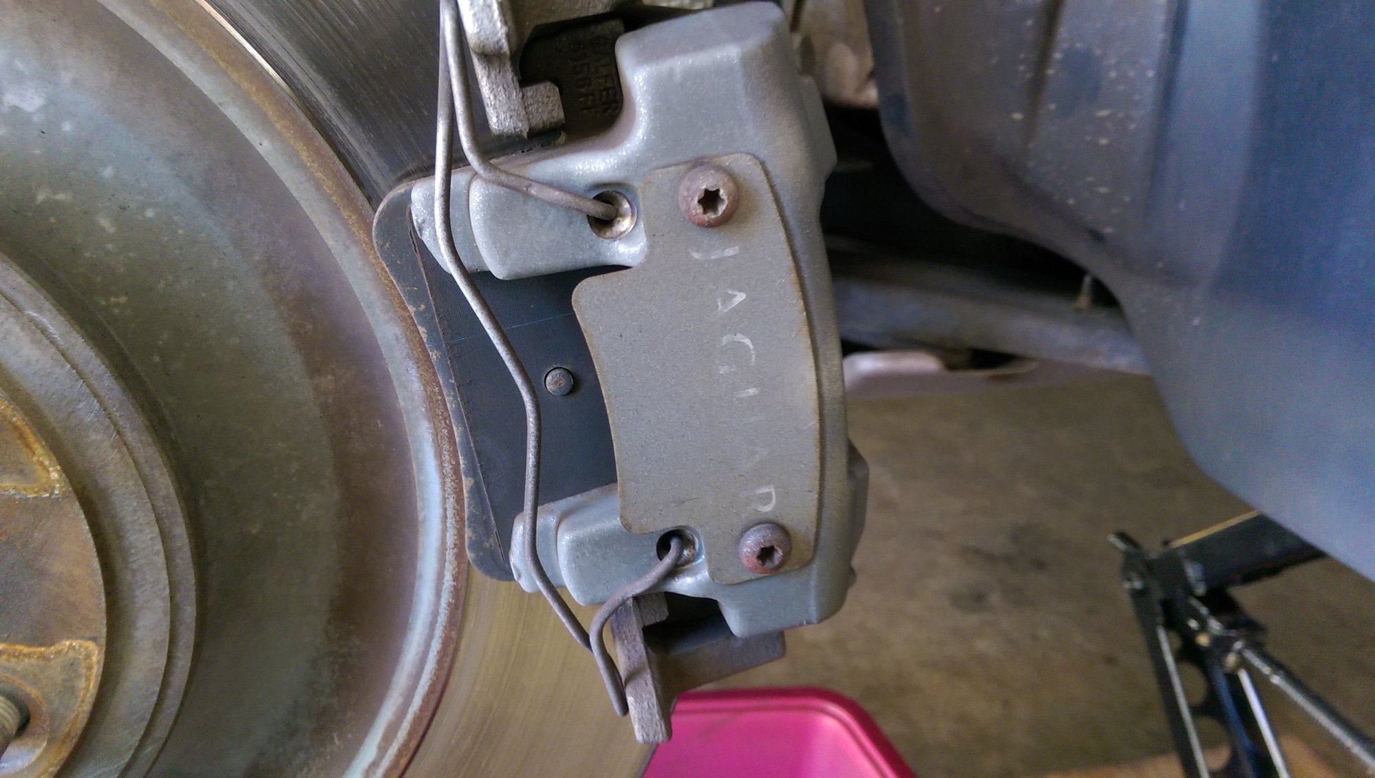

Thank you, I got them off eBay from Printgroup but it looks like they don't sell them anymore. You could probably contact them or find another seller.
The ones on the rear weren't included in the kit but they were able to get the correct ones after I provided measurements.
The rear sticker area is 2" from screw to screw.
Original rear stickers:

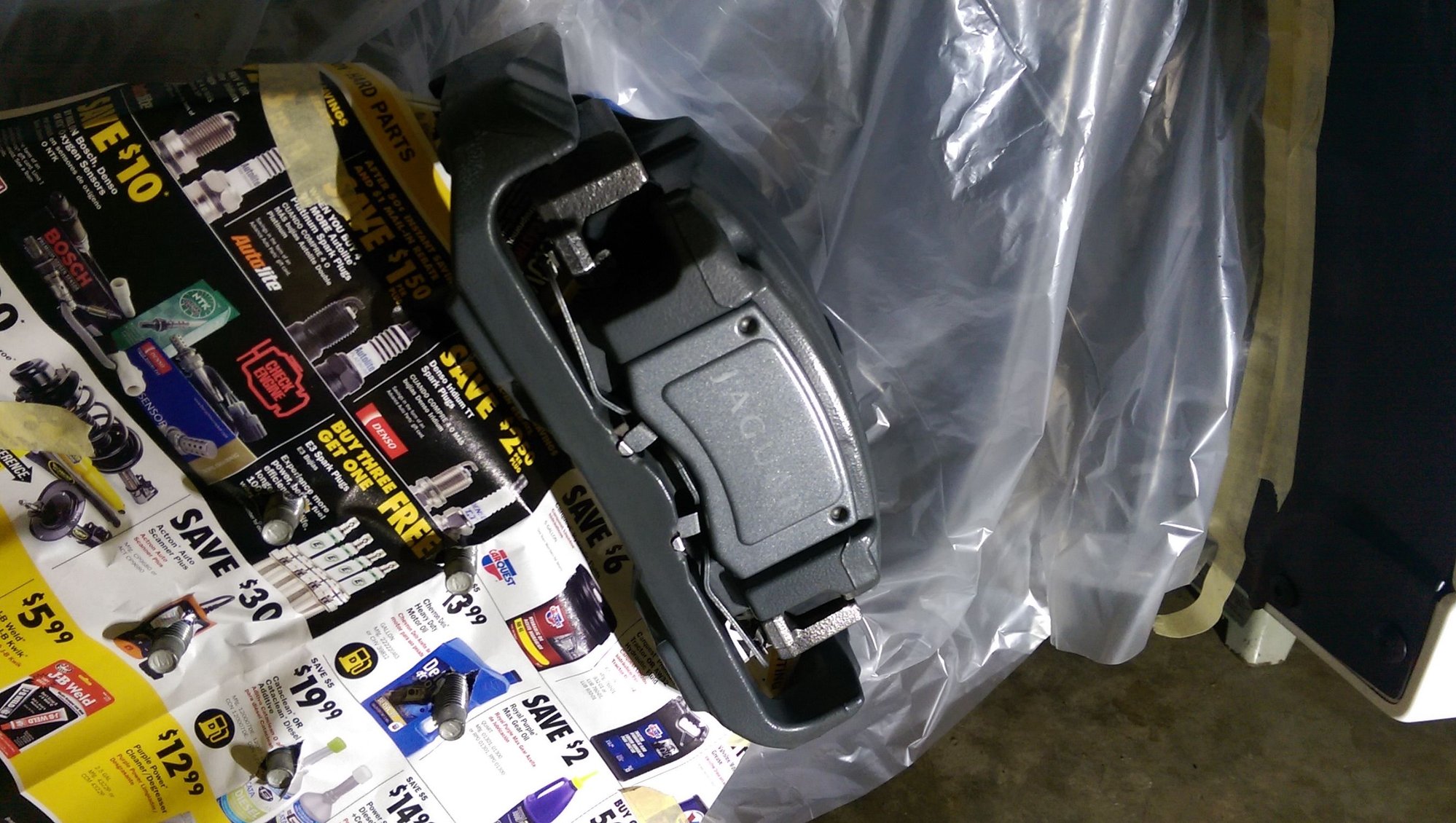

Looks great but I had a problem with scratching the caliper paint when I did the brakes.
An tips for installing the outside metal clip or should I just paint the caliper AFTER I have the brakes serviced?
Thanks, that metal clip almost made me cry lol.
Getting it off was pretty easy. Most of the scratches came from installing it.
I had red from a previous job and it matched. Dupli-Color caliper paint kit.
1. Cover letters with painters tape just in case it flies on you.
2. Cover entire caliper with a towel
3. Use a large flat tip screw driver and pry it up and out from the center
After reinstalling clip:
After touch-up:

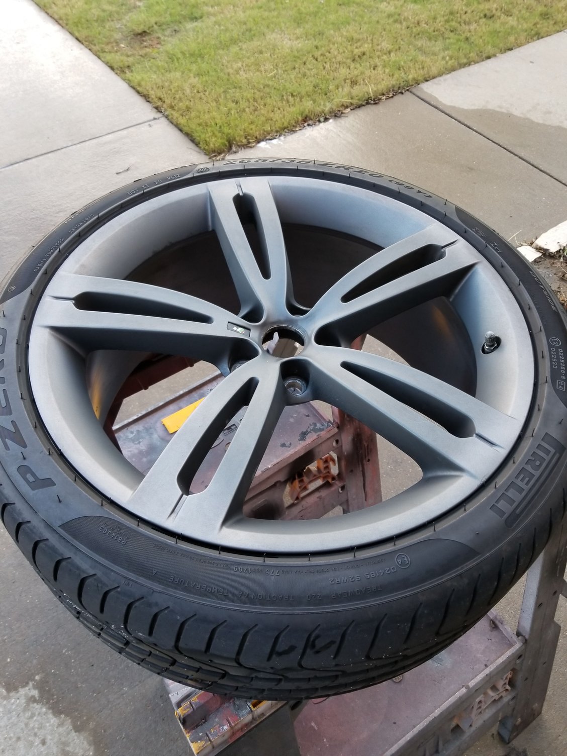

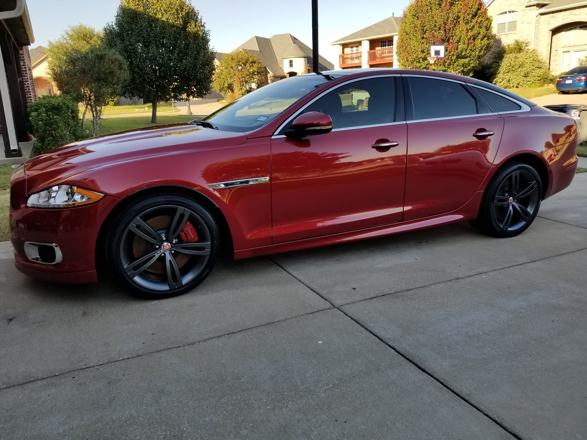

Well....the weather was perfect in Texas this weekend to tackle the project and I had all the supplies, so here it is. As reference, here is what it looked like before:
The wheels were grey, but not the correct color. This became much more evident later on. The calipers were faded at best.
If you look closely at the wheels, you can actually see they painted OVER the dirt:
After sanding, you could really see the color difference!
Now with the fresh paint:

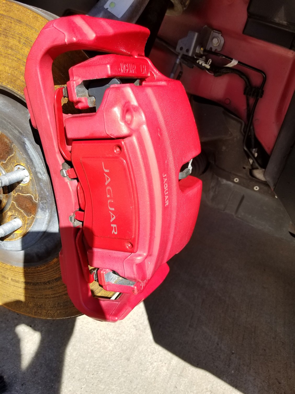

On to the calipers. Badly faded probably from using the wrong chemicals to clean the wheels:
NOW, the car looks correct!!
Thanks for everyone's help!
