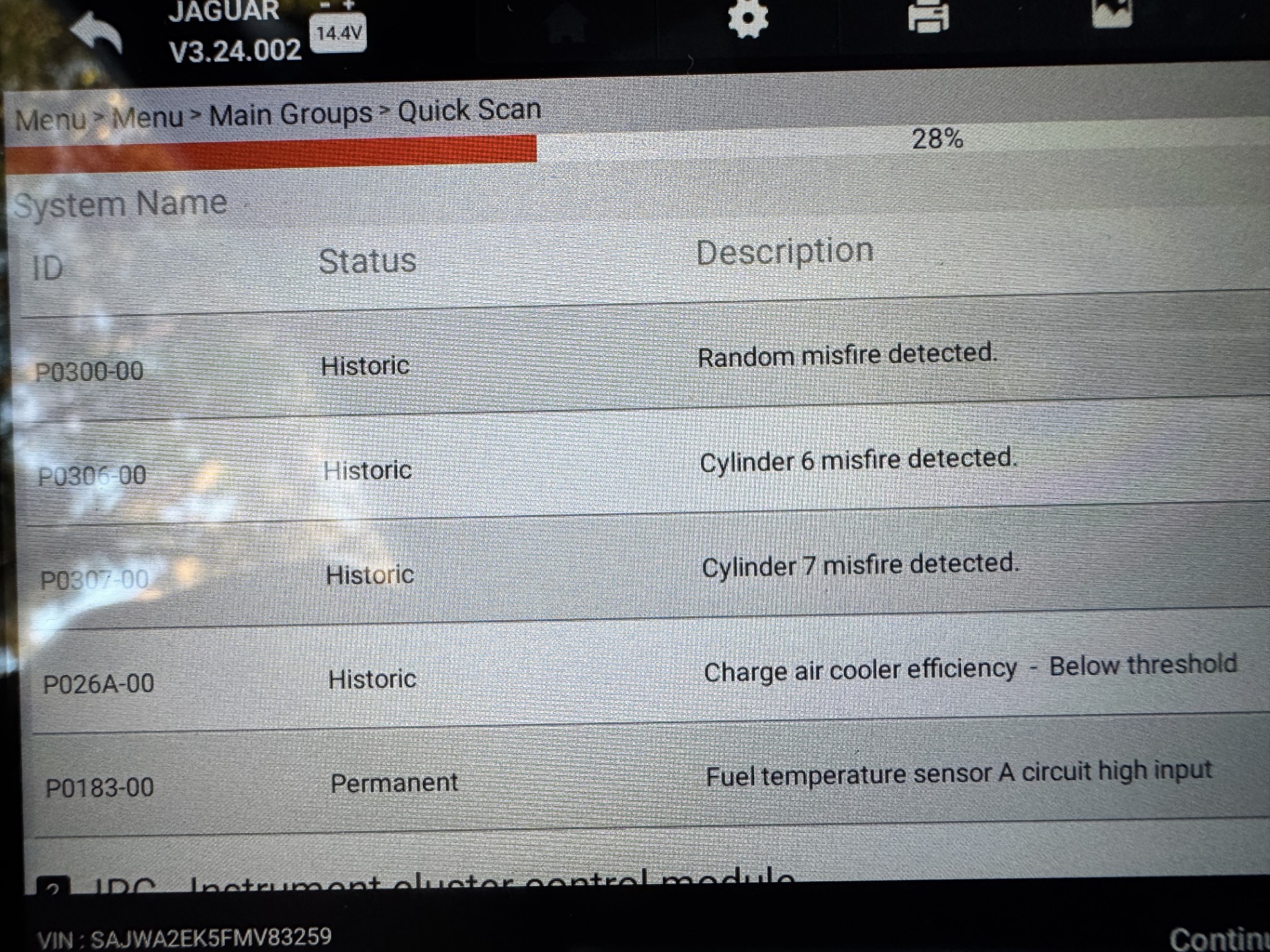

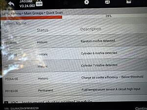

Hi guys,
I spent the majority of my day trying to figure out WTF this code is and where the sensor is. All data gives the testing process, but doesn’t tell you what the part number is or where the darn thing is located. I’ve searched every Internet forum, Facebook post, Reddit thread. I’m at a total banging my head into the wall spot.
Every time I start the car the CEL comes on. Plug in my Foxwell NT710 - P0183-00; Fuel temperature sensor A circuit high input.
I am at a loss. I cannot find the sensor. The best I can figure is when I did the passenger side fuel injectors, the sensor at the back of the rail by the firewall is the problem? I thought that was the fuel pressure sensor but….maybe it does both. I’d like to be sure before I go tearing into that area again.
Any help would be super appreciated. It’s just been problem after problem since inheriting this car after my dad passed. He had it for years and never had these domino effect problems I am. LOL.

The sensor you mention on the passenger side of the engine is the high pressure fuel sensor. There is also a low pressure fuel sensor on the top of the fuel tank to monitor the LPFP.
I find no fuel temperature sensor on the 5.0L engine? BUT the older 4.2L SC and NA both have one? I also find the 2.2L Diesel has one.
I wonder if that code reader is wrong?
Strange but I did find one mention of it on JaguarLandRover Classic? With a part number of AJ810514. However that is the only place that lists the XJ as having one. I have several manuals and a Jaguar Engine Management guide with no mention of this sensor at all? Plus other Jaguar part suppliers plainly show this part number does NOT fit the 5.0L engines and again is used on the early V-8 and V-6 engines.
Here is the picture;
Fuel Temperature sensor
I think this is wrong because the 5.0L has DI and looks nothing like that picture which to me is plainly the older 4.2L engine setup.
Look at this?
Jaguar Code P0183-00
Note it mentions a combined fuel pressure and temperature sensor? I guess as a hail Mary pass I would change the fuel rail pressure sensor you mentioned? I don't think it's too expensive.

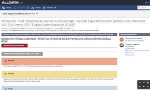

I think it's why I've been beating my head against the wall. AllData gives a testing procedure for this trouble code - but - it doesn't help as it doesn't show where the sensor is, what part numbers, etc etc. I've attached what my scanner shows and what AllData shows. But I have no idea how to fix this code. Like I stated in my post - every single time I start the car this code triggers and the CEL fires up on my dash. It's only started the last few days. I believe Friday it triggered and every time I drove the car, which was all Friday and Saturday, this code would trigger. I've been driving around with my scanner connected just trying to see what is what..going crazy. LOL
At this point because I'm simply tired of suffering this car and the BS it's continually giving me I'm going to go to the Jaguar Dealership and buy a brand new fresh battery. Though mine's a 2021 battery and lives on a battery tinder - so it's fresh and fully charged all the time - I'm just going to rule that out.
***The Random Misfire on 6 & 7 is something I have been chasing as well. All 8 fuel injectors, spark plugs and coil packs are BRAND NEW - properly gapped, etc. So I have NO idea why I am getting misfires and the charge cooler efficiency is wild to me as well, but it will soon be swapped out for a Wraptor Performance all aluminum charge cooler so...I'll chase that another day.

Any chance the IC pump is not working 100% with those codes? Generally if it's not working that will throw the car into restricted mode when you jump on it hard.
The miss fire codes are listed as historic? Do they go away when clearing the codes? One thing I do like about Jaguar's SDD is they also show at what mileage the error occurred.
