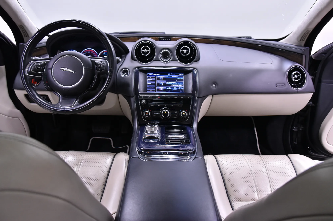

2013 was not a bad year? The first years (2009-2010 for the XJ) of any car are the worst as problems show up that did not during the factory testing. The 2013 model has some real improvements with the 8 speed ZF being one of them. Nothing wrong with the 6 speed but I have had both transmissions and the 8 speed is better all the way around. Performance and gas mileage. It was a good upgrade.
Without more details on exactly what they are doing we don't really know. It sounds like a timing gear problem but that is low mileage so kind of surprised at that but possible. Can you get any more details and maybe a parts list of what was or is going to be replaced?
With you being in such a different market compared to the US I can't comment on if that's a good price or not? In the US there is no demand for XJ's and they go for cheap prices.
One thing that stands out is the lack of information about the car. Can you get a private inspection done? It would be money well spent.
Any kind of service records? The ones posted only show fluid changes and some of the mileage intervals are VERY long? Maybe an oil change was done some where other than the dealer? As you have read many on the forum feel as I do that the long oil change intervals of 15-16K miles are FAR to long and I change mine at 6K-8K intervals.
Note the console that has the purple color? That is sun damage as those parts should be gloss black. That's an indication that the car sat in the weather and may not have been garaged. Just cosmetic and up to you if you want to fix it but might be worth a mention when your negotiating price? This would lead me to look for other cosmetic issues.
I think with the age of the car you will be better off doing the repair work yourself. You have already looked at the improved cooling parts and I think that is smart. You have educated yourself BEFORE purchasing so you "hopefully" won't run into anything too bad.
We love pictures so post away and some from under the hood would be useful.
Thanks for your detailed response, unfortunately I don't have any pictures of the engine since they did not allow me to see the car, only posted the pictures from the advertisement itself.
I tried to see exactly what specific piece they can't source in case I might have a chance in doing so, but the sales agent told me he is not a mechanic and changed the subject. I'm considering bypassing them and going straight to the repair shop, maybe I get lucky and run into a staff member from there or even a mechanic who knows more details about the problem.
Regarding the service records, the image already posted are the only one, and yes you are correct, the intervals there are HUGE and says a lot about how the owner treated the car, basically he followed the massive service intervals of Jag standard which might be the cause of why a such low mileage car ended up in this situation.
Speaking of the purple color, I checked other pictures and it seems like the interior trim color if this car is not the classic Black but a Blue Navy which was a bit rare but available at that time, so both dash leather and the console have this color, maybe it was only available for European market, who knows, so the purple hue of the plastic console is light related, the original color is that blue navy.

OP, to me, that seems like a LOT of money for an 11, soon to be 12 year old car, especially one that appears to be tied up while repairs are being made to it. Strictly as a reference point, several months ago, we sold our '16 XJ-L Portfolio, with only 16,000 miles on it, to the local CarMax, a used car emporium. They gave us $24,000 USD for it, which while not exactly "top buck" for a car in it's condition, it was a rather reasonable offer, compared to a couple of other offers that we got. CarMax turned around and put a $32,000 asking price on it, but I have no idea if they got anywhere near that figure for it.
Old Nov 20, 2024 | 08:14 AM
clubairth1's Avatar
Community Influencer
Posts: 12,134
Likes: 3,383
From: home
The center console only came in gloss black. That blue/purple color is well known and it's due to sun damage. Posted several times on this forum.
