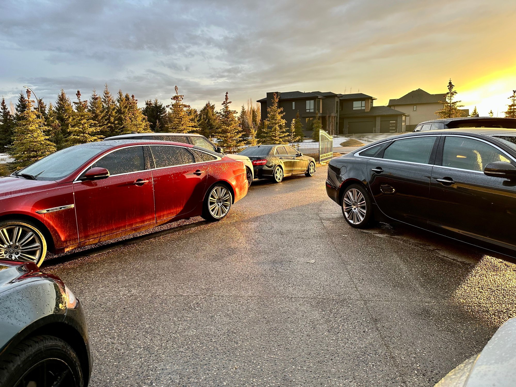

I’ve done the upper pulley and was wondering if it’s beneficial to change the lower crank pulley?
would it heat soak?
what’s needed to run this setup
thanks guys
pfa
PFA
PFA

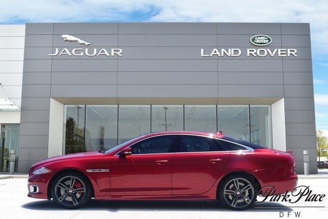

Well thank you VERY much! Usually these types of compliments are reserved for our senior member Karl!
I am biased because when I saw that red car it's almost a twin to mine.
Is yours is IRR too?
Picture from dealer when I got it back in 2017.
The dealer has stopped selling any Jaguars and is only a LR dealer now.
Same with my local dealer here in the DFW area. Only LR going forward. Which kind of sucks. But there aren't many Jags to sell these days either.

I’m assuming you’re asking me about the paint?
if so then mine is Radiance Red Pearl
Your XJR is beautiful, I would buy one if I ever see one for sale that’s in good condition.
I just picked up the one on the right and it only has 35k on it. It’s pristine so it’ll stay stock
I have a silver and black one that I’ve been modding.
the red one is actually for winter
