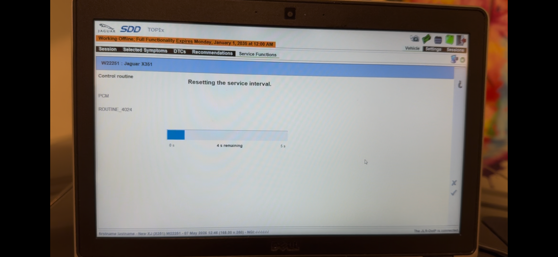

I will be trying it very soon. I have a genuine Bosch 6533 VCI, a freshened Windows 10 Pro laptop, and SSD v168 installed on it.

Looks like it works. It says it completed the service interval reset, but I couldn't find in the data logger or anywhere else where to see the counters related to the service interval. Does anyone know where they are?
I'm not an SDD user, but I can see "distance until service" on my Jaguar Remote app.

I stopped paying for the remote app because I didn't find it that useful, so that info is not displaying for me.

They should be in datalogger, probably in the instrument cluster if not the PCM.
