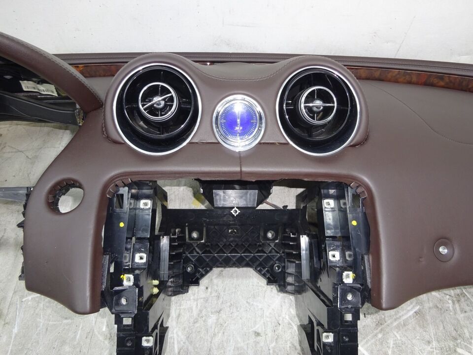

...is removable without taking out the whole dash, or removing everything underneath it to get access? Talking about the separate top piece that covers clock/air vents, need to remove mine to repair the leather cover.
Picture attached. Thanks.

Looks like a lot of work

Indeed it looks that way, think I will attempt in place, and disassembly as a second option. Thanks for the assistance!

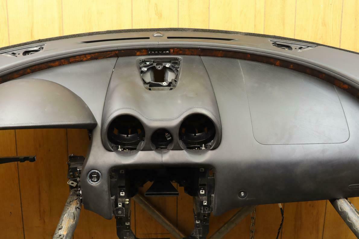

It looks like this top piece is only held down with 4 screws in the front. The question is whether or not you can get to those 4 screws by just removing the infotainment unit, or if you have to remove the whole dash top to get to them. I can't tell from the limited pictures I have found online. The infotainment brackets may be in the way.
