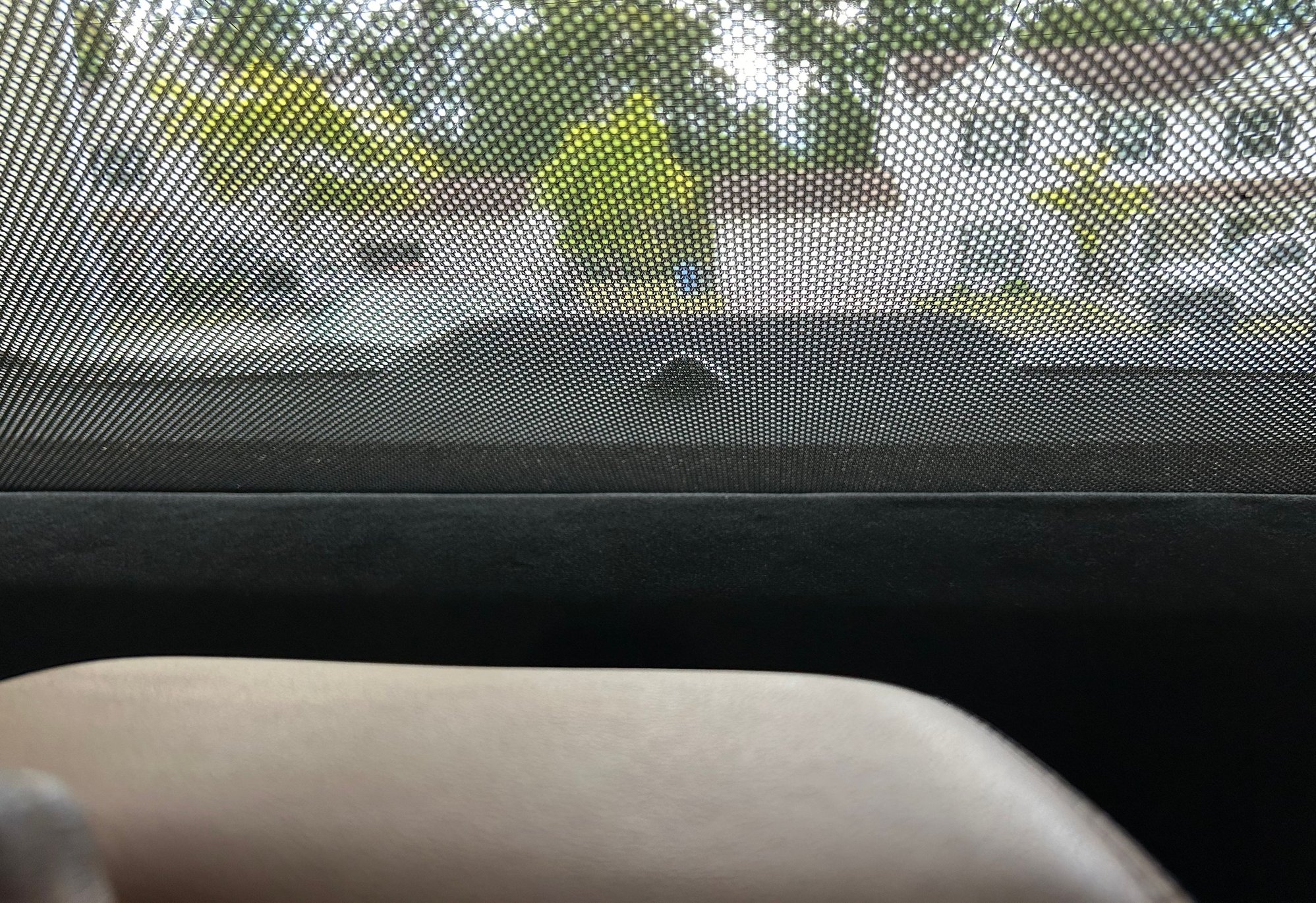

Unfortunately, my XJ was not originally fitted with the electric rear sunshade screen. I always thought that it should’ve been standard equipment on the XJ. It may have been standard on later models. This weekend I decided to install one.
Originally fitted rear parcel shelf. No rear sunshade.

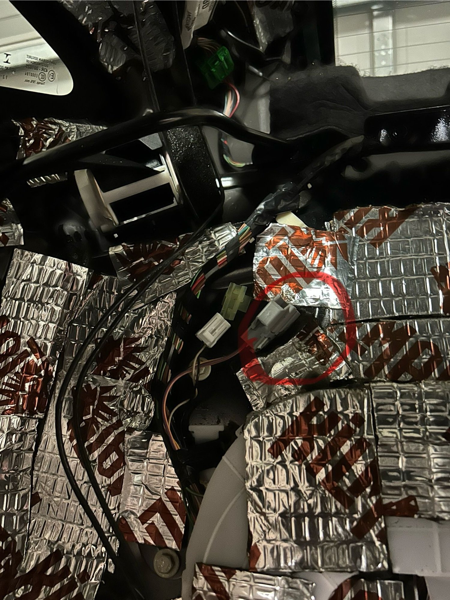

If you don’t have it, your vehicle is most likely already prewired for the electric rear sunscreen. To verify, check behind the upper portion of the right rear passenger seat. If you have this unused gray female connector, then your vehicle is prewired.

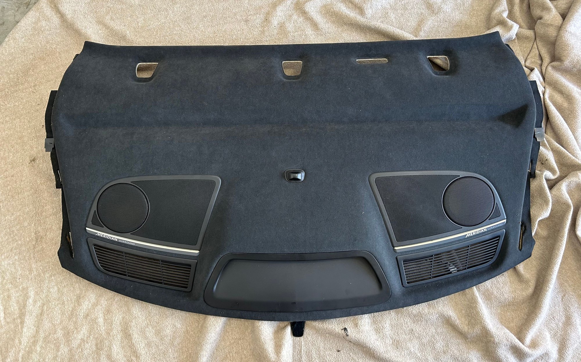

1-The rear parcel shelf with the electric rear sunshade. You can buy these separately, but it’s much easier if you can find them assembled together. Make sure the sunshade comes with the motor and the connector that connects to the vehicle.

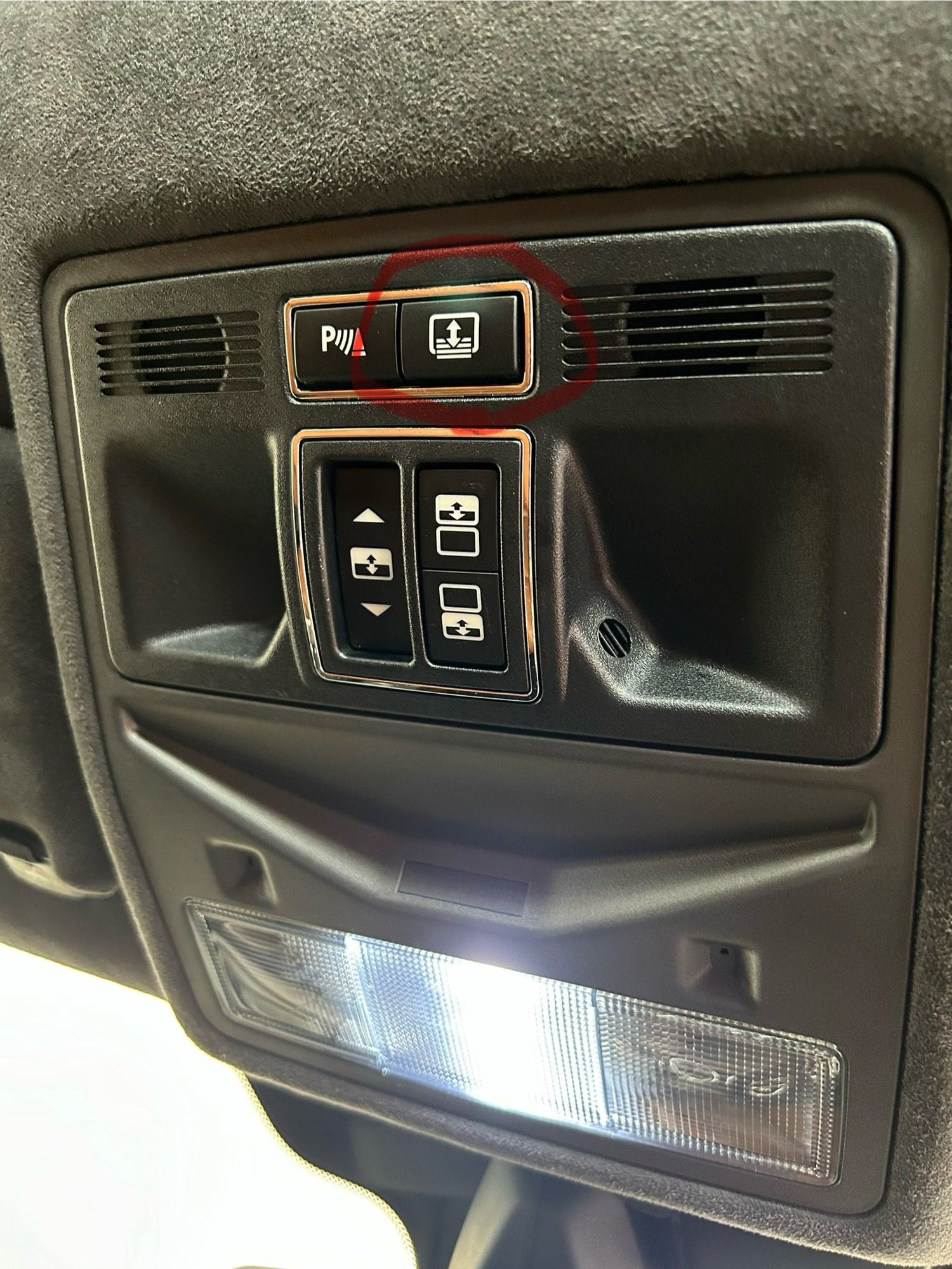

2-The front overhead console with the button to control the electric rear sunscreen.

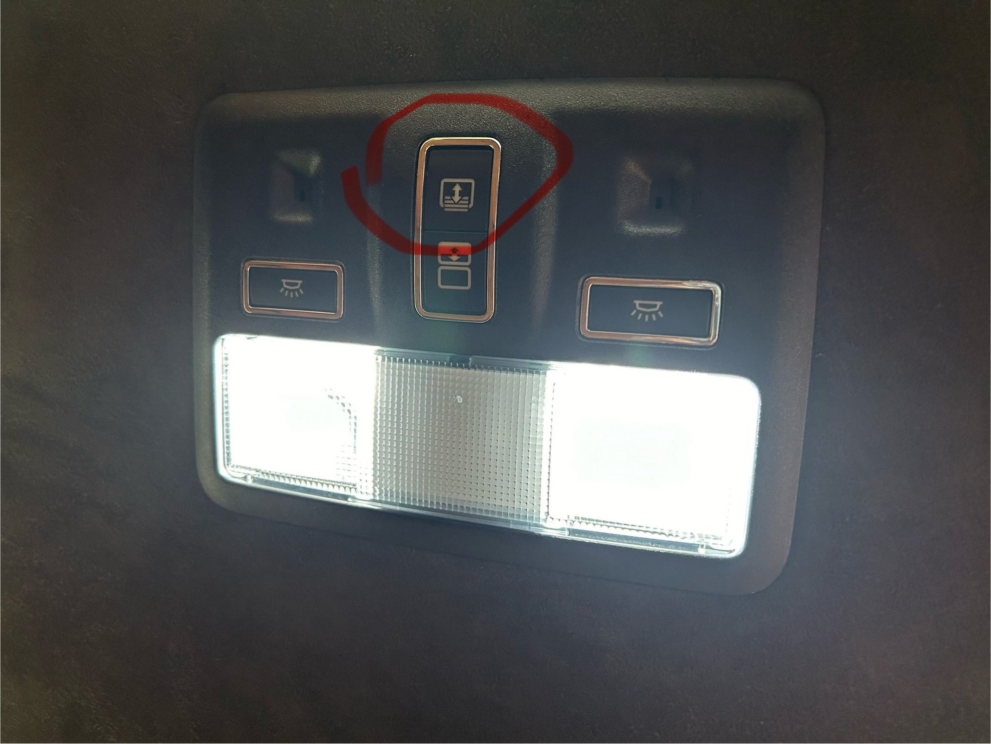

3-The rear overhead console with the sunscreen button.
No need to over complicate this project. Swap out the front and rear overhead consoles. All plug and play. Change out the rear parcel shelf. The rear sunshade motor connector connects to the unused female connector that was referenced earlier.

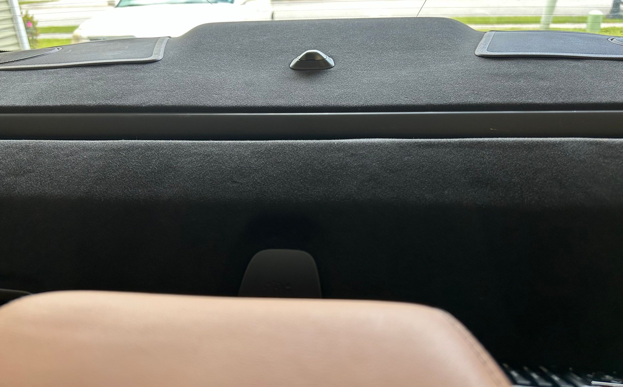

Finished product.
Overall, this project is not too difficult. However, being cramped in the backseat removing and reinstalling the rear parcel shelf makes this difficult. It’s pretty straightforward, but working in the back seat is rough. It’s a good Saturday project though.
