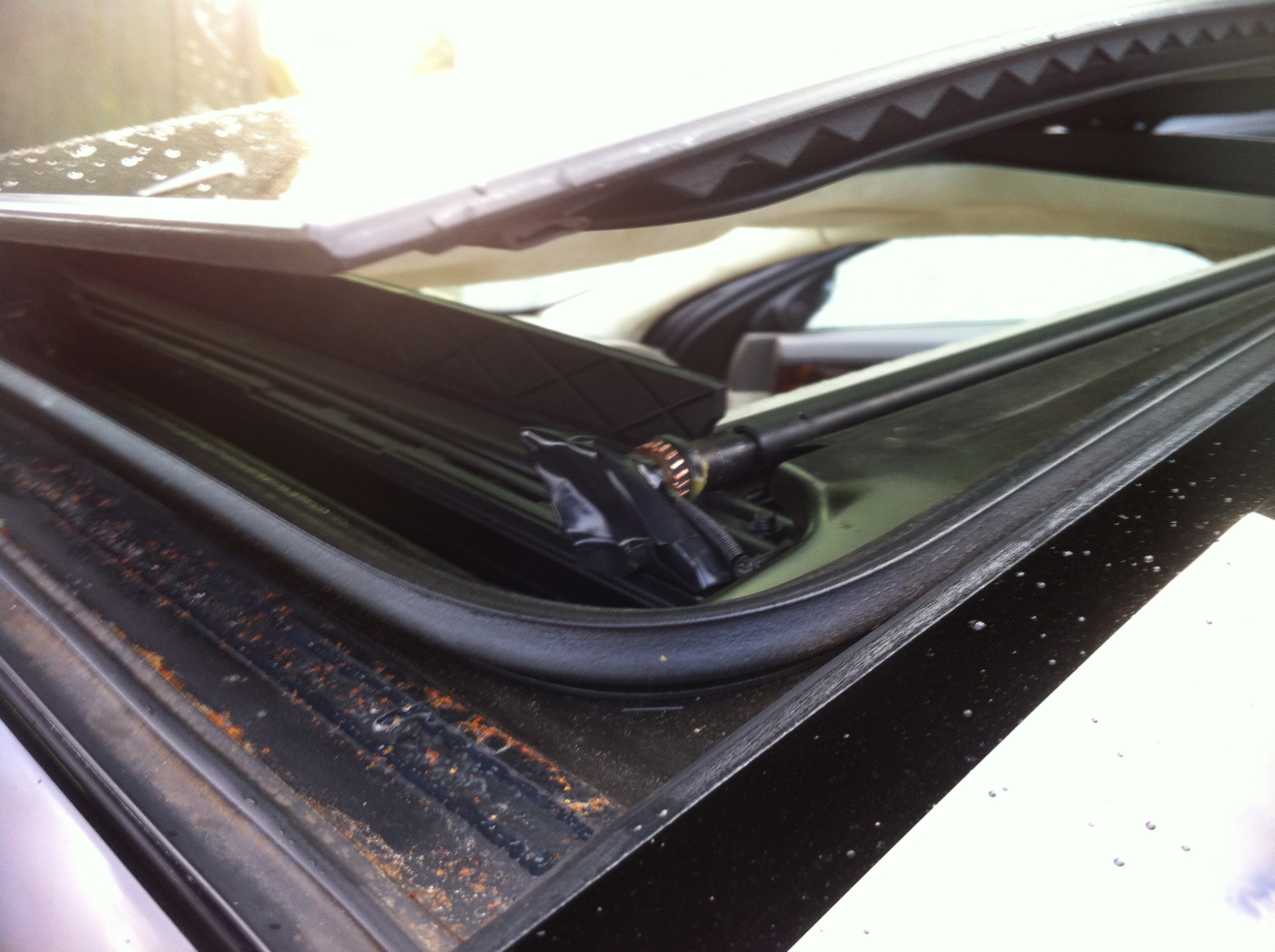

Sorry, forgive me I'm not on this as much I'd use to be. Hears a couple of pics I took this morning. Now I should point out that this was third attempt at this but so far seems to be working just fine (last attempt was about 4 months ago). The only noise I get from the roof is when the car naturally flex's, like going over a speed bump at a angel and it's just a light flexing noise which I'm totally fine with. Also remember to get best access you need to press and hold the sunroof opening button to position one then let go, then press and hold it again until the glass has reached the highest it can go and then let the button go.
Give it a go if you want, but it may take a few attempts. Hope that helps.
