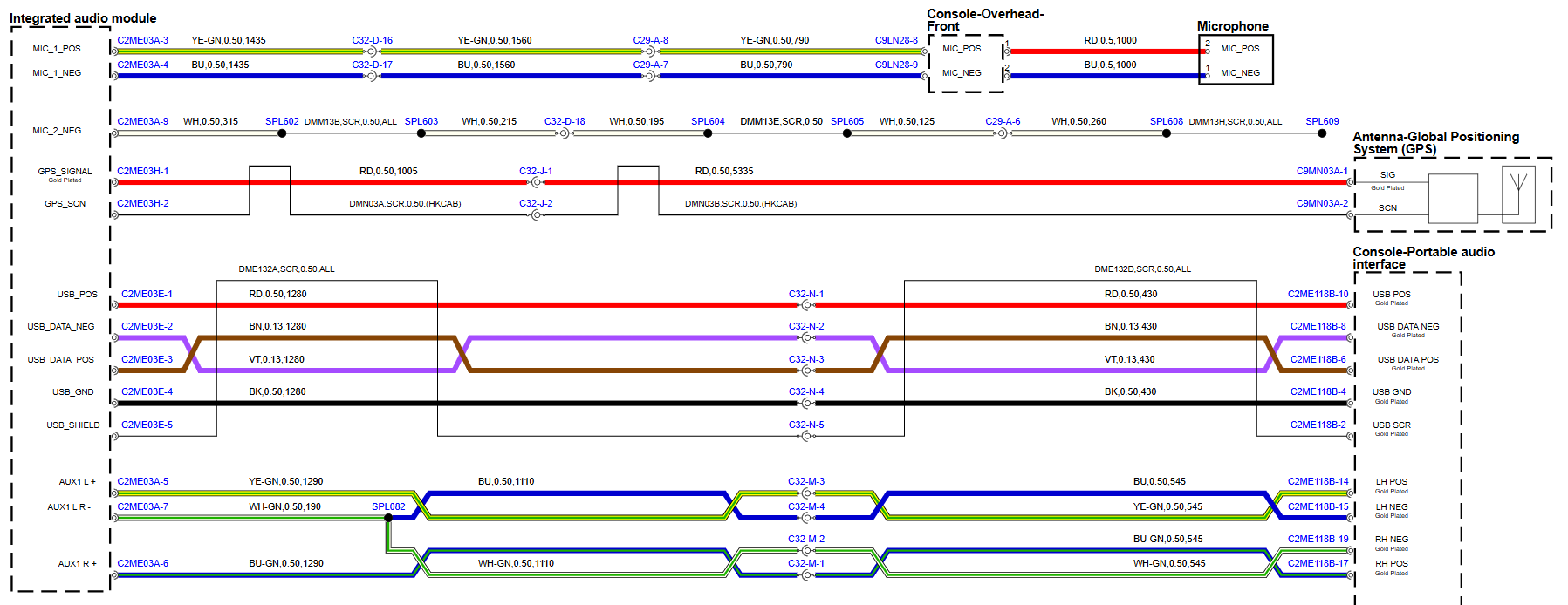

Looks like they share a ground, but have different right and left input channels at the audio module. Possibly an issue at the midline connector as well, that C32M connection where the console meets the car harness.

Thanks for posting the diagram. Any idea how a technician could troubleshoot and repair this?

Check the continuity of the wiring from the media panel to the head unit, in this case. Normally the media panel would get swapped with a known good one first, as they do fail at times. Then you could test the wiring to the audio module. If all checked out, you would need an audio module.
