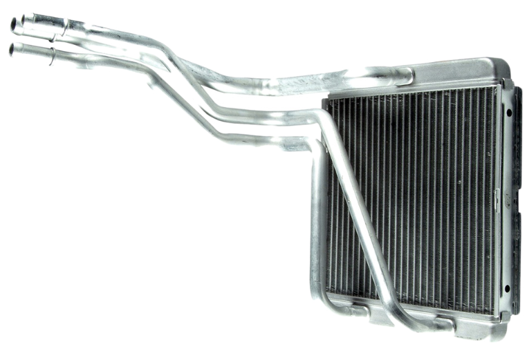

Not sure but I flush any and all ways before hooking it back up. With a dual climate control system you have split heater and AC cores so you can't get a full flush because there is always a second path for the fluid to go if it runs into a restriction.
To fight this I blast thru both inlet hoses at the same time. There is only one outlet but two inlets. Then I reverse the hoses and flush it that way too. But we need to understand that you can't do a full flush on a dual system.
All the AC service instructions will tell you to not even try on the AC side. I figure it can't hurt and I don't want to change the heater core so I flush the crap out of the heater core.
Here is a picture and I don't think it's a Jaguar but that does not matter because they are all made the same way. Note that one header tank has one tube attached but the other header tank has two tubes on it.
