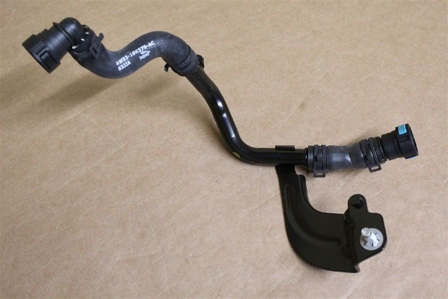

Here is the assembly;
This is a hack suggestion so maybe a last ditch attempt? I see that it is a steel tube with 2 small rubber hoses attached by clamps. I would disassemble the clamps and get the 2 hose out. Then look for a hose that you could substitute? Sometimes not as easy as it sounds either!
When I get into engine swaps there is often no stock hoses that fit. I go down to the local parts store and see if they will let me look at all the cooling hoses they have hanging up. Most parts stores have dozens. I have also used heat to attempt to mould a straight hose into position. Take a look at how much room you have. Sometimes I will replace a complex hose with a single straight hose that curves into position.
You also could eliminate everything between the two end connections and replace the whole thing with a single rubber hose? Simplify the entire assembly?

Old post but wanted to post back a FAR better repair instead of the C2D5710 that has the metal bracket and bolt that's way too hard to get in and out. I have done it twice now but with what I now know I would get this part instead as it's about 1/3 the price and has no metal bracket or bolt. Much easier to get in and out. Old part about $150. New part about $60.
Thanks again for the forum member who posted this as it's a real improvement!
