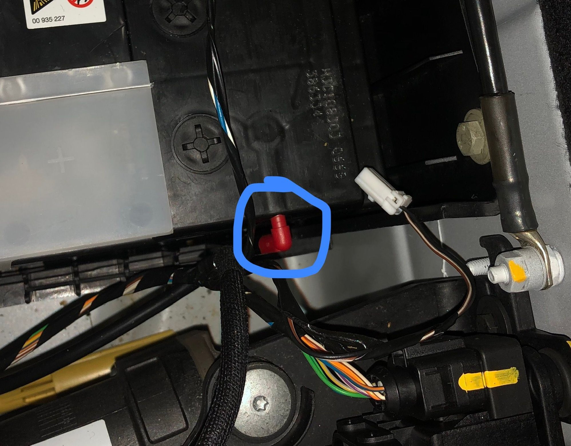

I was about to change to my new battery today but I saw this red cable connection. The new battery doesn’t have a port for it except a small hole that just looks like a hole and nothing else. So what should I do?
That‘s not a cable but the battery vent tube.
Just unplug it and plug it into the similar hole of the new battery.
Aha, I get it. I appreciate the help.
