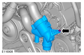

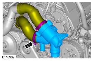

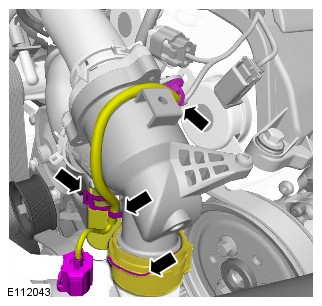

Does this help?
  1. Some variation in the illustrations may occur, but the essential information is always correct.
  2. NOTE:Some variation in the illustrations may occur, but the essential information is always correct.
    Torque: 10Nm
  3. NOTES:
    • Some variation in the illustrations may occur, but the essential information is always correct.
    • The retaining clips cannot be removed from the pipe.

Thank for the pictures, that was helpful.
To separate the plastic lower radiator hose connector, just required a little bit of bravery and about three light taps with a hammer and a wrapped flat head screwdriver on the edge, that was enough to break it free that I couldn't do by just pulling. It slides straight up and down, no twisting, just for the record in case anyone needs this in the future.
