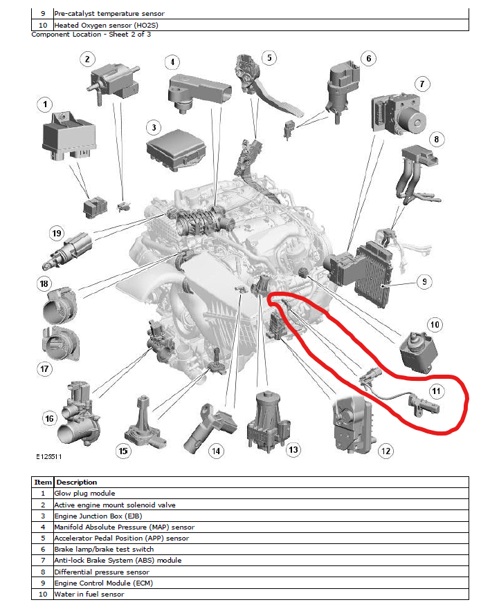

My plan is to change the sensor as per X351 - XJ Workshop Manual 2010 to 2012 TDV6 3.0 Liter Diesel VIN V00325 to V39426 even though my vin is ENV61497 I think the procedure is the same (if not please help me out with the 2014 Manual)

The AJD-V6 3.0l Diesel blocks are all same from 2010->
Sensor is reading signal from magnetic ring mounted on flange of flywheel mount.
This type of sensors are extremely reliable, so i would also check the cabling/connectors. Specially because you wrote that you got sympthons when you put gear in reverse -> engine nudges -> sounds wiring or connector.
