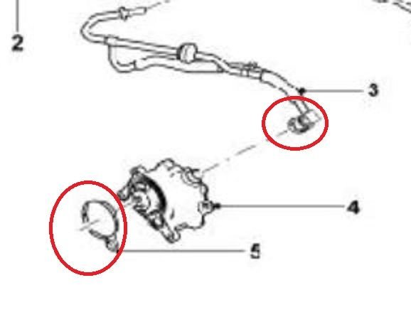

Take a look at the vacuum pump and check for oil. If the gasket is leaking you usually will also have an oil leak at that spot.
Here is a picture from JPART.
#5 is the gasket and what the diagram does not show is the tubing/hose that connects to the pump #3 has an internal O-ring that JLR does not service separately. But people have removed it and matched the O-ring up.
On the V-8's removing the pump will cause you to lose some engine oil. If you park with the front of the car raised like on ramps. That helps to reduce or eliminate that. Of course you could go ahead and change oil while your in there.
I have an XJR so no experience with the 4 cylinder versions.
Let us know what you find.
It really helps the next guy out!
OK, thank you for that - very informative. I went back to the tech and he said it was definitely the vacuum pump, as he said when he disconnected the pump it did not make the right noise that it then should. Now that is hardly definitive I know, but I am in a very remote region that has as many techs as your average African country... So the good tech flies in next week and then we will see.
