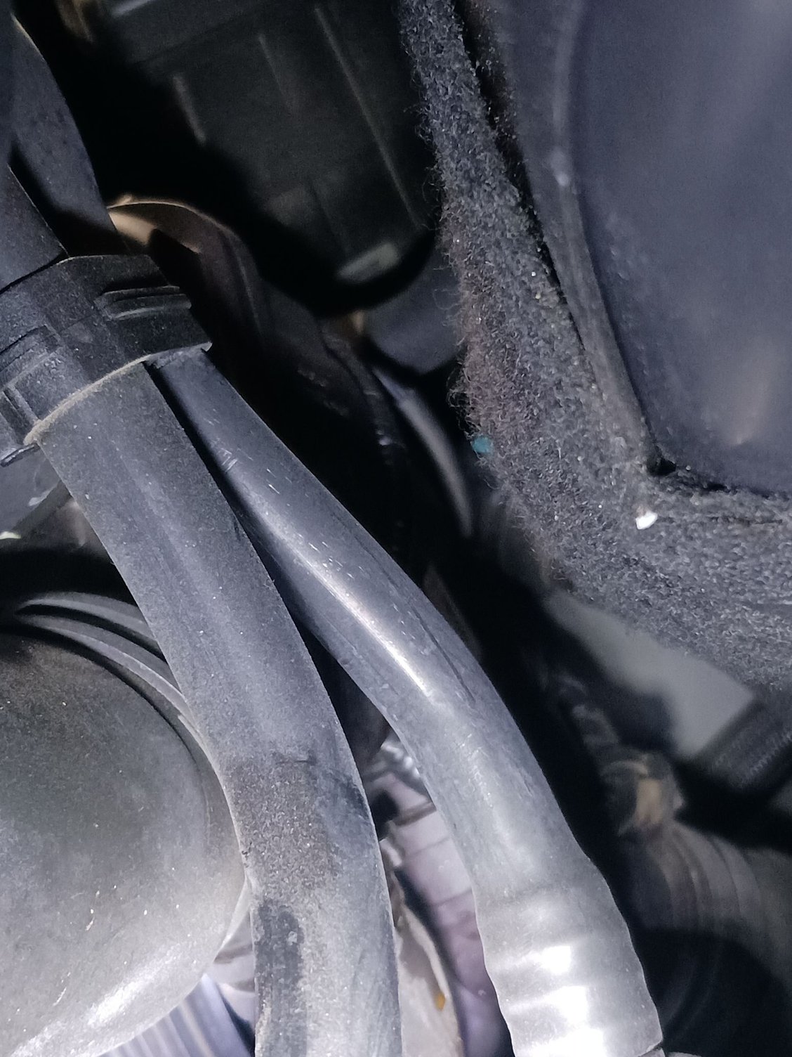

Coolant is leaking 6 months after the tank was replaced! I had to top it off to the full line again this morning. 2nd time in a week. It's apparently from a hose on the front driver's side *(right side looking from front of the car) not a "gusher".
