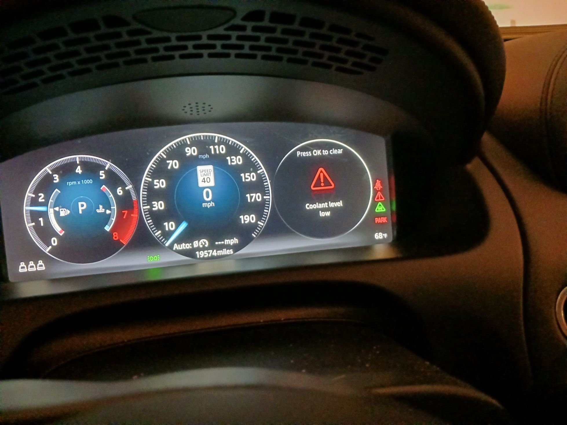

I live in the U.S. I have a 2013 XJ. 3.0, recently my coolant level light came on, i topped it off and a few weeks later it came on again. I topped it off again. I am not seeing any coolant on the ground and i don't see any evidence of a leak, and the car is not running hot. Coolant has got to be going somewhere, right? I have checked my oil and coolant caps. I don't smell or see anything weird. Anyone know what's going on?

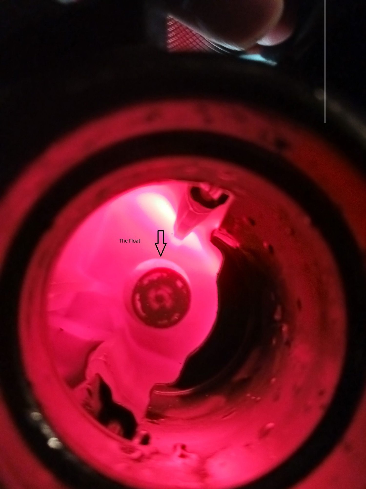

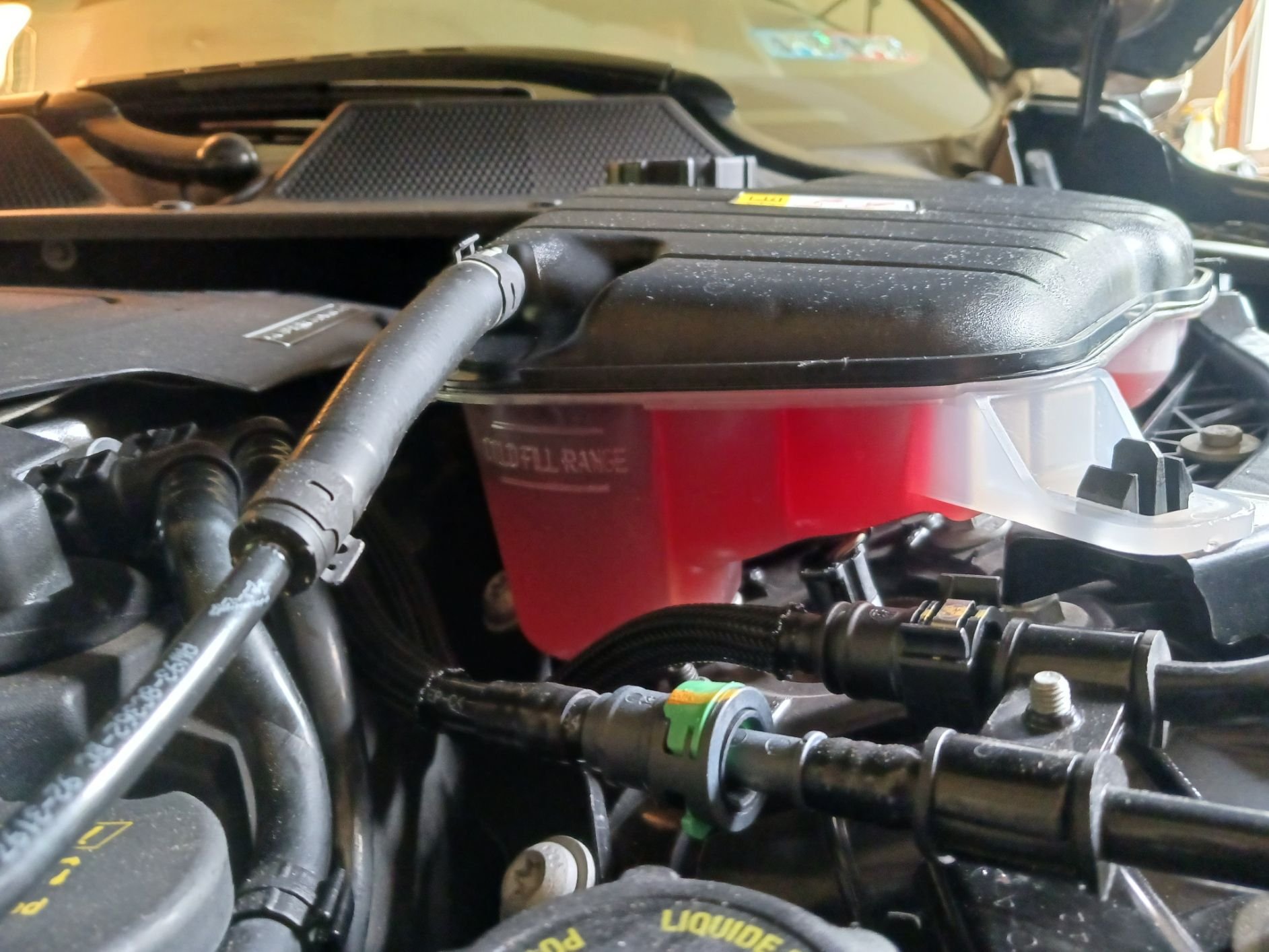

It's "something else".
I had the same issue. In the morning, with a cold engine at start up, the warning light would go on. It turned out there was a float in the expansion tank that was failing. It would sink when the coolant was cold and "float" when it was hot.
The float.
The tank with the float inside, needs to be replaced.

Yes. We couldn't find any leaks at all. My 2019 XJL had under 20,000 miles on it at the time.
