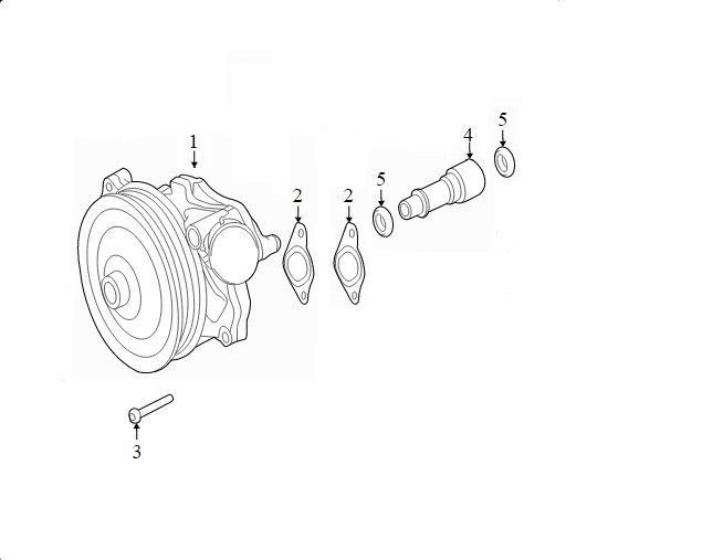

I need help. what could that be. Water pump is new.

V8,
When you changed your pump did you also change parts 4 and 5?

Posts: 7
From: Mannheim
Yes, was also changed.

V8,
I had the same problem.
when you fitted the new pump were you careful about getting the pipe in the back seated properly?
when i fitted mine the first time i missaligned the pump and pushed the pipe to one side so had the same water flow you are seeing.
just to check you changed 2 O rings
hate to say it but you will have to pull the pump off again and check.

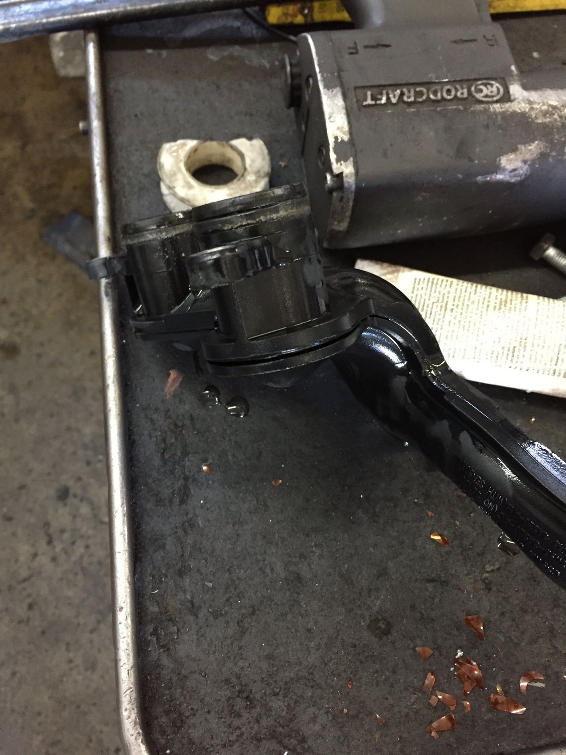

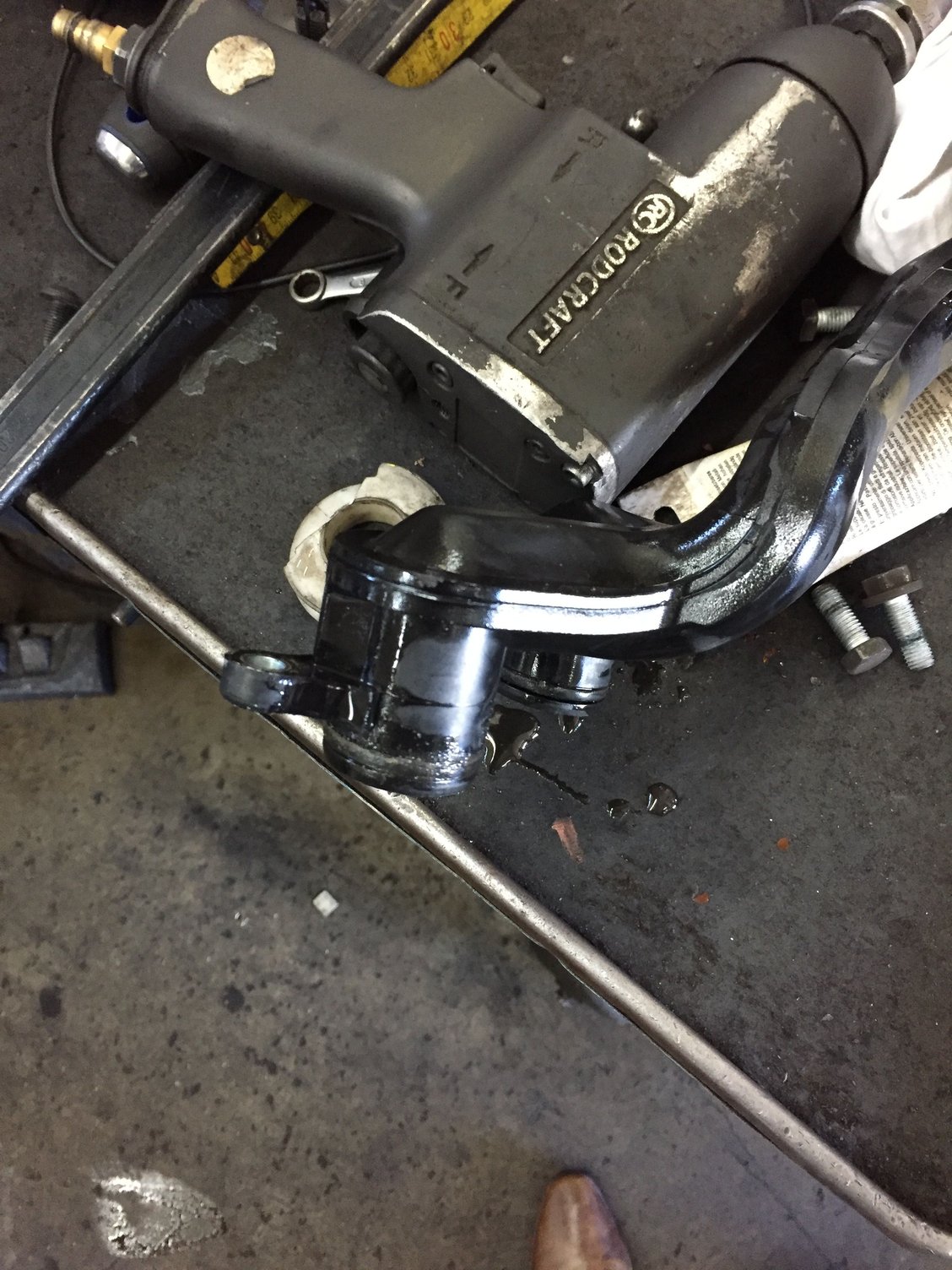

Today I got a picture of the workshop outlet pipe was broken.
Old Jun 20, 2017 | 12:48 AM
V8 Power's Avatar
Joined: Jun 2017
Posts: 7
From: Mannheim
So guys he's running again
