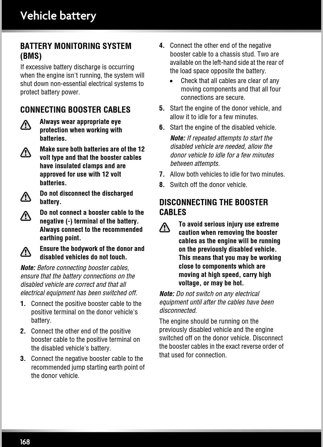

Donm, the car is in the boot/trunk of the car on the right side. If you open the hood of the car, there are jumper points there that you can connect a battery charger to. I use these points to power my vacuum pump when changing my oil.

im looking for the positive post under the hood for attaching a charger but none insight. Looked in the fuse box as there was a battery + symbol on its cover.
any clues for me, 2011 XJL, v8

It's under the hood closer to the passenger side. It'd be the upper left corner if your standing in front of the vehicle with the hood open. If I remember correctly, I think there's a small plastic piece that needs to be removed. The posts should be underneath it. Take a closer look at that area. It'll jump out at you.
