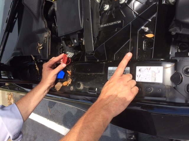

Open the hood and remove the fuse box cover. Attach a positive lead to the vertical tab by the fuse, and connect a negative lead to the threaded stud below the box (there should be a label that shows you where it is, but you can use any ground stud). You should now be able to press the trunk release button.

Perhaps I can make a contribution by showing a picture of the connections. Left finger grasping the positive connection. You'll also see the removed red cap. Right finger points to the place to attach the ground (next to the leaf) Baker Jaguar in Charleston SC was a big help in my understanding what is involved and now it seems simple to me.
