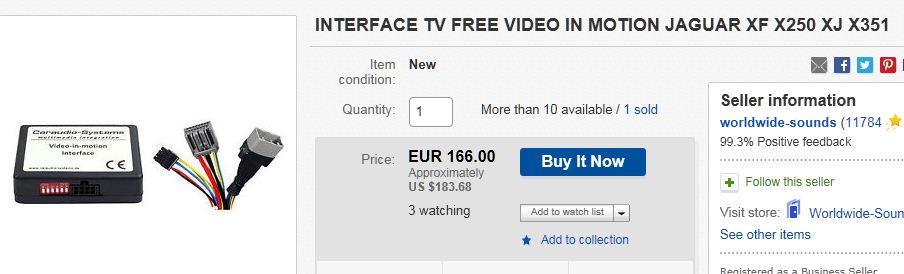

I have Video-In-Motion on my XJ...The wife loves it.
File Type: pdf
