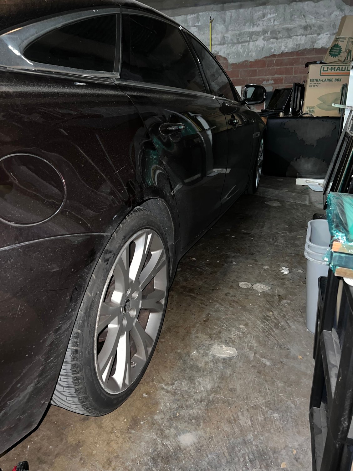

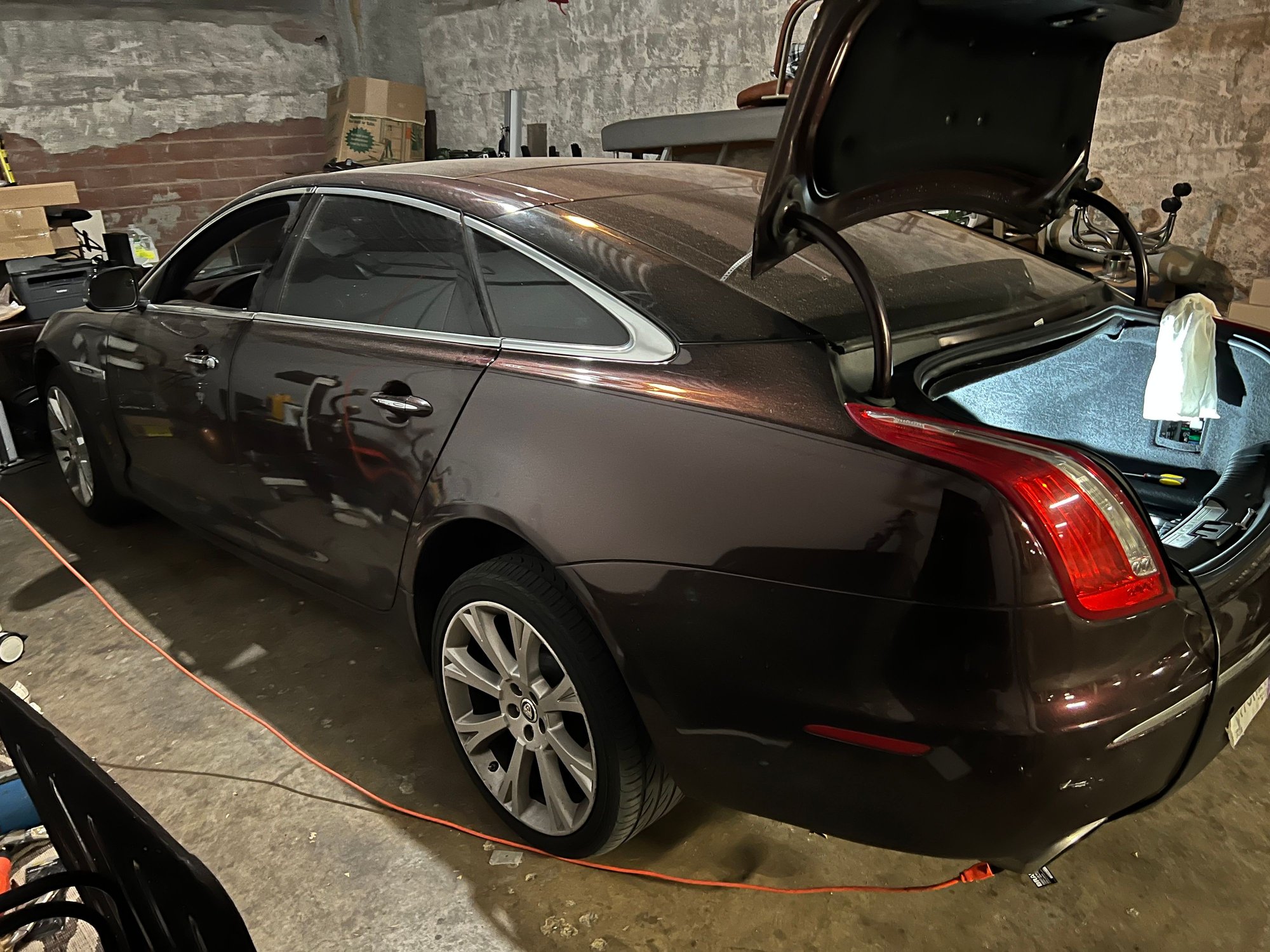

So, I go to work and come home for lunch and car is sitting fine. Come out to go back to work and the driver rear air suspension is fully inflated! This is of course really dropping the passenger side of the car front and back.
I get in and it up road to frontage road to get to higher mph. Turn around and come back home. No change. Driver side feels like no suspension at all- very rigid and passenger rear offers no support at all.
So, recent history is that I had front tire replaced and discount tire used a floor jack out in parking lot. I didn’t have a suspension codes before that, but after I did have suspension fault & adaptive dynamics fault, but car drove normally.

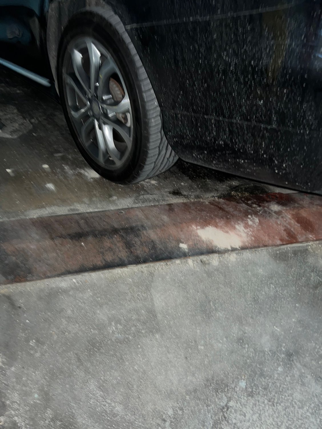

When I parked, the front passenger tire was up on this metal plate that may have been two inches tall. Seemed negligible to me. I didn’t hit any pot holes, or anything like that. Now, the weird thing is that when I started the car, the suspension fault and adaptive dynamics fault were and are still gone and while driving it, I noticed this odd beep approx every fifteen seconds while checking to see if it would balance itself out. How could the codes have disappeared?

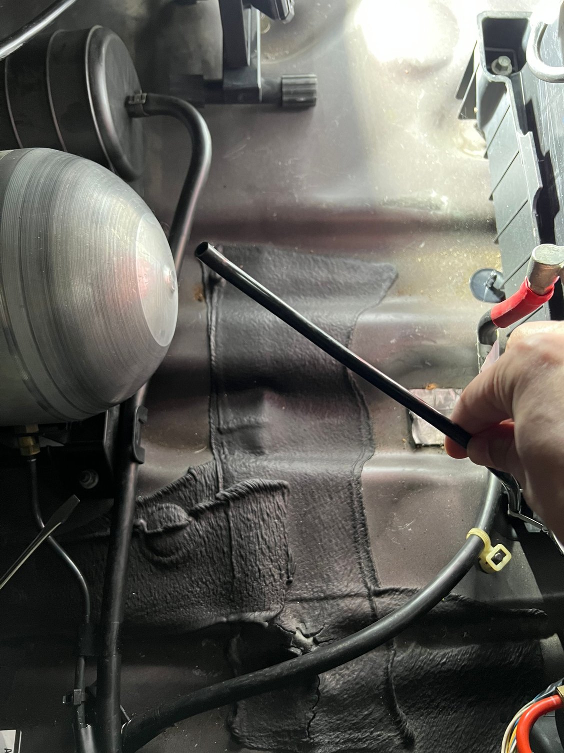

Oh and this hose comes from trunk floor, but isn’t connected anywhere. I don’t know what it is.

I see your left rear is higher than your right rear, so I imagine there was a difference before. Whatever reason it's now exacerbated.
