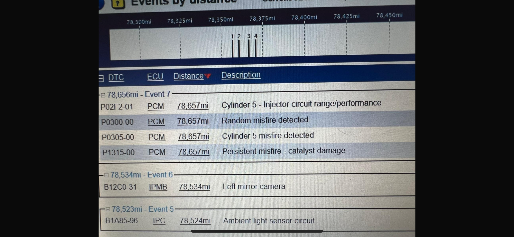

Can you post pictures of the injectors you installed? We need the lettering at the top of the injector. Need to make sure they are not counterfeit. Where did you purchase them from?
Do you still have the stock OEM ones you removed?
Generally it's best to replace all 4 injectors on that side of the engine.
If you suspect the head gasket it's simple to test the coolant for combustion gases. The kits run about $40 or so.
How does the oil look? Maybe suck a small sample out and check?
Your symptoms don't point to head gaskets but who knows?
Can you post the codes?
so I already feel for the fake injectors and got my money back I got the Bosch ones that I paid up for with the circle H and all the other exact holograms in every spot as the ones I took out. did extensive reading into that so these are 100% authentic this time. So I did replace all 4 of them on bank 1 there. And if they were fake I’d think 1&7 would start having issues also along with 3&5. Unfortunately didn’t take any pics but they are real and I got my money back on the first batch. I’ve not looked at the oil but I guess I can. I doubt it’s a head gasket but who knows.

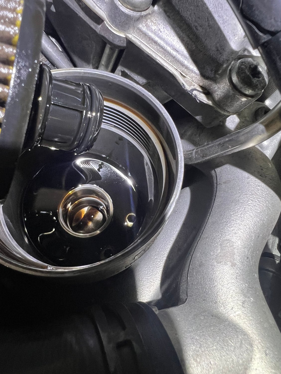

Oil appears normal and fine to me

Oil doesn't tell the whole story unfortunately, you can have an internal headgasket leak in the water jacket that doesn't affect any of the oil galleries. Coolant test for hydrocarbons as mentioned above would confirm that.
Have you tested compression in cylinders 3 and 5? Have you tested your coils for proper resistance values? If you pull out the spark plugs are they wet with fuel or completely dry e.g. is an injector stuck closed? Are your spark plugs gapped correctly? Are your engine to body grounds properly connected? You didn't smear dielectric grease on the head of the spark plug before reinstalling the coils did you? There is a common misconception that dielectric grease promotes conduction, but it is quite the opposite. It is an insulator.
