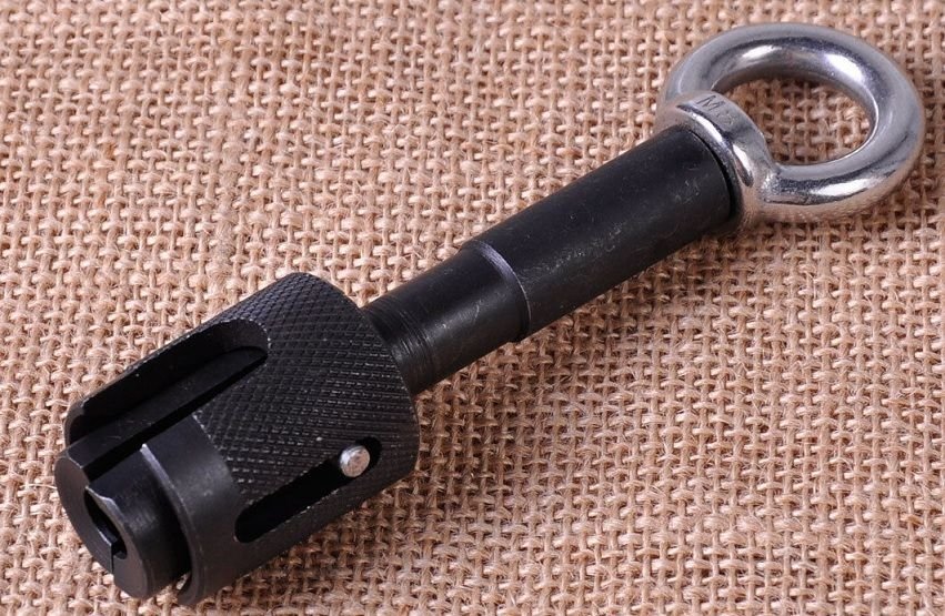

Now again there are 2 types of pullers. If you already have a slide hammer which most mechanics do then you can use a small adapter that is cheaper than buying an entire slide hammer! Looks like this and it's not talked about on the forum and I don't know why?
Around $25
Injector Pulling Adapter

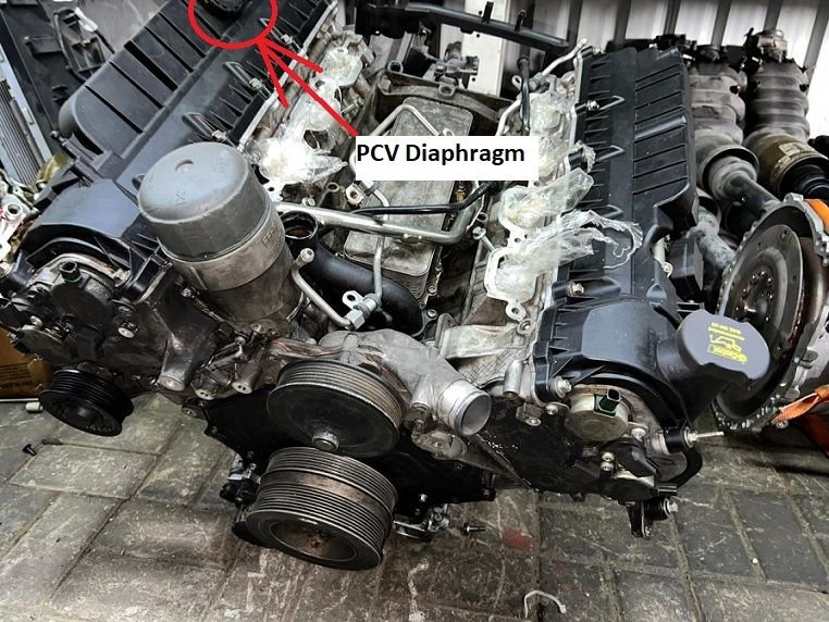

Consider changing the PCV diaphragms since the engine is this far torn down. You can barely see it in your picture too. Pretty cheap and real easy to replace with the engine torn down. No special tools required on this item.
Are you going back with plastic cooling pipes or the great Aluminum ones in the after market?
