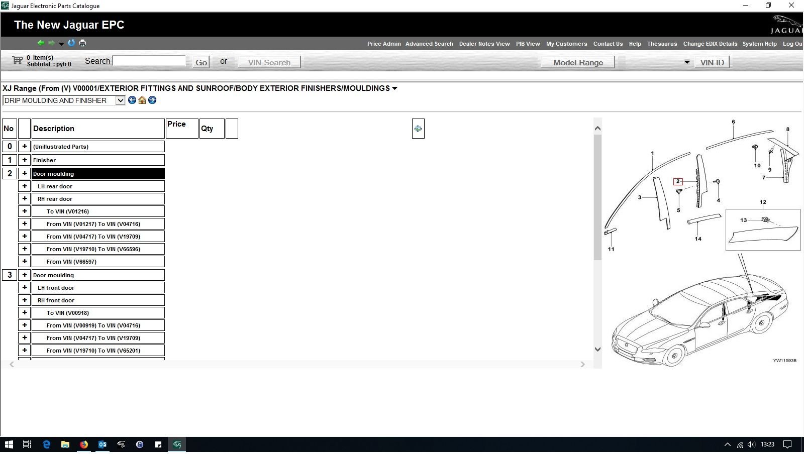

The trim looks to be the Door Moulding (see items 2 and 3):
Several Part Number changes with VIN range. The early ones appear to be:
RH Rear Door: C2D16615
RH Front Door: C2D19646

Thanks Graham! It's actually the opposite side to that shown, but am I right in thinking parts 2 and 3 are mirror images of each other so they will fit both sides of the car? The last 6 of the VIN are V11135.
Old Jul 30, 2018 | 08:26 AM
There's different P/N's for LH and RH so even though they are mirror image, they can't be interchangeable. Here's the LH moulding P/N's for your VIN:
A rotating arrows symbol indicates the part has been superseded. E.g. the original LH Rear moulding C2D16616 for your vehicle has been superseded by C2D19651 from the later VIN range.
