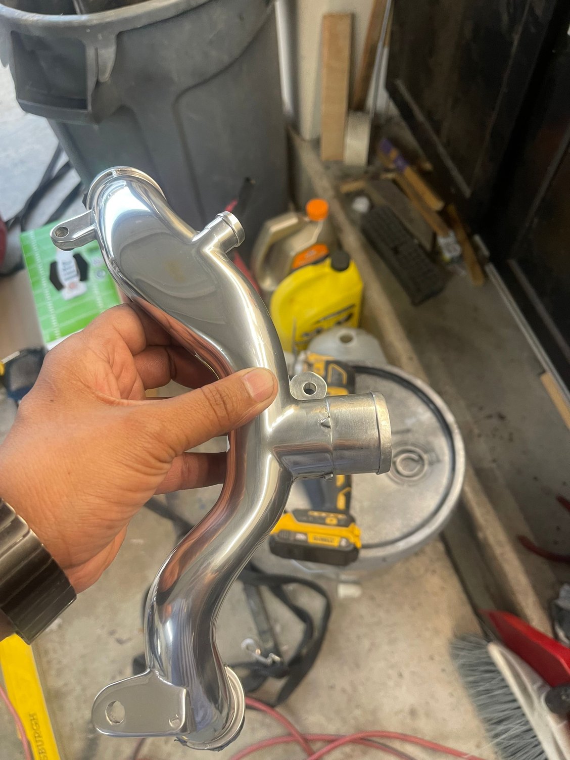

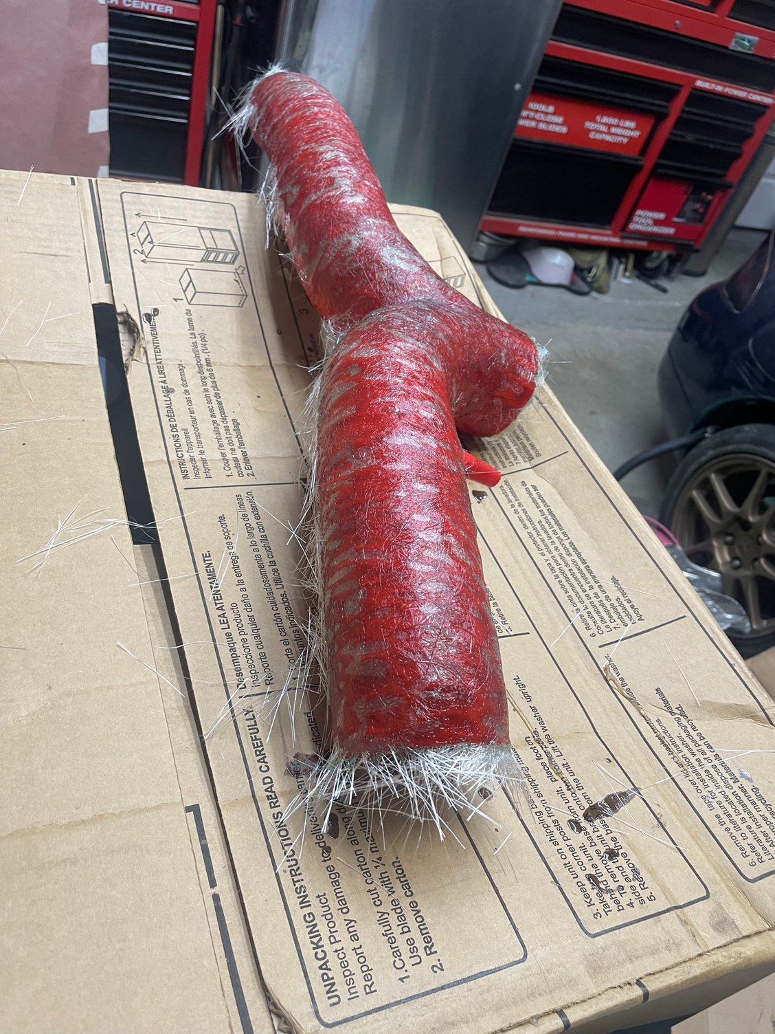

Hello all, I have read multiple threads regarding what type of oils we can use but this is what I have access to near me, can I use any of this oils in my car? Please see pictures.
Also, I need to jack up the rear, is it safe to jack it up, or do I need to turn off the air suspension and if so, how do I do that? I owned a Lincoln Continental and it had a switch in the trunk to turn off the compressor. Wondering if is the same thing. Thanks in advance.

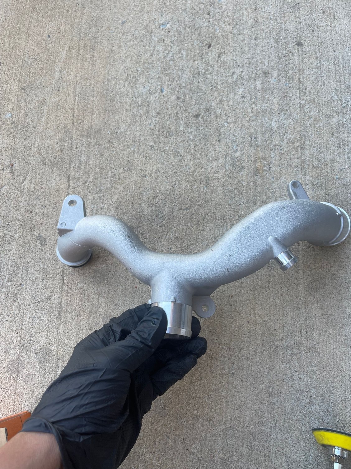

Im also replacing my plastic coolant pipes with the aluminum ones, wish me luck. I hope I dont run into too much trouble.
Thank you all for the help, Please see pictures. My car is a 2014 XJ 5.0 supercharged.

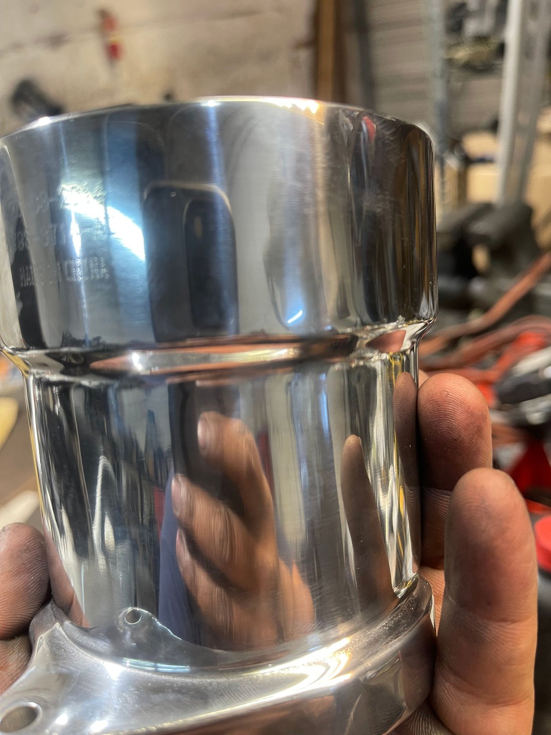

LOVE the polished pipes! I'm doing this upgrade to my car soon and was thinking about doing the same thing, great to see how they look when done! I can't wait to see photos of them in the car.
If you haven't already, it can be a good idea to clear coat aluminium after polishing as it tends to oxidise quickly and go cloudy. You need to clean the surface REALLY well first, but if you make a mistake you can always sand it back and try again

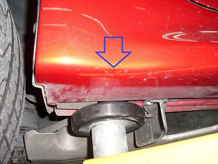

Don't know if your aware but Jaguar puts arrows molded into the plastic side skirts to indicate where to jack the car up. I could not see them as they are not obvious but they are there!
Attached are the jacking instructions from the owners manual. It's a bit strange because they show 4 lifting points but if you jack up the car at those spots where do you place the jack stands? You have no place because the jack is in the way?
How I get around that is to drive the front of the car up on ramps first. Then jack at the large "banana" arm until I can place a jack stand in the right spot. Not correct but I don't know anyway to do it?
Listen to Vasara as Jaguar specifically says do NOT lift the car using the rear diff. I have lifted all kinds of cars this way for decades BUT Jaguar notes NOT to do this.

Hey please post back when you get those polished pipes on!
Careful as you might not stop! Have you seen the guy that took the engine cover off and polished the entire top of the SC/inter coolers?
Thank you, appreciate your time.
I will post pics once installed for sure. Just did the top one, the pipe under the SC you cant really see and got a bit busy and lazy lol.
I have not seen that guy, but I bet it looks awesome. I know what you mean, I polished a few parts from my Eclipse just because lol. Here are some pics.

It's a bit strange because they show 4 lifting points but if you jack up the car at those spots where do you place the jack stands? You have no place because the jack is in the way?.
This is a problem on so many cars these days, that I finally found a solution. I have 4 large floor jacks and I use 4 of these Jack Rods. It turns your hydraulic jacks into jack stands. You have the redundancy of the hydraulic jack mechanism and the Jack Rods.
https://agm-products.com/products/ja...saAsR9EALw_wcB
I lift the car on all 4 jacks by jacking up each corner a little at a time so I don't stress the chassis, and then put in the Jack Rods. This gives me plenty of height to work under the car.

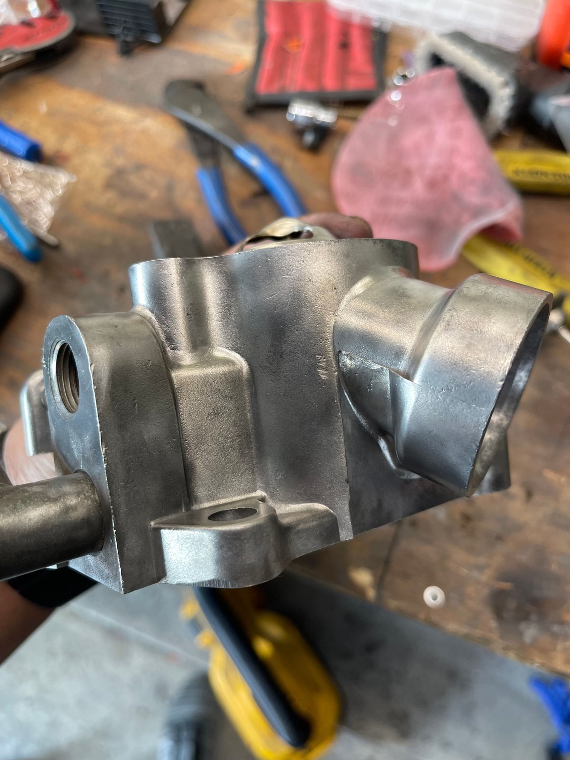

So I did I polished the oil filter housing ☺️☺️☺️

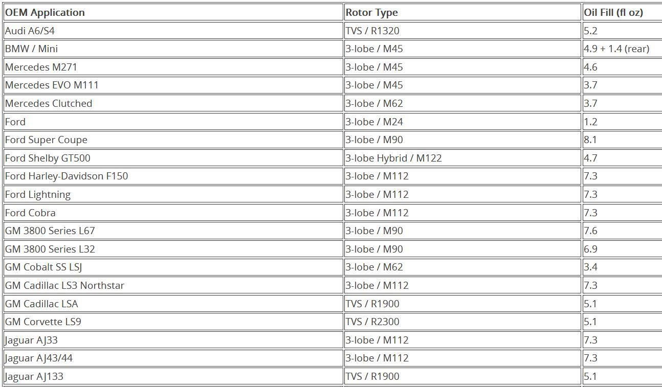

Does anybody know exactly how much oil to add to the SC?? Everyone everywhere say different things, can someone confirm please?

Well it's another one of those "things"?
Eaton in the US makes and provides Jaguar with the TVS1900 blower. Jaguar claims the fluid is "Lifetime" but as always we will need to argue about whose lifetime we are talking about? Note that Eaton says no such thing.
Here is a chart showing the amount of oil needed;
So for our TVS1900 it needs 5.1 oz. of oil.
I have seen all kinds of intervals and will say I am not exactly sure but do plan to change it. Especially if the SC has to come off for some reason.
Now we have had some very talented folks get access to the drain plug and change the fluid WITHOUT removing the SC from the engine but it is hard!
I plan to change the SC oil in my car when I get around to replacing the SC snout because it's clunking. I will be removing the SC to do that work.
Now that is pretty but you have the giant Aluminum SC/inter-cooler lid that is just begging to be polished up so you can leave the engine cover off for good!
Plus have you considered unhooking the crappy symposer stuff?
