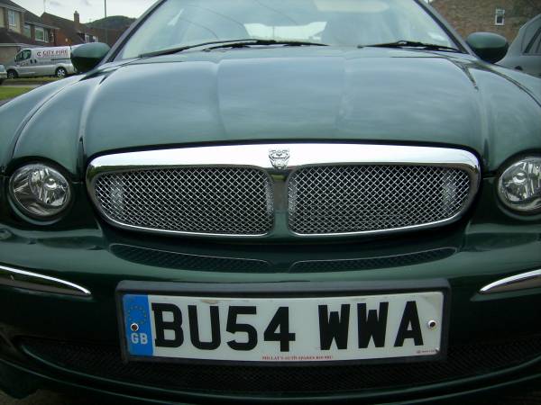

Here is a pic of my car front plate, maybe see if you can just find a part number for the fixing bracket from a UK supplier and just order it from the Uk, I will have a closer look at mine to see how it is fitted
http://i660.photobucket.com/albums/u...w/P1050930.jpg
http://i660.photobucket.com/albums/u...w/P1070344.jpg

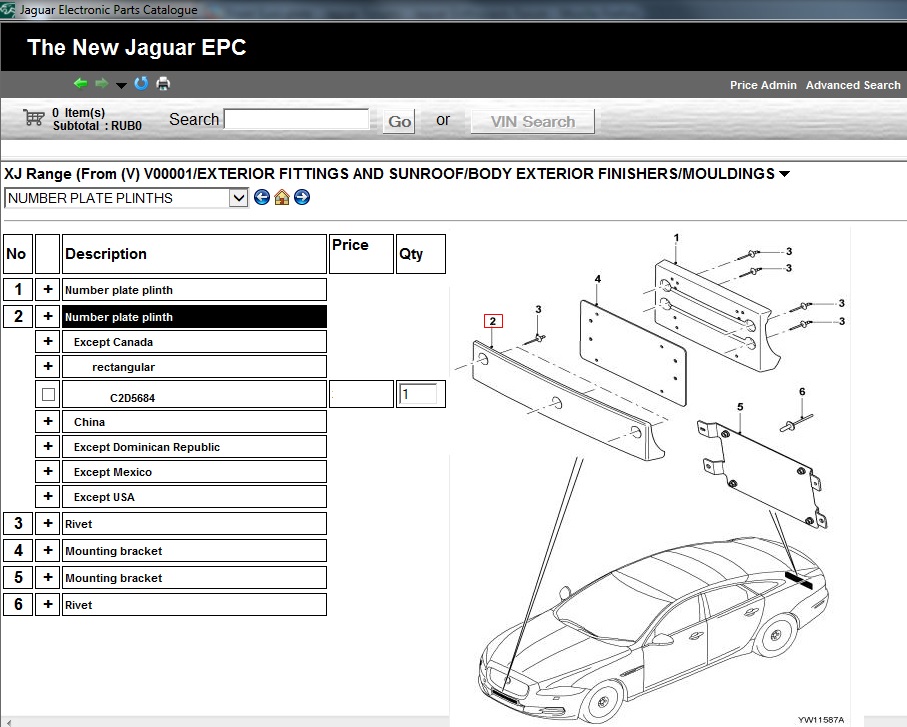

There's a black plastic moulded plinth for our Euro Plates (item 2):
It's pop riveted on.
Attachment 81230

Originally Posted by KingRT
Is this a US Dealer purchased item?
I would like to make sure it does not cover up any of the sensors.
It's a Jaguar Dealer part. There is no reason for a US dealer to carry stock so it would be special order.
Here's the standard Euro Plinth on my XK. Dimensions are 520mm x 110mm.
As you can see, it's completely clear of the front parking aid sensors (arrowed in red). Although I haven't had an XJ since the X308, there's no reason to think the current XJ would be any different in having the sensor locations well away from all of the standard rectangular and square OE Jaguar plinths.

Originally Posted by roviw
I have just called the dealers and the part number is CTD 5684 .....
Typo or misheard on the phone.
P/N is C2D 5684 (dealer will be using the same Jaguar EPC as the screen print in my post #4).
