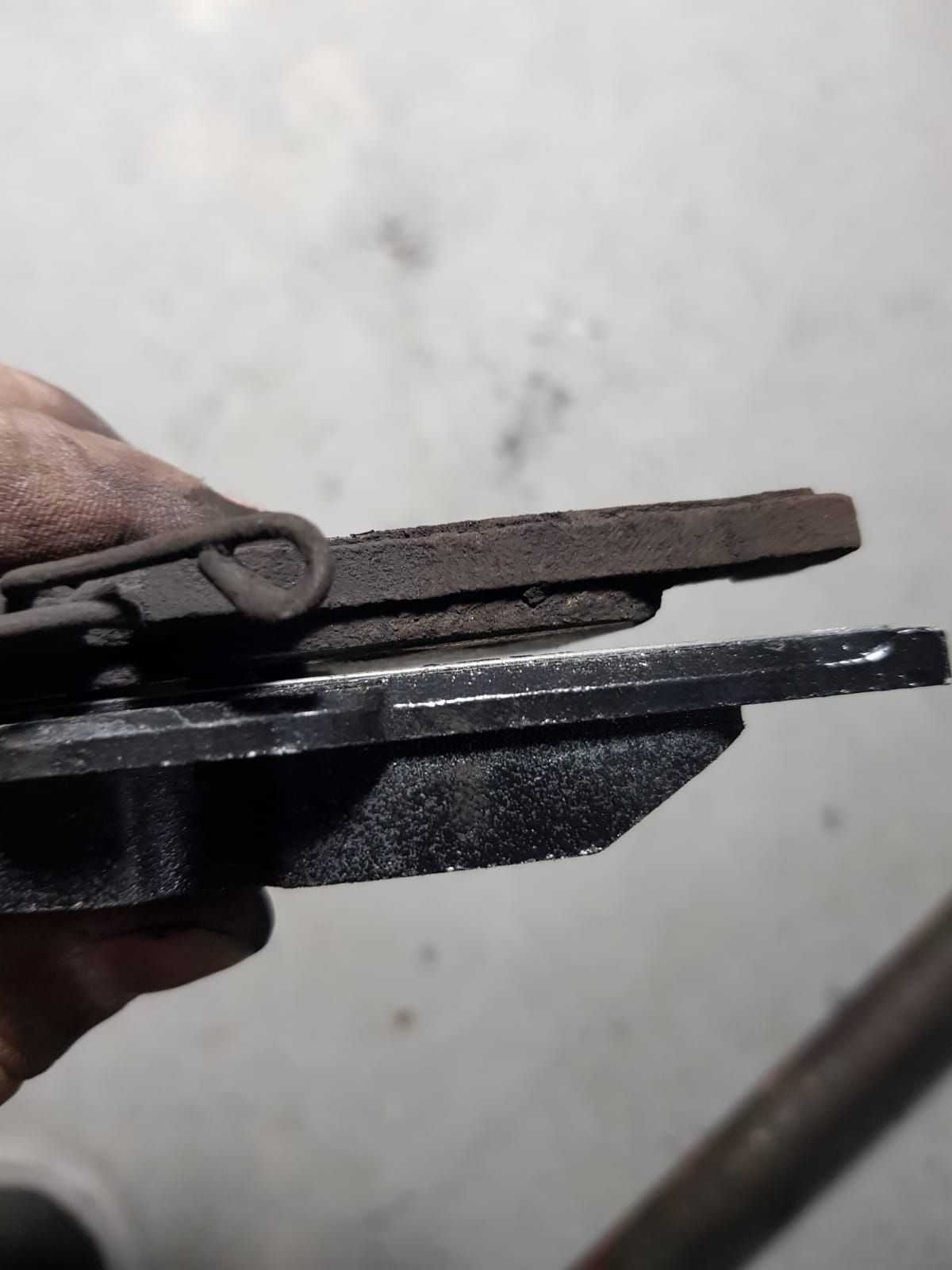

After more search i found this error for rear discs and pads. I will change it! Maybe this is. I will post the result.

The rear disk and pads are used for both regular braking and for the parking brake; they are the same. When you apply the parking brake, a cable is pulled to apply the brakes. When you press the brake pedal, pressure from the brake fluid applies the brake. But the pads and rotor used are the same.
Not sure what the picture is showing. I’d have to pull off my wheel to compare.
Did you you say you tried to reset the parking brake already? You can do it with certain scan tools or by disconnecting the battery for 20-30 seconds. Though disconnecting the battery will also require manual reset of the trunk and window positions.
Edit: Is there any brake pad material left? For the rear brakes you should be able to easily see the brake pad and how much material is left. Not sure if your camera angle is throwing me off, but I don’t see any brake pad in your picture.

You look like your brake pads are completely worn/gone. I would recommend you buy new pads at a minimum. You may also need new rear rotors. Fix the brake pads and your parking brake issue should go away.
