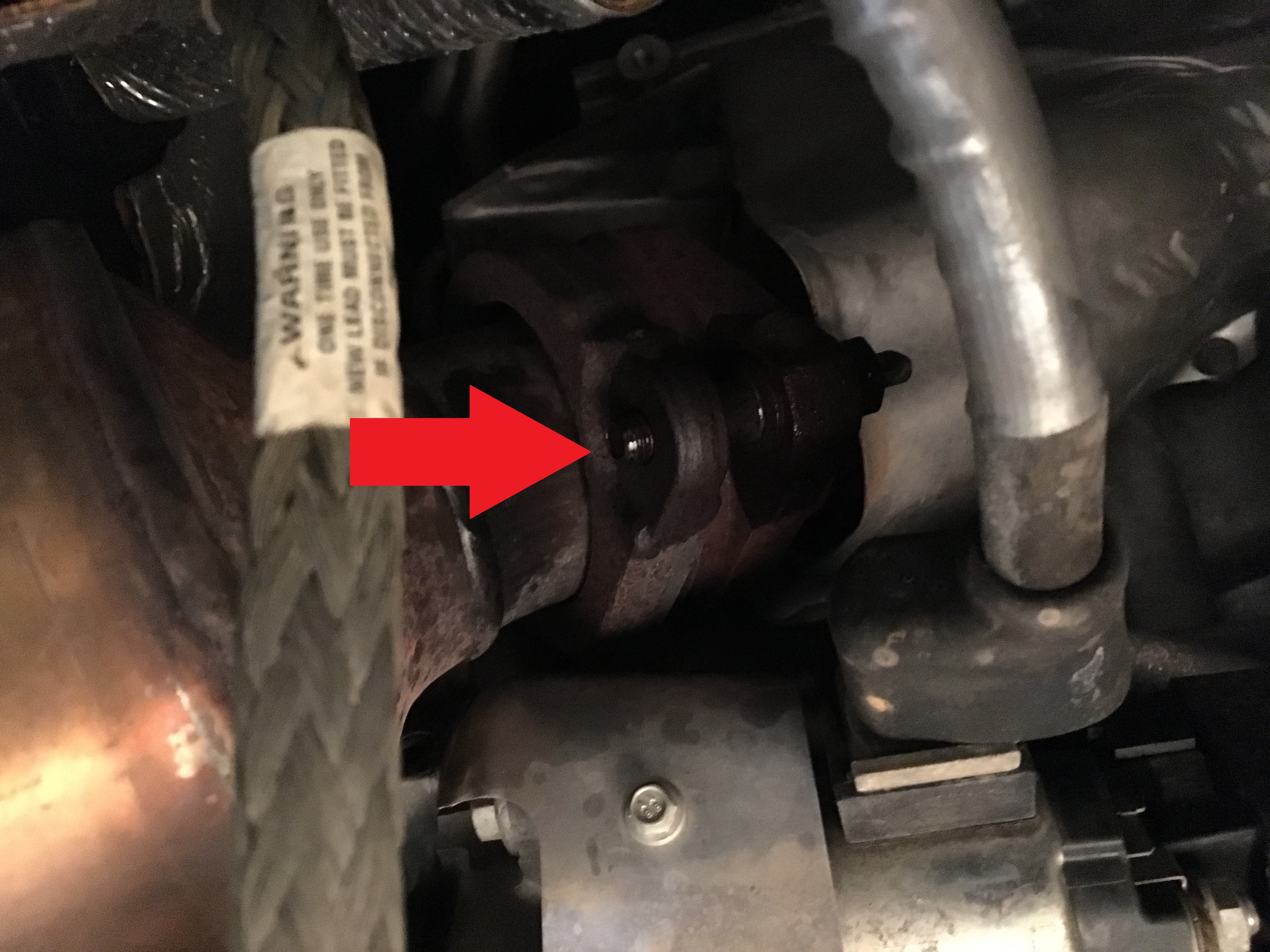

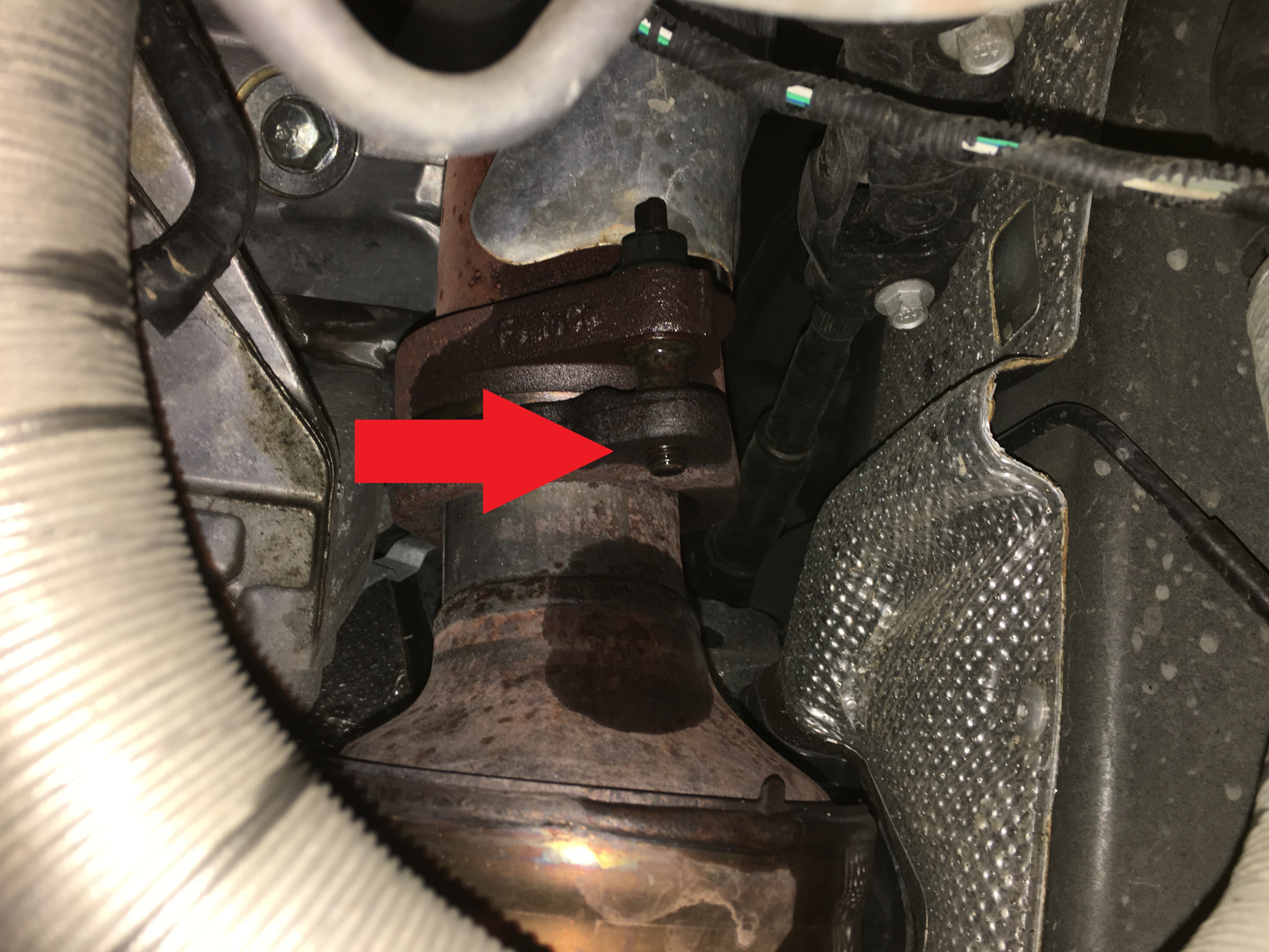

I bought the pulley and cats for my XJ SC. I planned on installing the cats this past weekend. When I got the car up on the lift and removed the underneath panel to get to the cats I realized that the 200 cell cats don't have a threaded hole like the original cats. The other side is difficult to get to, but it seems to have a nut on the converter side of the pipe.
I was just wondering the best way to tackle this....After I got it up and looked at it...I thought I will just take it to a shop. I did that Monday and they got it up and looked at it, then said they were scared to touch it and suggested I take it to an import place that specializes in luxury imports. Nothing is easy I guess. I have done full exhaust systems on my Vette and my Powerstroke...this is the first one that I am kind of stumped. I guess I was just expecting run of the mill clamps.

I installed Paramount bolt in 200 cel cats in my 2005 XJR with only minor issues.
The bolts/studs on your flange look different to mine.
