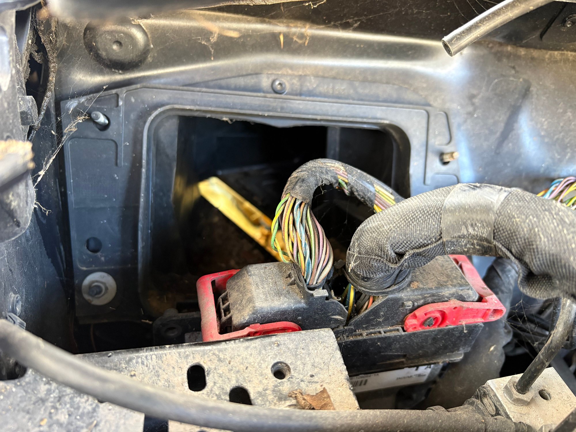

Hey what's up guys need some more assistance. Trying to find the part number for the cabin air filter cover that goes on under the hood as mine is missing and the car is flooding with water since it has been raining for days here now. I tried googling it buy I can not find anything on it.

that’s not what I’m speaking about. I’m talking about the opening under the hood.

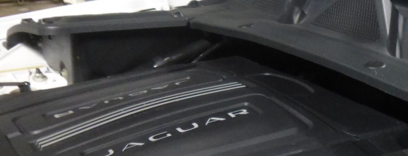

My 2014 has nothing which specifically covers that hole. It is boxed in by the cowl at the bottom of the windshield, box piece which goes around the abs pump and brake pipes, and a flat cover over the engine fuse box . If I remove the the flat cover I can see the cabin air filter.
You can see the flat piece on the upper left. you can enlarge the pic to show what I mean,

I can’t tell from your picture
is it different for super charged models.

My car is a supercharged model---that's what the silver thing on top is. I cannot send a better pic because I am 2500miles away from my car. The picture you show in post #4 is missing the bottom windshield cowl.(the big black piece running the width of the windshield in my pic )

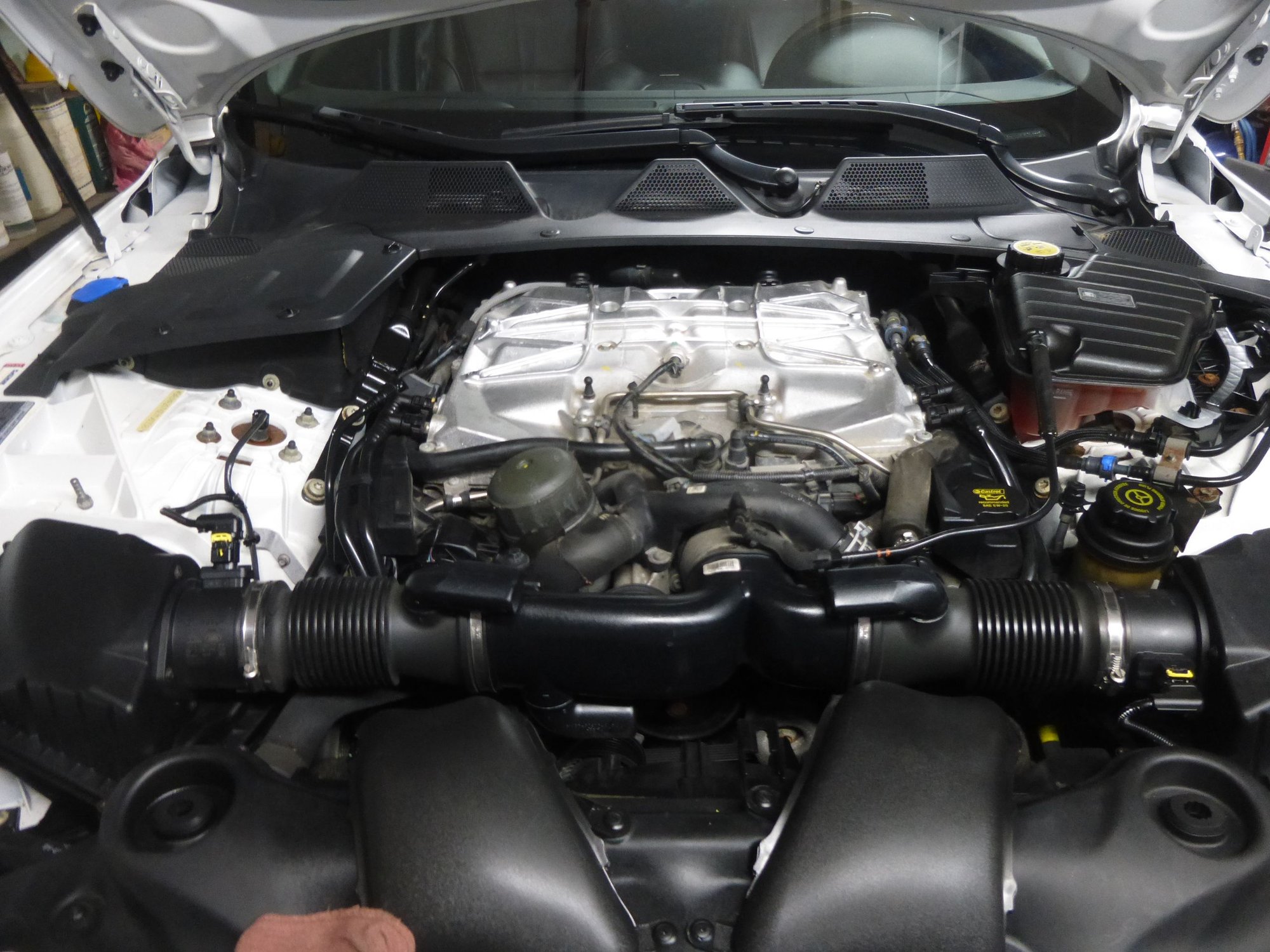

I found another pic showing covers from the drivers side if the engine..
you cand see the vertical side cover going around the engine fuse box and the top cover for same, and the bottom wind shield cover. None of these parts are in your picture
I wonder if that would fall under a fuse box cover if I look under a parts diagram

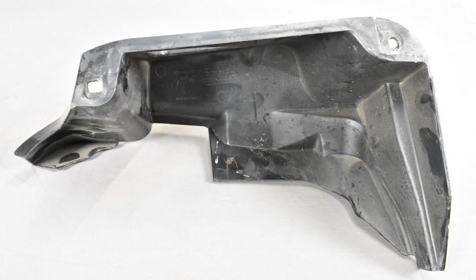

But I have found a used one for around $35!
Take a look as I think this is the right part but he has no part number. The number in the ad is what's printed on the plastic itself.
Firewall Cover Over Cabin Filter
If you do find the right part number that would be a great help!
If you can see the cabin filter with the top of that fuse box removed I think your car is missing this part.

this looks maybe right. I don’t see anything like this on my car. I just put an offer on it to order. $35 isn’t much to gamble with.

I bought the piece you linked plus the rest of the cowl for the windshield
