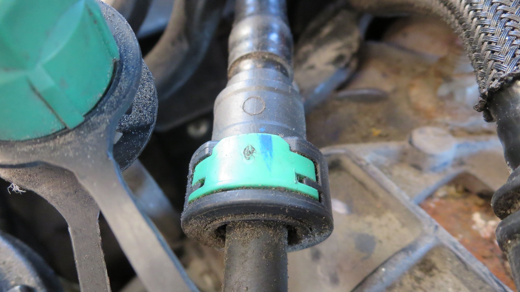

How to disconnect this green clip ??

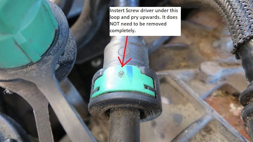

Just pry the green part straight up. Then the connection should pull apart.
Worked I got it to disconnect Thanks
Its a fuel line not a vacuum line
