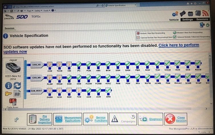

Here is a picture of my car's initial scan when first hooked up to SDD. Just as an example to give you an idea of what things look like.
Ignore the update message as I was fighting that problem when I took the picture. But the car has no red X's which is what you want to see.
But SDD has so many variations I maybe off in left field here?
