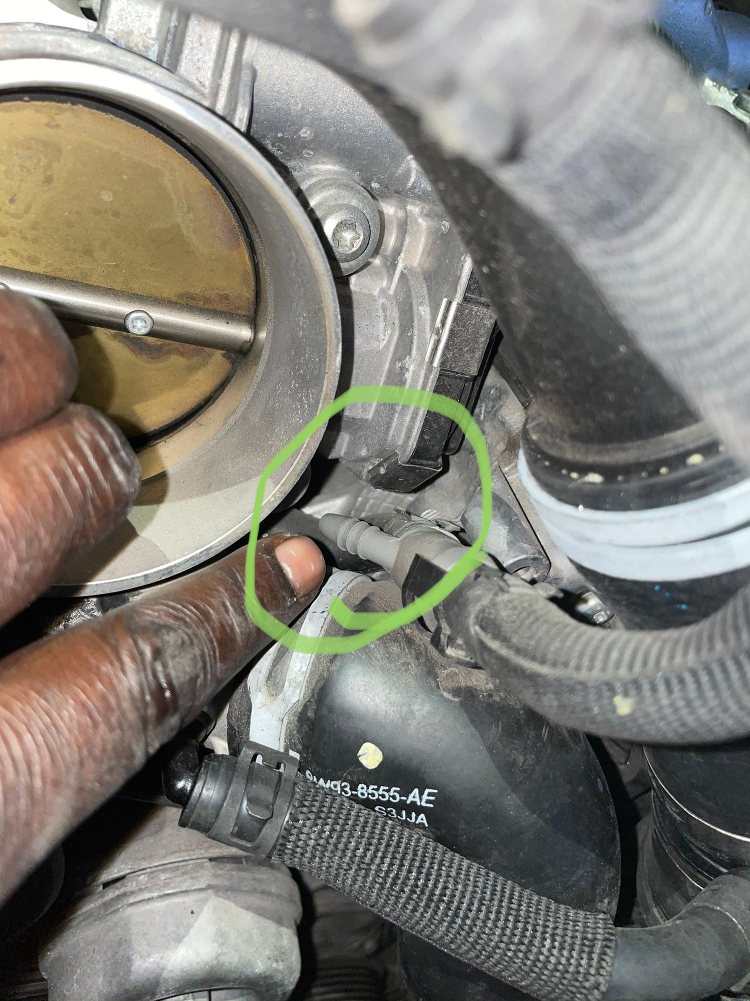

I’m looking for what goes here it’s a 2014 Jaguar XJR

What hose connects to this nipple can’t seem to find it.. any help?

Nothing. It must be an add on design for non-US markets.

As Rummy said, nothing. Browse through existing posts that ask the same question if you want good detail, but it's the product of a change in the cooling system a few years earlier. Although it looks like an open barb connection, it's not open. It's just a plugged fixture.

Looks like you have an updated tee fitting, the revised water pump routing is better it’s just that they decided to use the same tee but they don’t bore it out and keep it sealed. You are good to go.

Yes be glad it's there because that means your plastic bits have been upgraded from the factory setup and HOPEFULLY the water pump has been replaced with the latest version too.

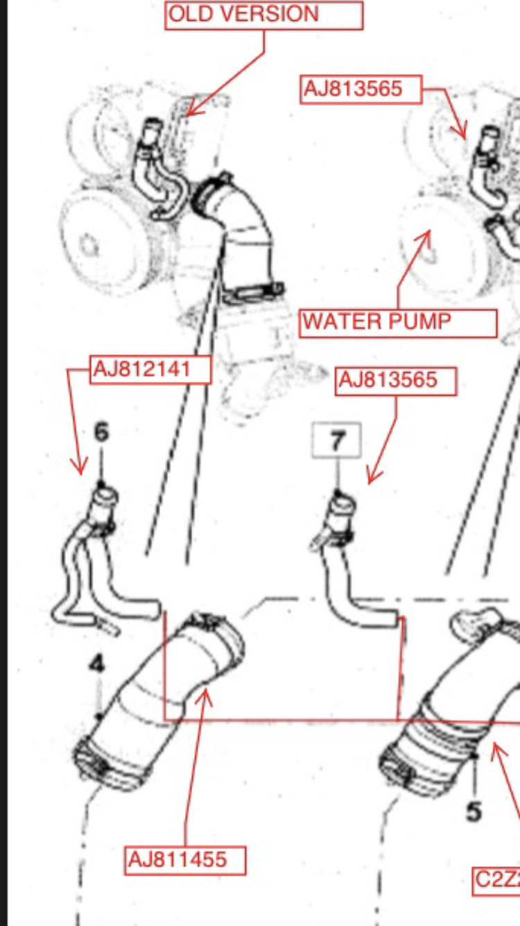

Default Need o know the part number for the "Condenser Top cooling hoses"
also I Need to know the part number for the "Condenser Top cooling hoses"
