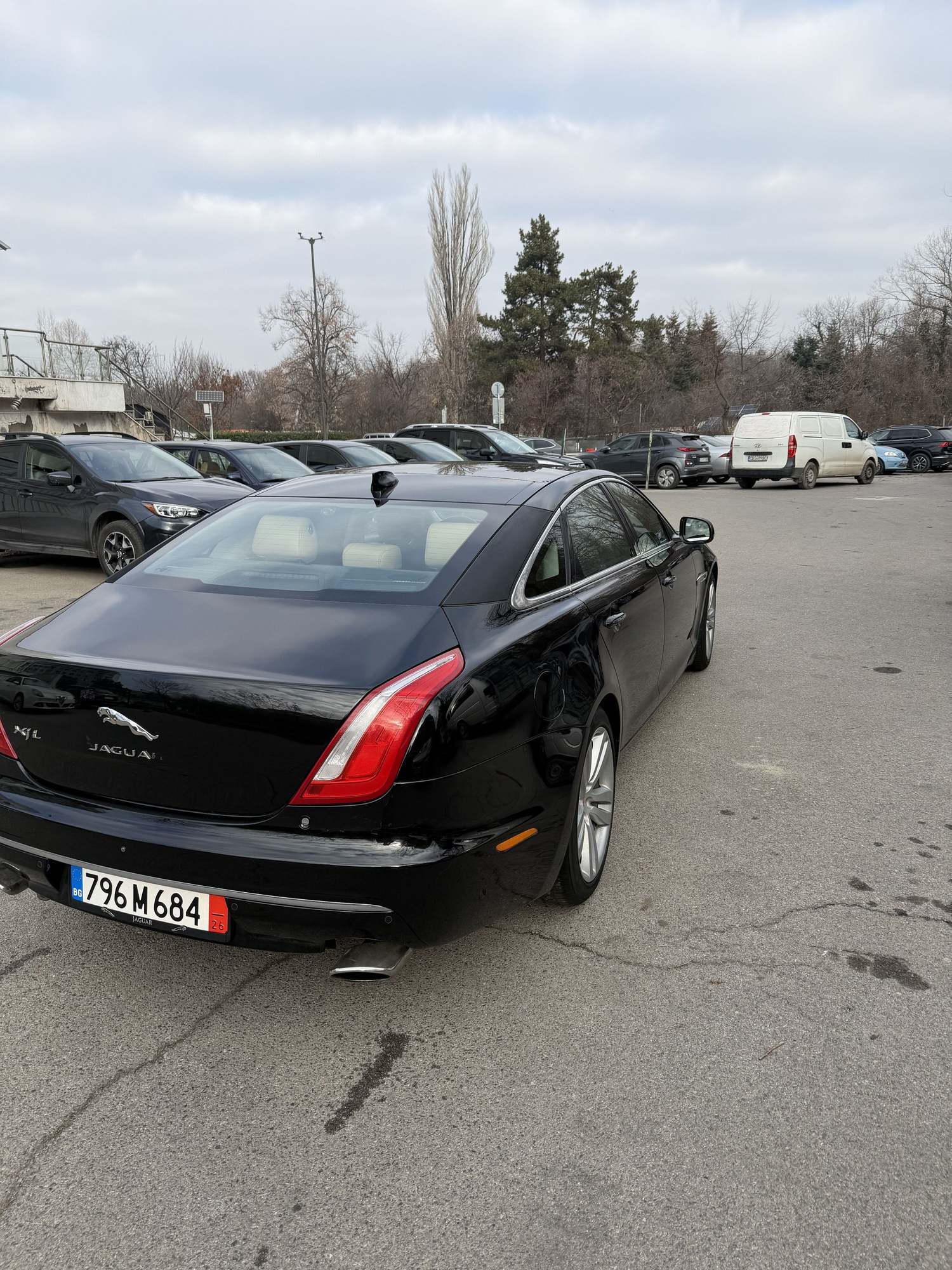

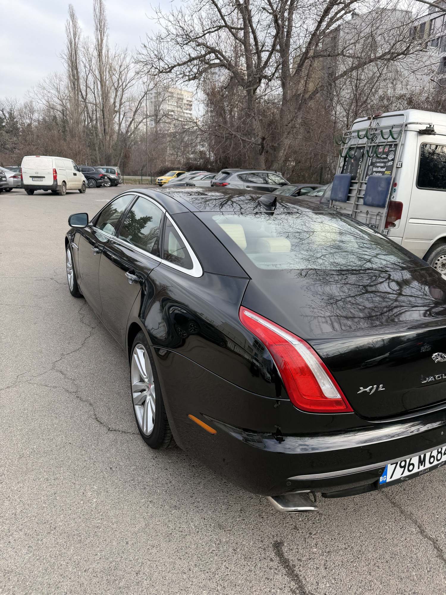

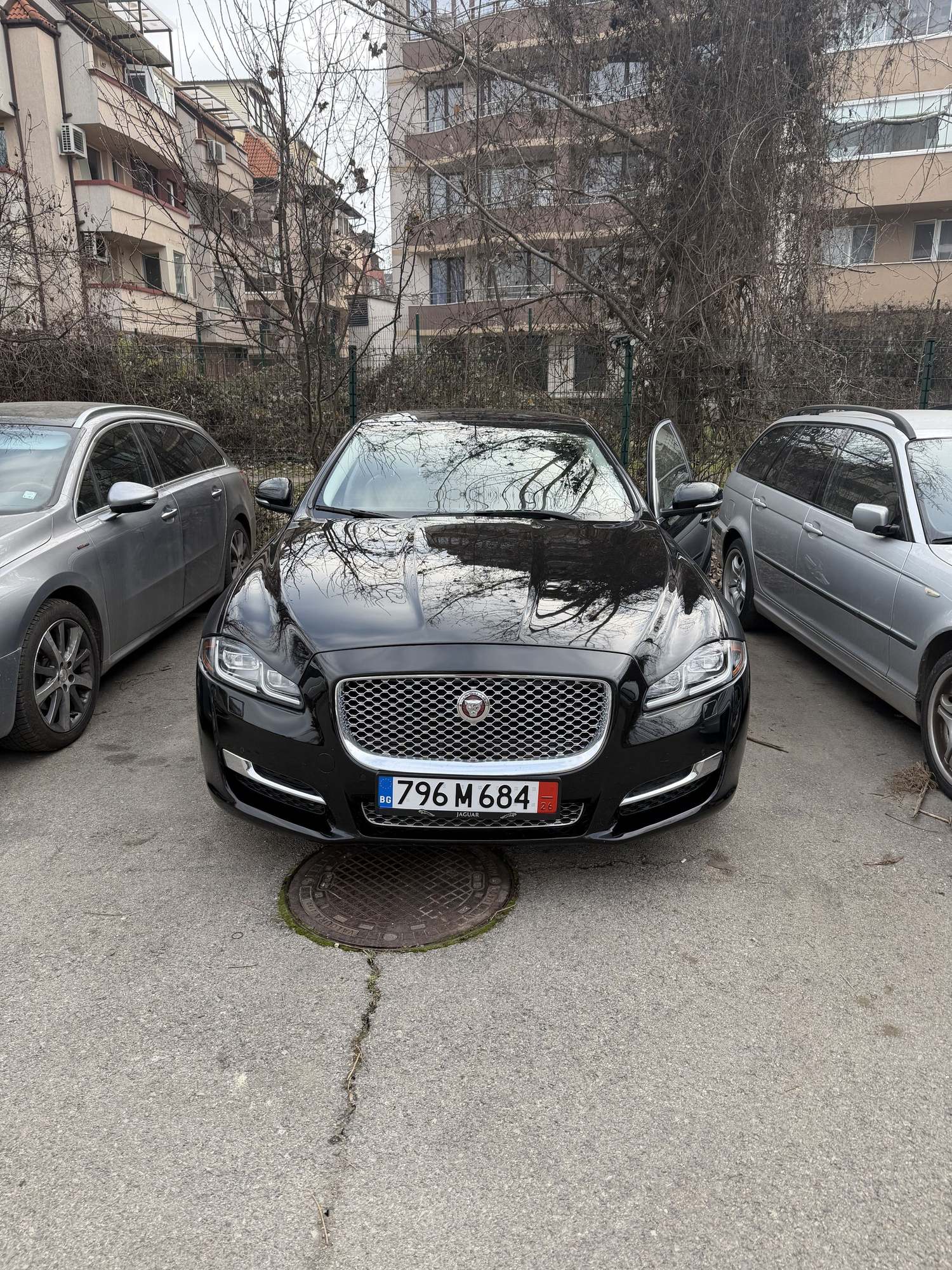

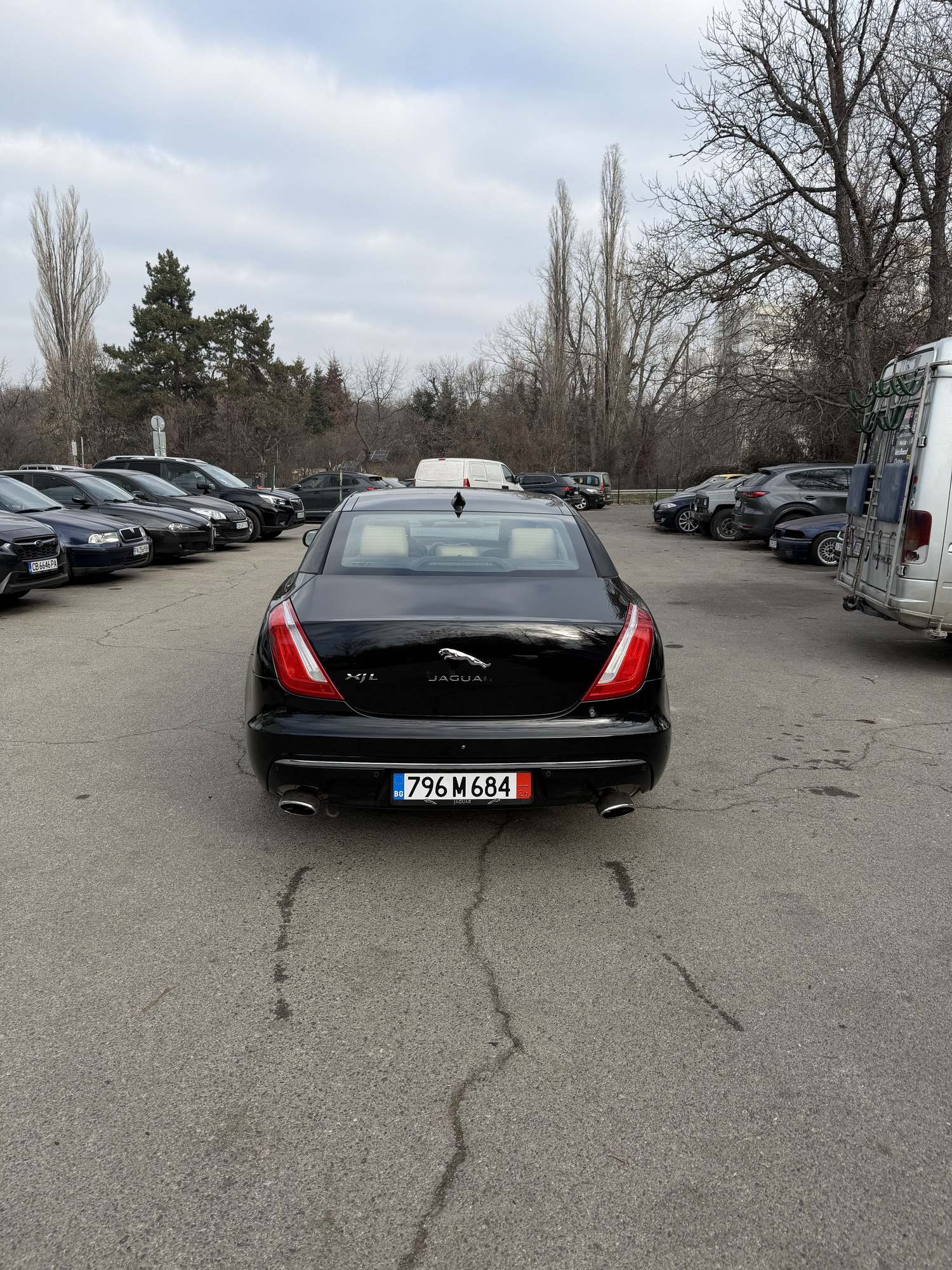

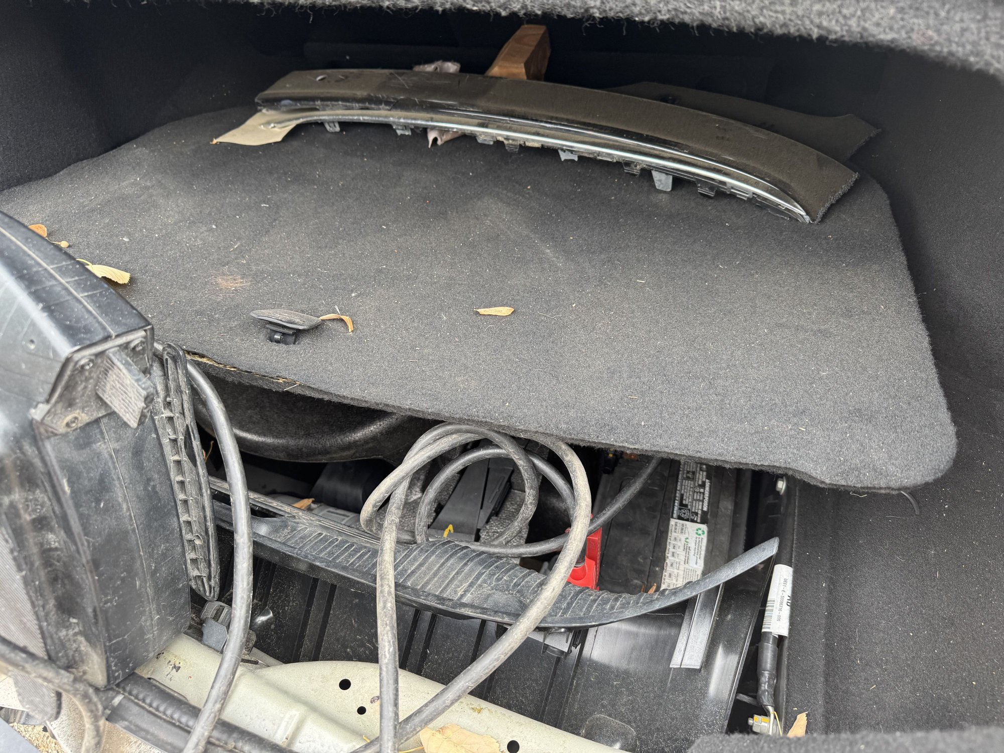

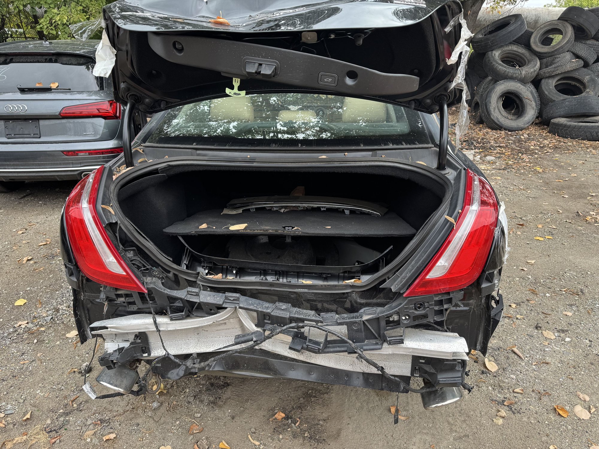

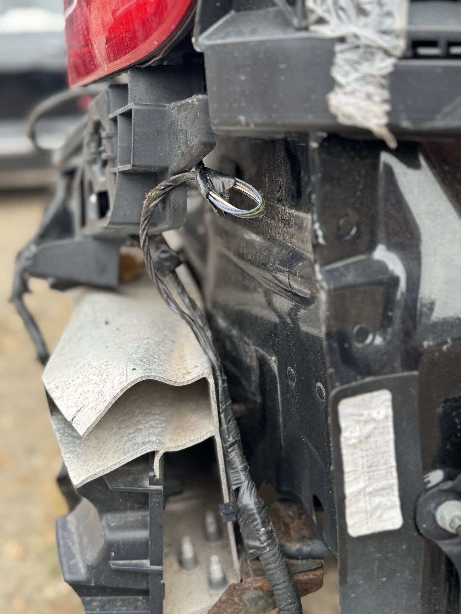

Well, the car finally arrived and I’ve had a fair bit of time with it so I can say a few things.
1. Most of the parts on the facelift models are ever so slightly different, which makes it extremely annoying because you can use parts for the older model but you’d rather not. There are however parts, like the boot (trunk) which can be sourced from any year can as long as it is for the right wheelbase vehicle. Same goes for the boot floor.
2. Sourcing said items is turning out to be slightly more challenging than I expected, with the rear bumper being the most difficult to find since I’m looking for one with the camera and sensors attached, ready to be painted. So if anyone has some leads I will be very thankful.
3. Structural parts are interchangeable (mostly). Things like the wings, rear wall, rear crash bar are same among years, so if you have a donor car with the same wheelbase, you can use it. One thing I have noticed is that the diesel boot floor is slightly adjusted to fit the converters.
As promised, I’m attaching some photos of the car at its current state and will try to update you once things get repaired. The next bit is to take the rear part of a donor car and weld it to my car. I don’t see any structural damage beyond this so I hope it doesn’t cost me an arm and a leg to get the car back on the road.
P.s I have noticed a few weird things, one being that the soft close on the car works on all doors except the drivers door and that the volume on the radio doesn’t work at all and when I turn the volume knob, it is stuck at 9 without any sound. If anyone has experienced similar symptoms, feel free to share.

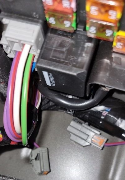

For soft close drivers door: There are an connector next to the trunk fuse box (right side of trunk) what dealer should connect before handing car to the first owner. This activate the driver door soft close function, what is disabled during factory storing and transportation. (not the 1st vehicle found where this have been left undone)
For radio volume: No idea. The amplifier sitting left sidewall of the trunk. Maybe it or cables have got some hit?

As posted above look for this in the trunk/battery area.
Look for the unhooked purple wire. Sometimes it's been pushed back where you can't see it. Standing at the back of the car with the trunk open it will be on the right hand side of the car.

Thanks guys, I will look for it once i get back to the car, from what I saw, there wasn't any major damage to the electrics of the car so it should be a relatively easy fix. (hopefully)
As per the audio, I haven't found any similar issues in the forums. Perhaps it is due to the fact that there was no good battery connected to the car, only a booster.

Update number 2: After what seems to be an eternity the car is alsmost ready. The guys at the local bodyshop have done a good job and the car is put together ALMOST completely. I just dropped off what I hoped were the last parts of the car that needed to be replaced (as well as some additions). Unfortunately, there are some more parts that I now need to find and order, before this cat gets back to tip top shape.
But before that, here is a recap of what I already purchased and what work has went into it.
As can be seen from the photos the damage was to the rear of the car, which for me it meant that I need a new bumper, a new boot, rear light break light, rear frame panel and crash bar (as well as some things on the front that we will get to later). Underneath the surface however (or in the boot) there were additional small parts that now need to be sourced. First order of business was to find a salvage car and have the rear half cut off so that it could be coupled to my car. That cost a pretty penny but I was happy that there was a salvaged car close to me, because the online marketplaces refused to ship that quarter to me. Then I purchased the rear light and the bumper, which are different for the facelift models, but are not exclusive to the LWB car. I purchased the trunk from a older LWB car that was being parted locally, but needed to do some work to it since the idiot hit a wall as he was unloading the car. In the meantime I had to buy a front bumper and front grille and badge for the car, as they were damaged as well, and had an awful experience with a Spanish seller, who had the parts on ebay and other marketplaces where he refused to make a deal and fulfil the purchase before taking the listings down for a few days and putting them back up. I had all the parts painted and worked on as everything was second hand and needed some love. I DIY repaired some of the plastic brackets that were broken at the back and had to purchase a new trunk guard that hides the latching point. There were also some other bits like a new boot floor that was slightly damaged, some hinges, some clips, some plastic trims. Which brings us to today, when I dropped off the front bumper with grille,rear break light and some clips, and was welcomed with another portion of "good" news, that we will need some more parts. One of the parts is GW93 3B484 AC (the air suspension compressor) and the other had writing PA6(GF20+GB20). These parts are non-essential as it is mostly broken plastic, the suspension works fine and the electrics seem ok (except for an issue that no sound comes out of the speakers and I can't change the volume), but now I don't know where to find only the plastic bits. I would appreciate if anyone knows how/where/if I can purchase just the plastic mounts (I don't even know what the second part is, but it seems like some sort of fuse box without the fuses). The other thing was that the front left headlight plastics were cracked, which means that I need to get new ones (I really don't want to buy a new headlight).
As per the work that has already been done, the workshop guys said that it is quite unpleasant because it is all aluminium, which means that they had to work a little harder than they expected. I am now waiting for the panel bond and the sealer for the repaired parts and then for everything to be put back before it goes for paint and finally MOT.
