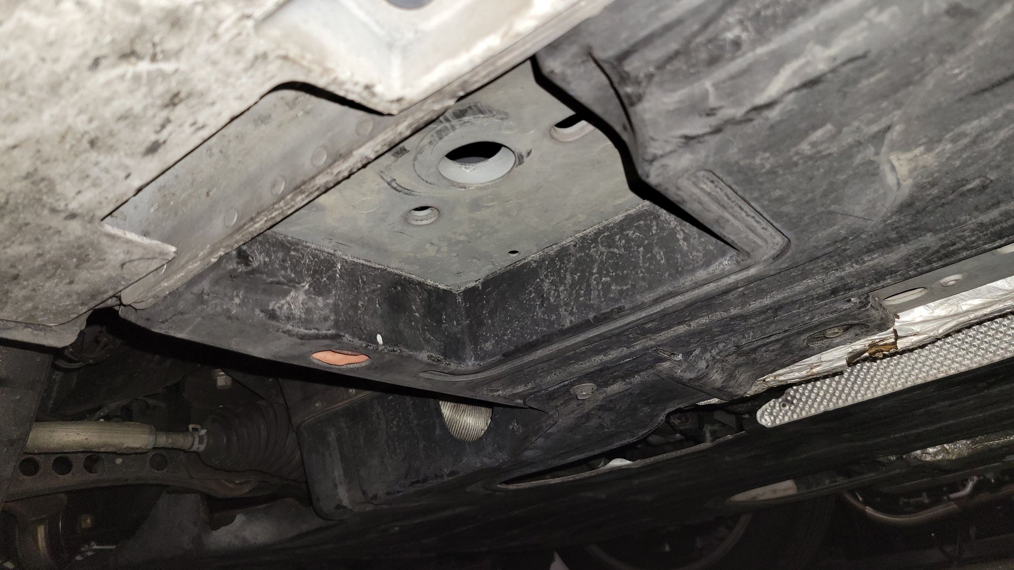

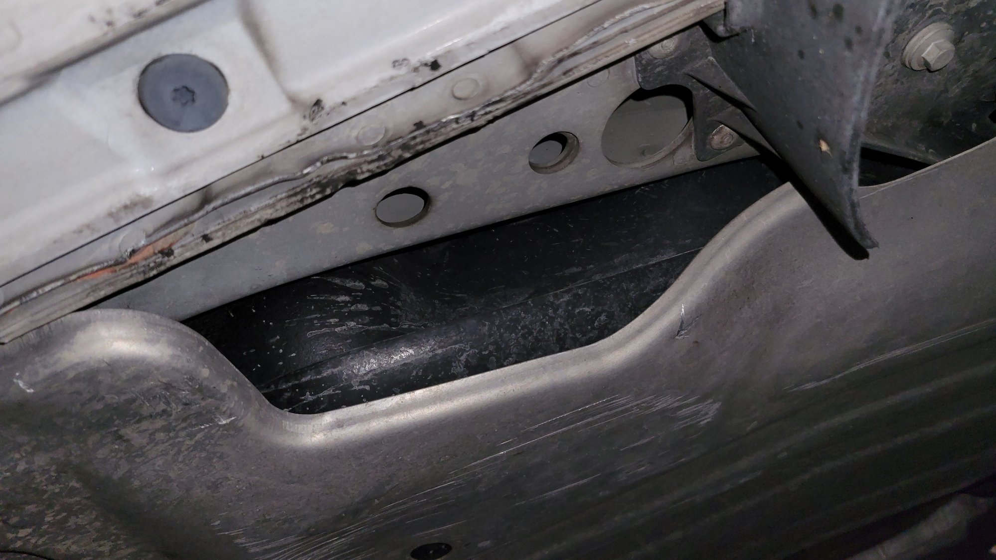

Hi guys, If we are using floor jack, is this where the jacking point is? I need to change my brakes I will be using a wood block to make sure there's no damages.
Rear
Front

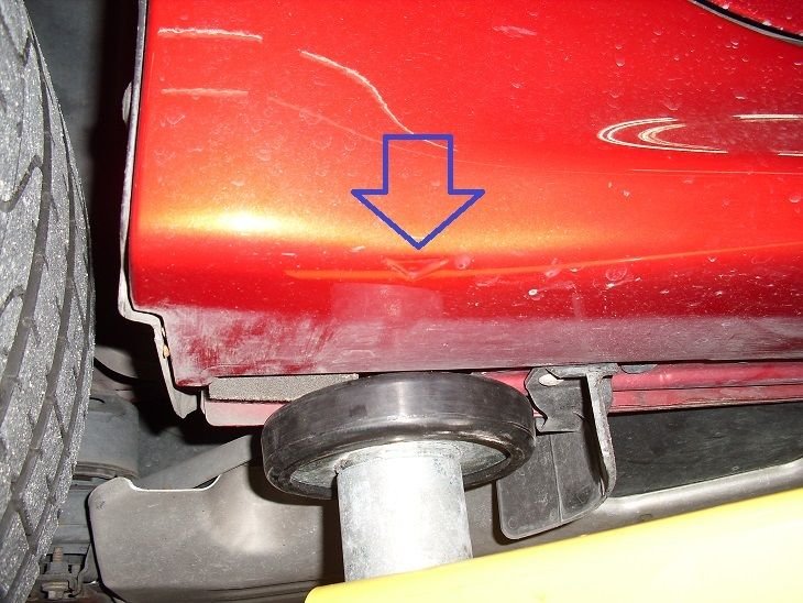

The XJ has arrows cast into the plastic rocker covers showing where the jacking points are under the car. I never knew about them until someone mentioned it.
They are hard to see if your not aware?
This is the rear one on my 2014 XJR.
