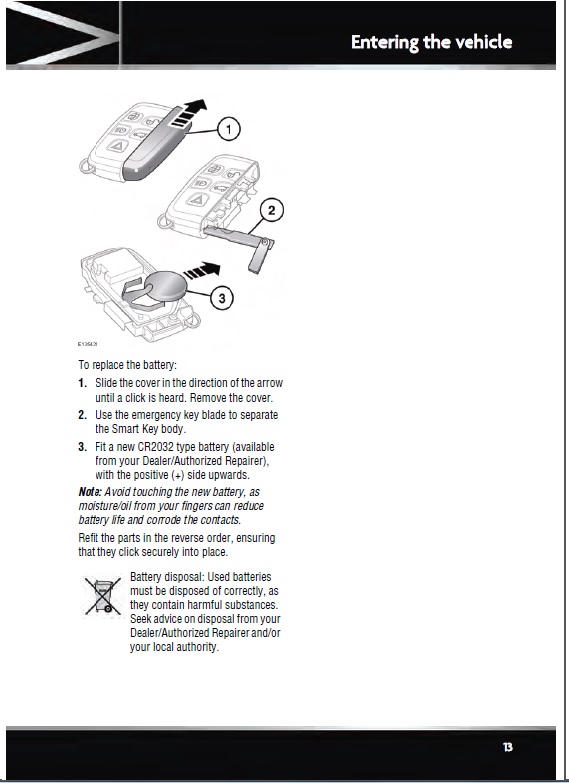

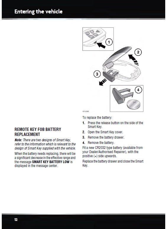

anybody know's how to change the key battery?

Although it doesn't say in the following instructions, don't leave the battery out for too long (over 30 minutes) or the Smartkey can lose its coding to the vehicle.
