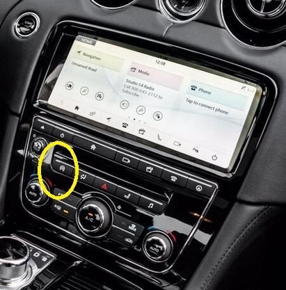

Old Feb 26, 2022 | 02:43 PM
  #35
kroache's Avatar
Joined: Jul 2020
Posts: 18
From: Caledon, Ontario
This is where it is located on my 2017. Not sure if it is dependant on model year though.
Kevin

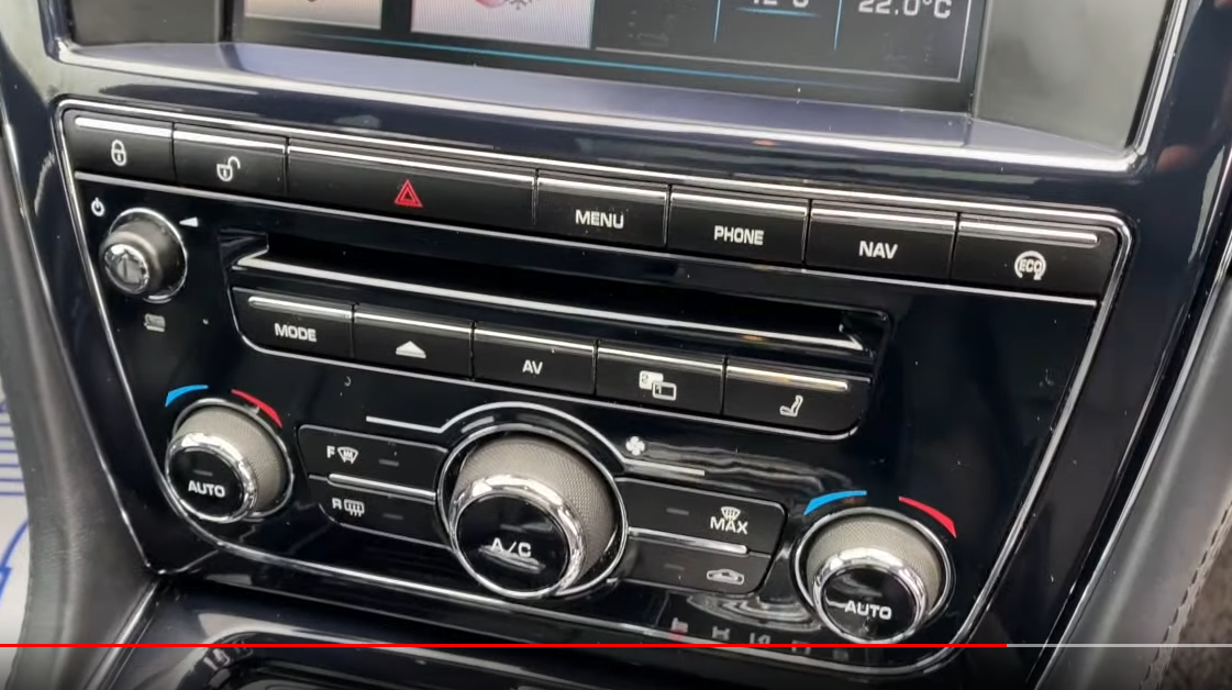

Old Feb 26, 2022 | 03:18 PM
  #36
ampiko's Avatar
Joined: Mar 2021
Posts: 83
From: Austin, TX
Yes it is different. Wonder if it is the Mode button. But Nice to see that you have manual button for a/c vent flow direction
