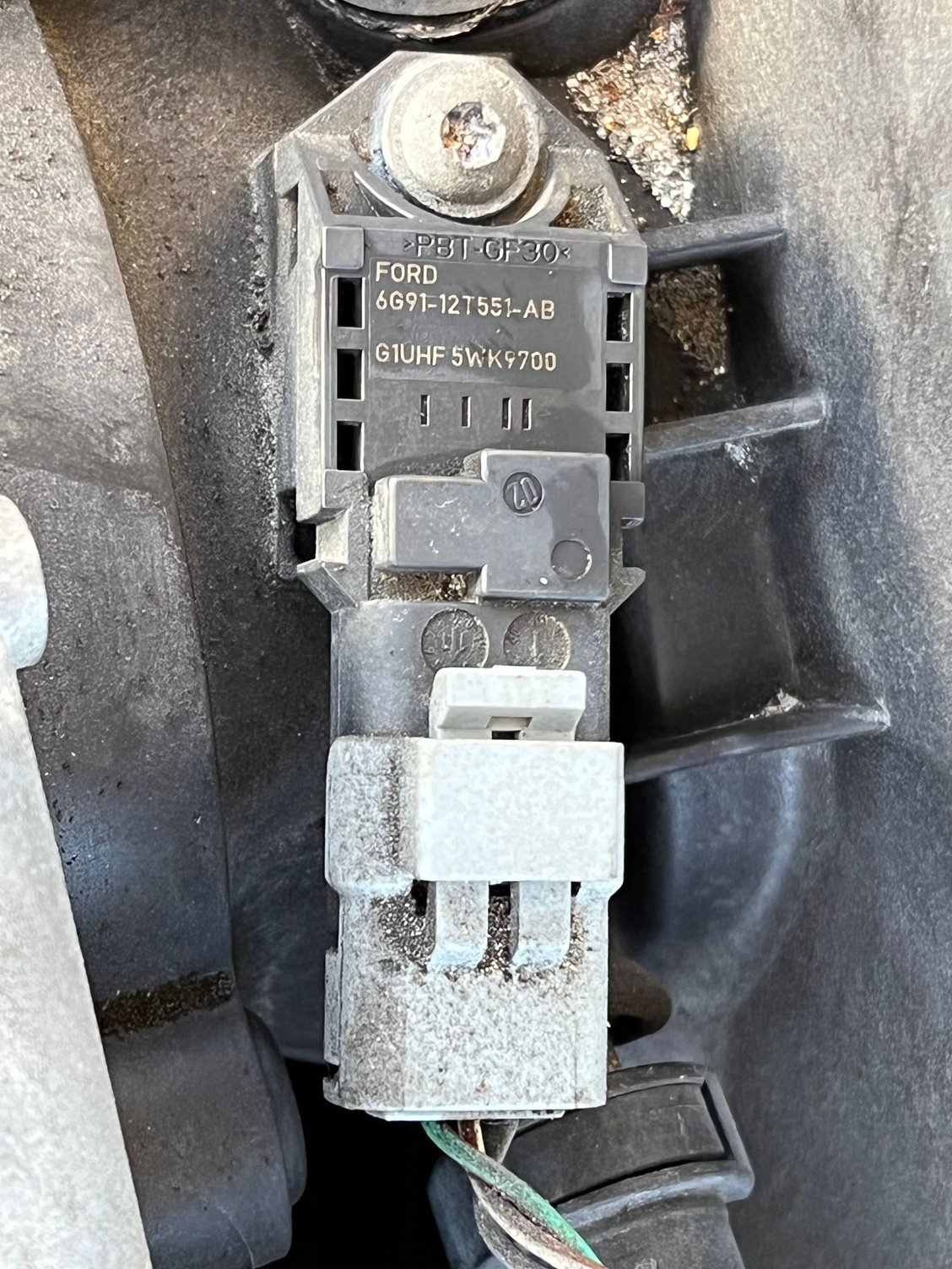

I had a P0106 on my 2012 XJ (5.0 NA) so after cleaning the TB I checked also if the MAP sensor was ok, and noticed it had a Ford marking, so I googled it and saw it's also mounted on many Ford (Diesel...) models from 2006.
Quite easier and cheaper to find than via Jaguar, at least in Europe.
Ford Reference is:
5WK9700 6G91-12T551-AB
G1UHF 5WK9700
(Jaguar reference is AJ811717 )

If I would’ve followed Amazon or Rock Auto or just about anyone else’s Parts database* (Except for Jaguar.) I would’ve got the wrong part! However, Jaguar tacks on about $100 or more depending if it’s full price or discounted for a FORD part! (It EVEN says so!)
For instance, Amazon claims it’s a Bosch OEM except theirs fastens on the side and has four blades instead of three pins which is actually what’s on the car!
*The original poster gives the Jaguar part #. That WAS @ NAPA & Advance for only SLIGHTLY CHEAPER than Jaguar! (And it’s not even the Ford part in a Jaguar labeled plastic bag for the extra $100!)
3-pin connector. 2012 XJ-L Portfolio 5.0L NA
Clearly a FORD part as there have been many since they owned Jaguar & still by TATA. 2012 XJ-L Portfolio 5.0L NA
